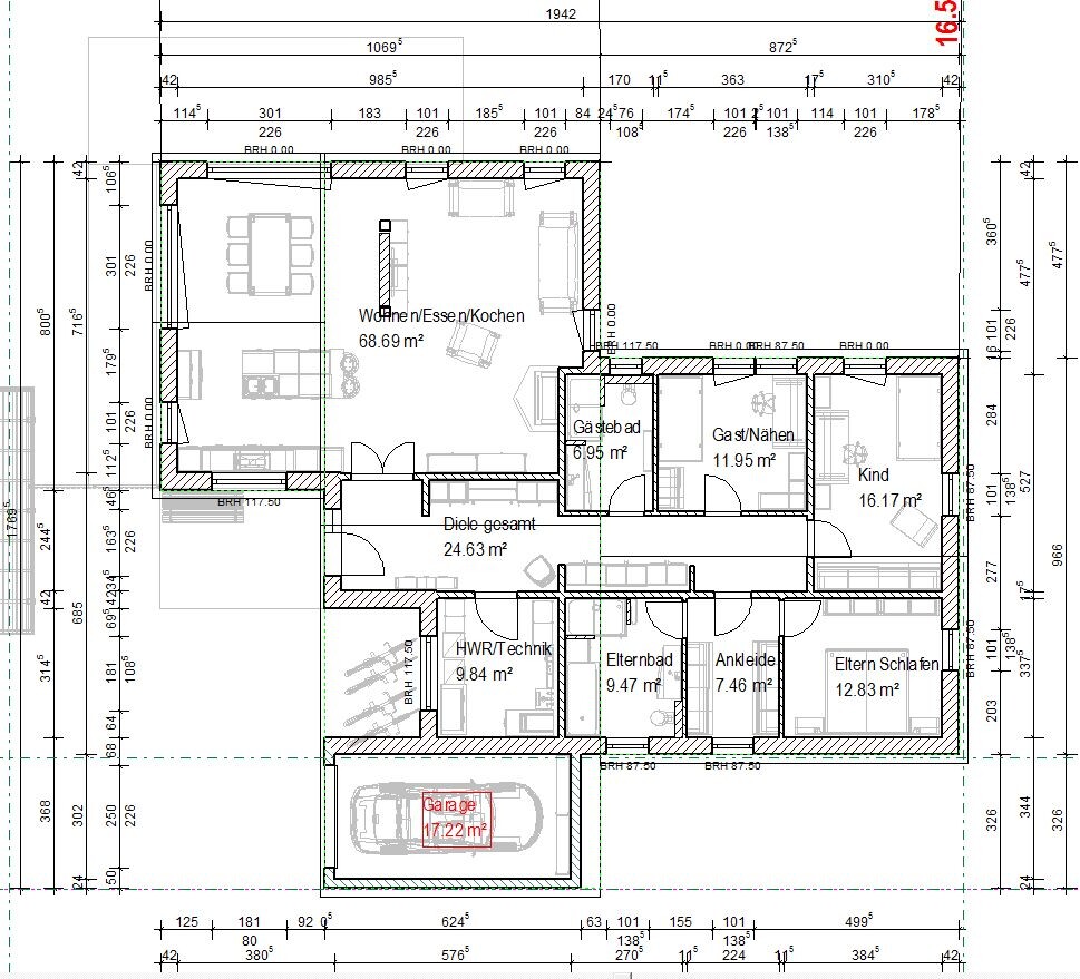

kbt09 schrieb:
@ypg .. did you also get the VA software? Our setup icons look very similar No, I didn’t. I use Arcon+, which the company no longer exists. I bought the program around 1995 for a considerable amount of money at the time and received updates annually from an architect I knew. I believe VA eventually acquired the software and now markets it. Because of this, I don’t have all the latest features. If the program were available for Apple, I would consider investing in it again, but for now, I have to make do with my husband’s Windows 7 laptop. The software also has some bugs for me: sometimes more areas remain marked in red, or the background settings are displayed incorrectly.
The furniture options in Arcon are quite basic (rustic oak and flat-pack style), but for my own house I was able to add some custom textures.
What is @sommer2017 doing?
First of all, I apologize for not responding sooner.
I definitely want to thank you again for all the effort you have put in.
Since there have been quite a few sketches in the meantime, I will try to summarize.
Our consensus, at least for now, is that every floor plan involves some compromises for us.
Even though I feel a bit guilty because you worked so hard... we see our own floor plan as the one with the least compromises.
However, we will take with us to ask whether an open gable is possible in our kitchen area to catch the morning sun from the east.
I also want to address your individual floor plans and hope that my comments will be taken purely as objective feedback (communication without facial expressions is difficult). There are things I like in all the plans, but for simplicity, I will focus briefly only on the things I like less:
Thank you for this valuable information. However, it sounds like additional costs and certain risks, so we will not consider it for now.

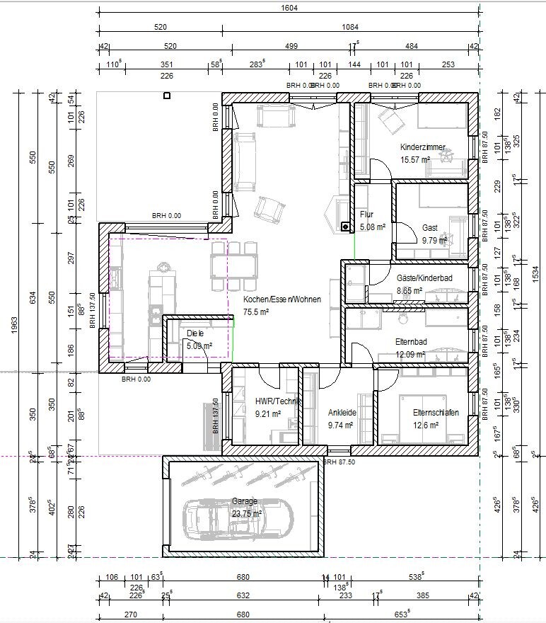

@kbt09
#75
As a consequence of the above:
Children’s room at the back of the living room (TV side)
Bedroom on the bathroom wall
Additionally:
Even though it is only two doors, there are multiple access points leading off the living room...
I am aware of that, but I wanted to first lay out all the wishes. Which ones are feasible is another matter.
@ypg
#77
Unfortunately, too convoluted (hallway, child’s room, and bathroom).
Living room is nice. A surround sound system would even be possible here.
However, the living room feels a bit too dim...
@kbt09
#78
Am I missing something? You wrote:
But when I add up the measurements, I get a hallway length of approximately 11 to 12 m from you?
We are ruling that out too because we want to save the extra costs of a convoluted exterior shell... The bay window is enough for us...
I imagine a garage narrower than 4 m (13 feet) is quite small.

Bieber0815 schrieb:
The requirement is "enhanced soundproofing"
@kbt09
#75
Additionally:
Your and your wife’s wishes should definitely be considered. But some things simply cannot be combined with others.

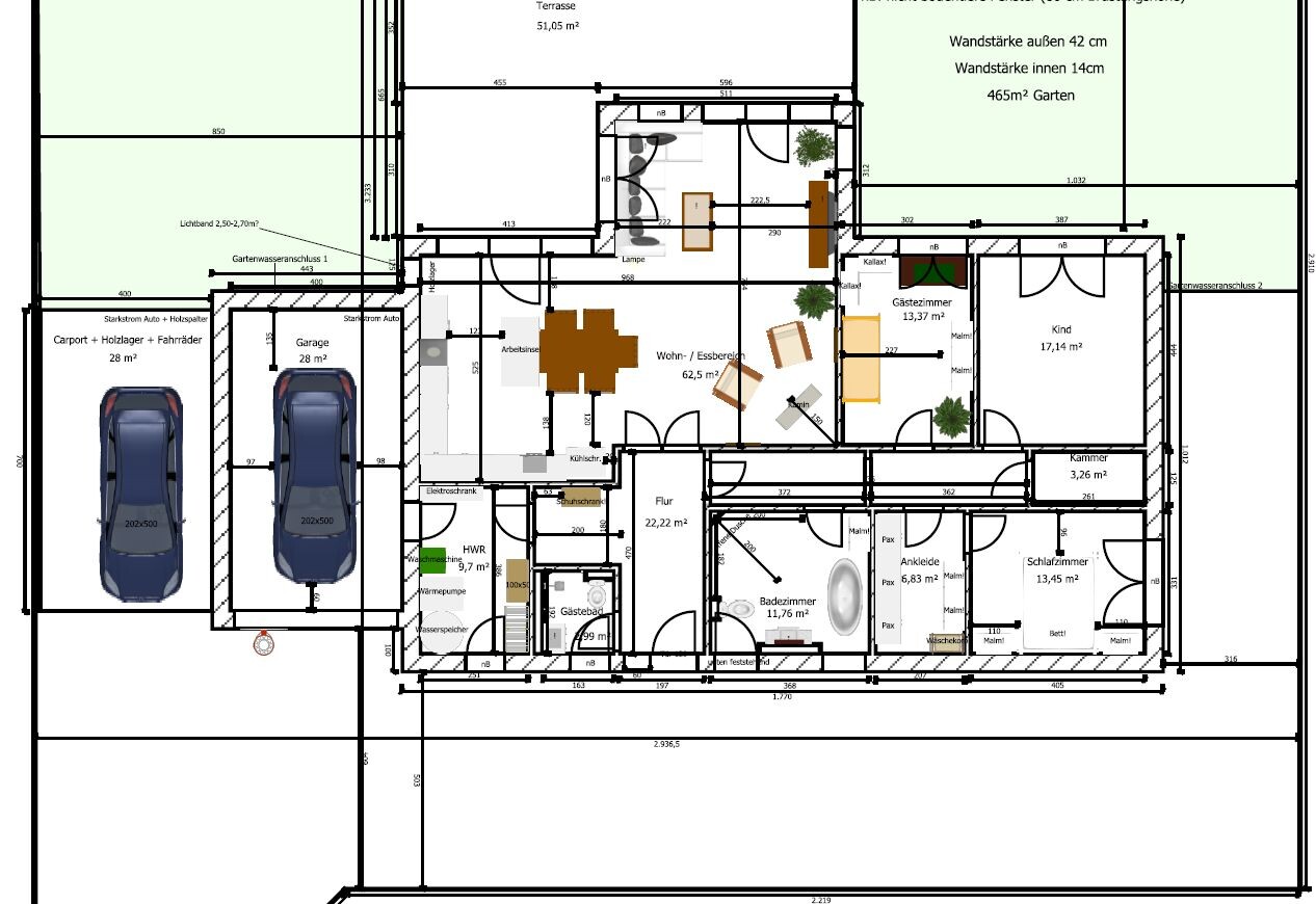

kbt09 schrieb:
The hallway length has been reduced from about 730 to 490 cm.
I think you’ve probably only experienced build quality like cheap timber-frame houses.
I respect your concerns about noise, but I believe they are greatly exaggerated.
A children’s bedroom wall next to the living room with a wardrobe in front of it – where exactly would the noise come from?
A bedroom adjacent to the bathroom of the people using the bedroom, with only a wall next to the washbasin – where would the noise come from? For example, the WC drainpipe from the upper apartments runs through my bedroom; it is well insulated and even when I know that the apartment above is being flushed, I hear absolutely NOTHING. Tested specifically.
And yes, in version 78 the hallway is shortened because I would actually describe the front area as a very functional entrance hall that contains everything you need in an entryway.
A garage with an internal width of 300 cm (10 feet) should be sufficient for one car. I have stored my bicycles efficiently outside.
And actually, the Tetris game is over now. I still find the hallway in post 29
too long, as it only functions as a corridor, and the storage room is rather impractical. And I can’t yet understand the view you are trying to achieve, or the degree of openness of the plot, at least not based on how I interpret the site plan.
… and if you compare both floor plans, each with a garage, my version has 10 key corner points, while yours has 12.
