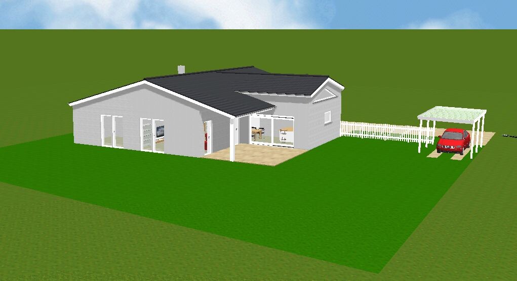

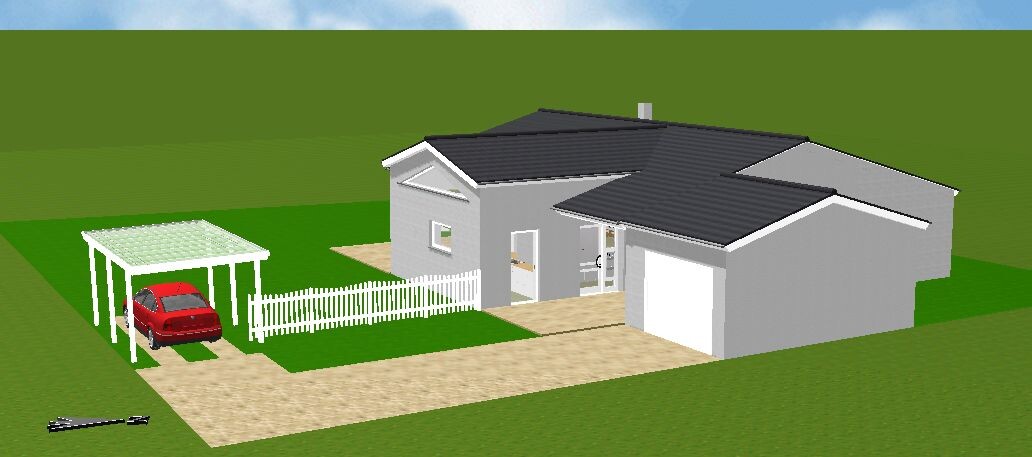

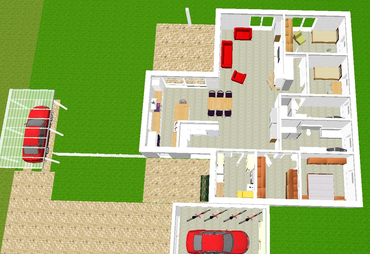

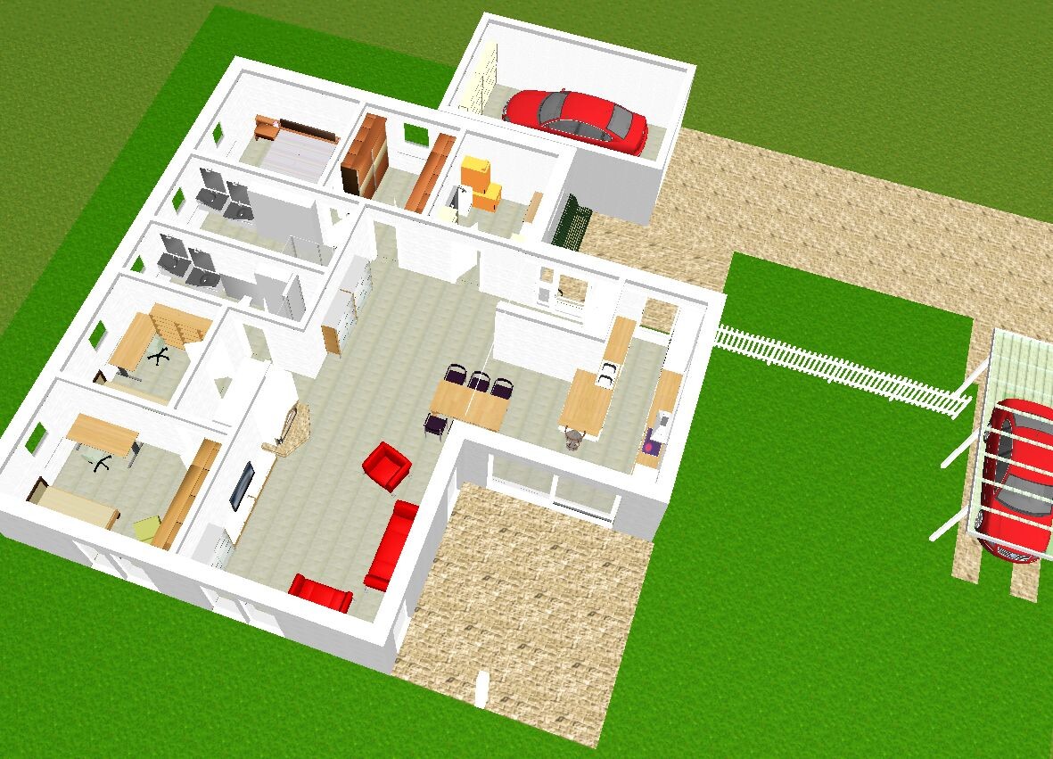

YYvonne is right... Tetris... My variant 5 resulted in a presentable plan. I was also inspired by Yvonne, and in my design, the area above the kitchen is essentially as high as the roof without an intermediate ceiling. This allows for the possibility of installing a triangular window in the upper area to capture full southern light and warmth.
I separated the garage and carport, placing the garage at the bottom of the plan next to the house. The direct access between the utility room and garage was omitted but could still be realized.
Avoiding hallways means using the outer edges of the living/dining/kitchen areas as circulation space to accommodate the desired rooms.
I also separated the parents’ and child/guest areas. The parents’ rooms are at the bottom right of the plan, the child/guest rooms at the top right.
In the hallway near the child/guest area, there is space for storage, which could also be used for a vacuum cleaner, mop, etc.
By chance, the total area ended up being exactly 163 sqm (1756 sq ft).

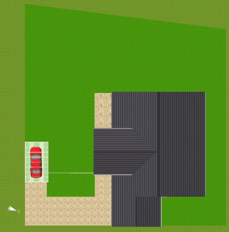

Yes, I liked the idea. I wanted to get as much east, south, and west sunlight into the room as possible.
Distance from house edge to upper property line:
right house edge approximately 990 cm (390 inches)
left house edge before the terrace begins approximately 1130 cm (445 inches)
left upper corner of the terrace approximately 1190 cm (470 inches)
Garage at the bottom of the plan roughly 430 cm (170 inches). If the garage is positioned more to the left, the house could be moved about 120 cm (47 inches) further down on the plan.
