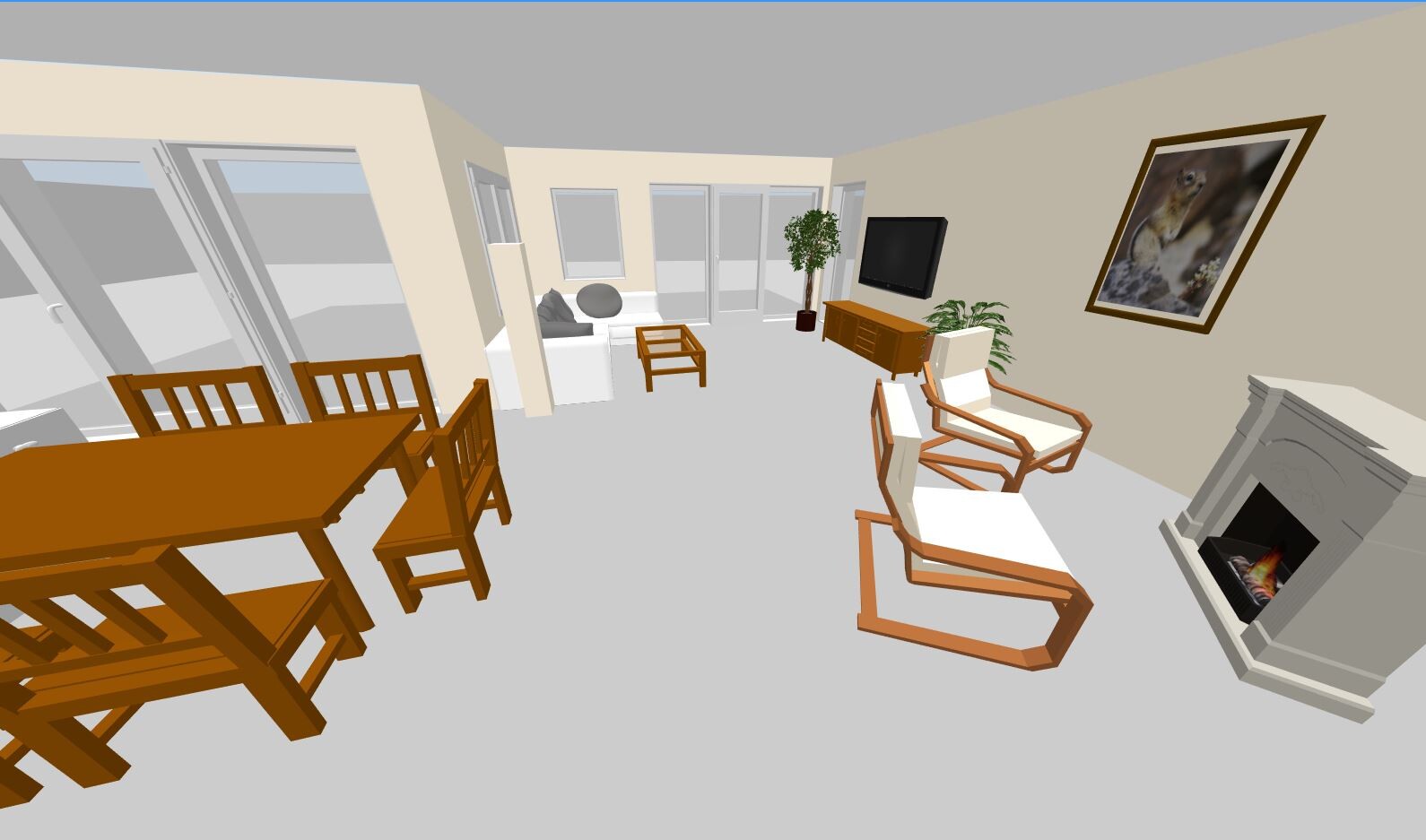

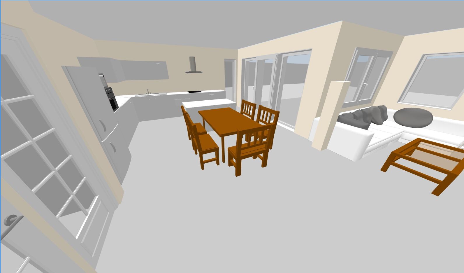

The hallway is very dark, the walk-in closet is narrow, and this corner in the kitchen with the light strip seems unused (?). The shape of the living room feels more like a hall – not well divided somehow... I will take a closer look again tomorrow.
sommer201730 Jun 2016 00:23
We are actually a bit concerned that it might feel like a hall.
So far, we have been relying on the 3D rendering, and furnished, it doesn’t seem too large at first...

Open kitchen with wooden dining table, kitchen unit, sofa, and large windows.
Living room with dining table and benches on the left, sofa, fireplace, TV, and plants, picture frame with bird image.
