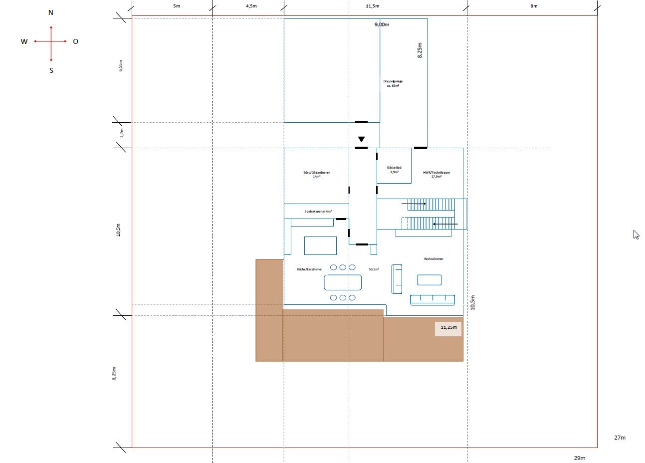

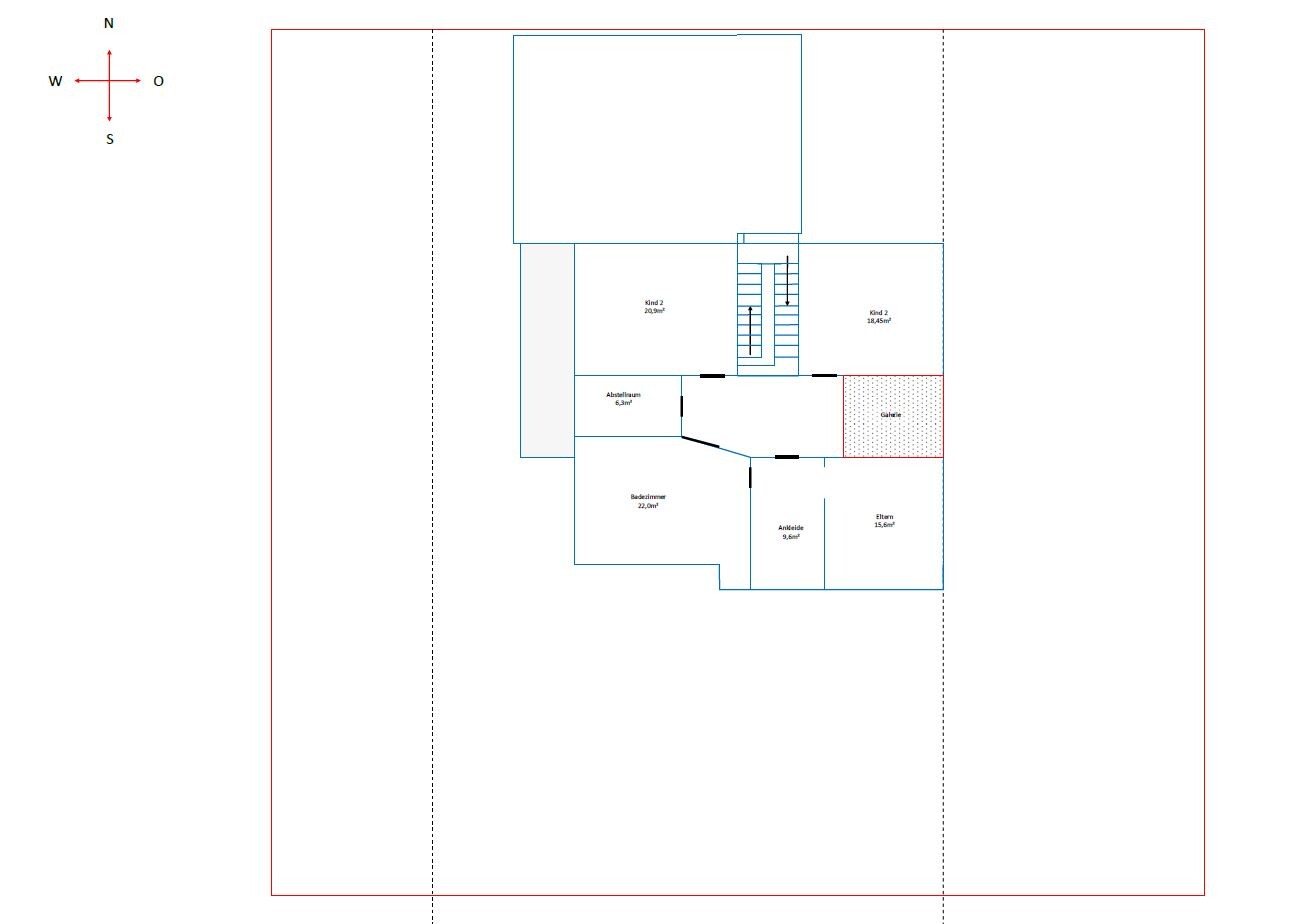

Option 1:
Floor plan of a house: kitchen/dining, living room, office, bathroom, utility room, stairs, terrace
Floor plan of a house with two children’s rooms, master bedroom, dressing room, storage room, and stairs.
for a larger view as PDF
Option 1.pdf
The ground floor shows the entrance block described by @ypg between the garage and the front door on the north side. I personally really like this design, but due to the layout it would take away 2 meters (6.5 feet) in the south. The stairs are positioned to take advantage of the nice view to the east (possibly also serving as a gallery replacement with very tall, continuous windows / window front). The kitchen is located directly to the west, including a pantry which I personally do not want to give up. The dining and living areas can be flooded with natural light from large floor-to-ceiling windows facing south, enhancing the atmosphere.
The upper floor is fairly straightforward, laid out with straight lines and no unnecessary frills. I personally don’t think a children’s bathroom with a shower is necessary. But as with the pantry on the ground floor, opinions differ.

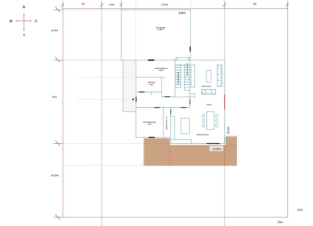

Option 2:
Floor plan of a house with living room, kitchen, office, guest bathroom, utility room, garage, balcony.
Floor plan of a house: stairwell, storage room, bathroom, dressing room, master and children’s bedrooms.
Option 2.pdf
The ground floor shows the garage attached directly to the house. In bad weather, you can walk through the utility/technical room into the house without getting wet. The front door faces west, towards the street. A roof extension or awning provides some protection right at the front door. The stairs are positioned to the north and have a long, narrow window that brings plenty of light into the stairwell (garage with a flat roof or low-pitched hipped roof, e.g. 25 degrees). Walking through the hallway to the living room, you are greeted by a large floor-to-ceiling window wall stretching all the way up to the ceiling towards the east (nice view). (See example below of what I envision.) The office/workroom has an exit to the south-facing terrace. Kitchen, living, and dining areas are arranged in a small L-shape. Between the living and dining areas, there is a gallery opening upwards. The terrace is accessible from the dining area through a large sliding window wall.
The upper floor is also quite straightforward. The rooms are a bit smaller than in Option 1 because the gallery with the large window front on the east enhances the view further.
I hope these new drafts present better versions of the designs, which we believe show the two best possible options.

Jochen10410 Aug 2016 15:36
I prefer option 1 in terms of orientation compared to option 2.
On the upper floor, I would position the children’s bedrooms on the lower side of the plan (south) and move the other rooms upwards. You don’t need 30m² (323 ft²) for the bedroom and dressing area, nor 22m² (237 ft²) for the bathroom.
The staircase is planned very generously (too large), but that will be adjusted in the detailed design stage.
A wardrobe could also be added below the guest toilet. Depending on how the entrance area is covered, it could be quite dark there and in the hallway. Option 2 has advantages in this regard.
The pantry is very narrow in both options.

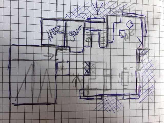

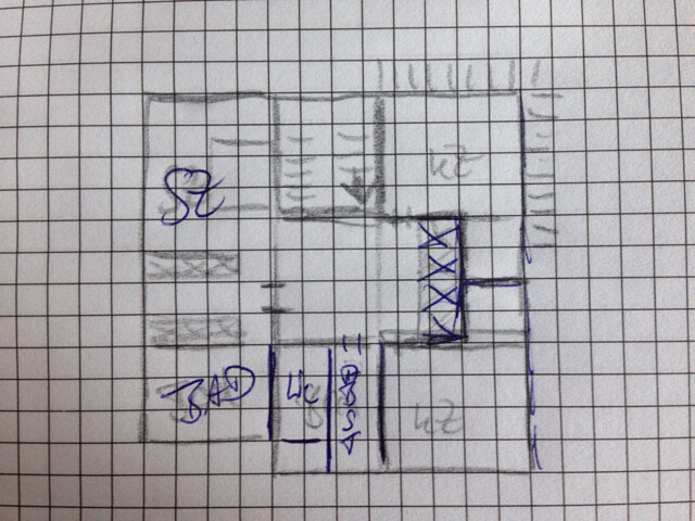

10 Aug 2016 18:58
Everything a bit bigger and more expensive?
Here I sketched it roughly with a blunt pencil...
Hand-drawn floor plan sketch on graph paper showing room layout
Hand-drawn floor plan sketch of a house with room divisions
