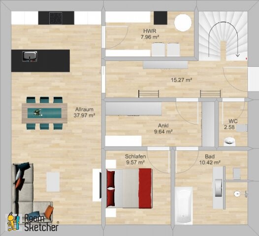

we are in the process of building a single-family house with a basement suitable for living. This is the design we have come up with. I would like to hear from you if you see any possibilities for improvements.
On the ground floor, there is a side entrance door on the right. The carport will be located there.
In the basement living area, the children's rooms face south. From there, it should be possible to access the terrace and the garden.
I look forward to your tips and suggestions!
Ground floor plan: open living and dining area, kitchen, bathroom, hallway, and two rooms.

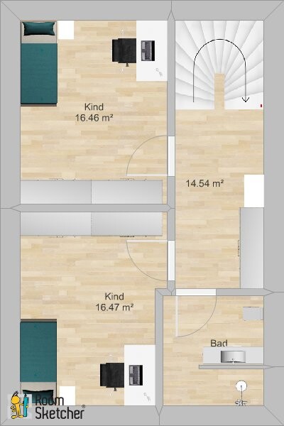

Apartment floor plan: kitchen, living room, hallway, and bedrooms with dimensions.

j.bautsch schrieb:
I would place the garage at the top of the plan
Regarding the windows and kitchen layout, the island could be equipped with both a cooktop and a sink. However, neither should be too large to ensure there is still enough countertop space between them (for example, a 60cm (24 inch) cooktop and a simple 60cm (24 inch) sink without a drainer, which is usually not necessary).
This way, you get natural light from the side, and the back side of the island could either be fully fitted with tall cabinets or provide a niche for appliances like a coffee machine and others.

j.bautsch schrieb:
Here is a suggestion from me (I’m a fan of simple building shapes). If interested, I can provide more dimensions. For now, without windows.
Ground floor:
Exterior dimensions 11.50 m x 10.50 m (38 ft x 34 ft)
93.41 m² (1005 sq ft)
Staircase 2.20 m x 2.20 m (7 ft 3 in x 7 ft 3 in) (according to my stair calculator, this should work)
Upper floor: 7.00 m x 10.50 m (23 ft x 34 ft)
54.01 m² (581 sq ft)
No storage room, but enough storage space in the hallway instead
Total area 147.42 m² (1586 sq ft)
Thank you for your work, but I’m missing storage space in the form of a dedicated room. I would never store things like vacuum cleaners in the hallway. Also, 14 m² (150 sq ft) of hallway upstairs is simply too much!
