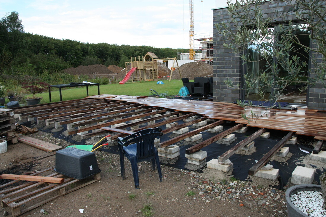

nordanney8 Apr 2016 11:39Skip all the unnecessary hassle.
1. Excavate only at the points where the substructure will rest
2. Fill and compact gravel at these spots
3. Fill freezer bags with lean concrete, place them on the prepared spots, and position the substructure on top
Cover the remaining lawn with a geotextile fabric.
That’s all there is to it. I’ve built four terraces this way myself and have also heard of similar methods from wooden deck builders.

nordanney8 Apr 2016 11:42That does indeed sound simpler. How deep did you excavate at the specific points and fill with gravel?
In your picture, there are also "small concrete mounds" and paving stones visible on the geotextile fabric. Is that the height adjustment you mentioned?
Thanks in advance! That would save a lot of costs and work.
nordanney8 Apr 2016 12:58I didn’t excavate anything. The base underneath the geotextile fabric is compacted gravel (provided by the civil engineer). The fabric was laid directly on top of that.
I spread a bit of concrete onto the fabric so the paving stones (which are used for height adjustment) could be positioned properly. On top of that, I placed the small bags of concrete that support my wooden substructure.
Since the wood (Bongossi) should not be in direct contact with water, it rests on small pads to keep it dry. You don’t really have this issue with WPC.
Addendum/Alternative: I’m also planning to build a terrace around our pool. However, this will be slightly different since there is currently a lawn area there and I don’t want to do any digging.
1. Rent a post hole digger.
2. Drill holes about 35–40 cm (14–16 inches) deep, reaching the fill soil in my case, then insert 100 mm (4 inch) rigid sewer pipes (KG pipes) into the holes.
3. Level the height of the pipes.
4. Fill the pipes with gravel or, alternatively, concrete.
This way, you create stable points on which the substructure can rest.
