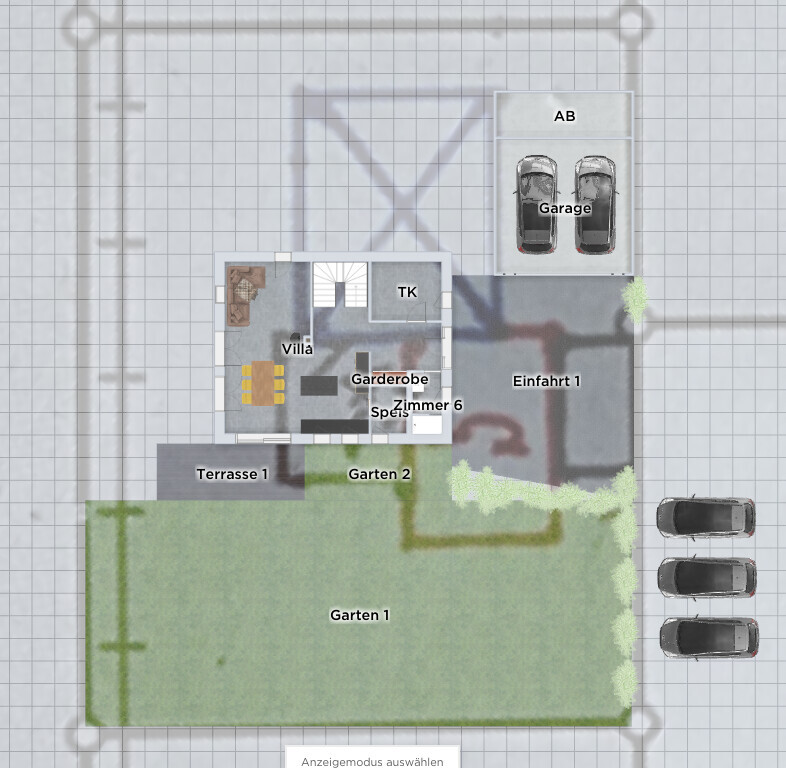

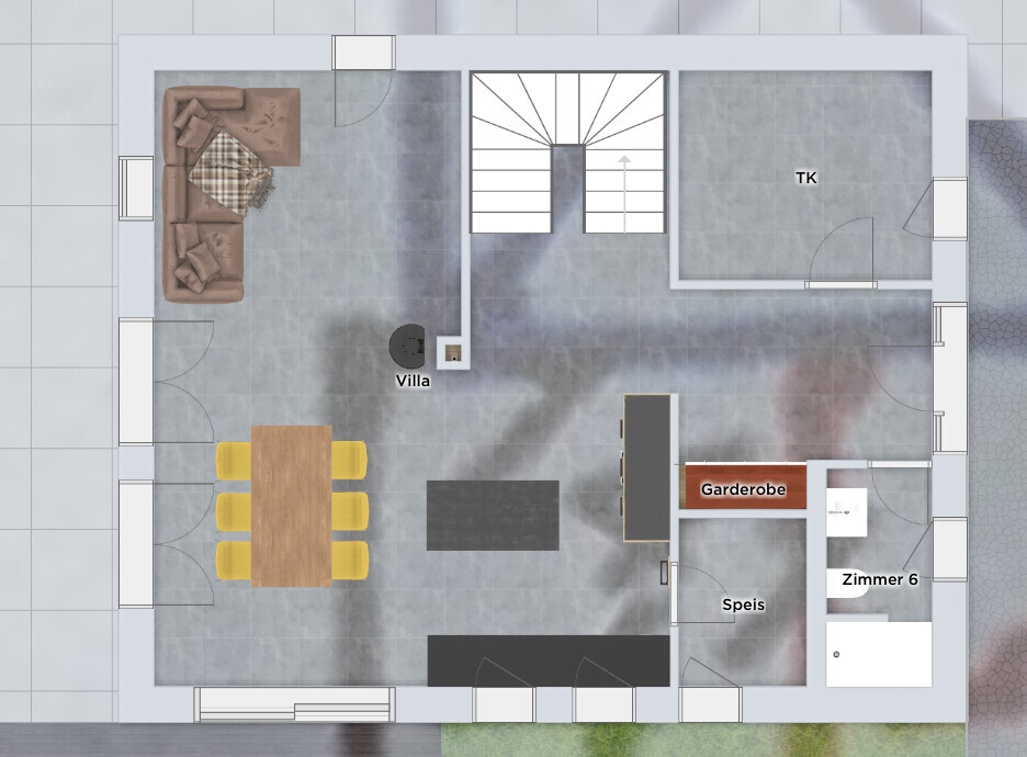

Here are the floor plans (I adjusted the north arrow) and on the ground floor I marked a stove with the orange circle, which should also fit on the upper floor. https://www.instagram.com/11antgmxde/
icarus123 schrieb:
Thanks for the feedback. Actually, I really started with the upper floor and then only later the ground floor... that's why I have the chimney issue again.
But I’m glad I was already able to implement some of your suggestions. I would leave out the short bedroom section. It interrupts a potential wardrobe/bed wall and causes the hallway upstairs to become dark.

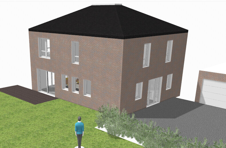

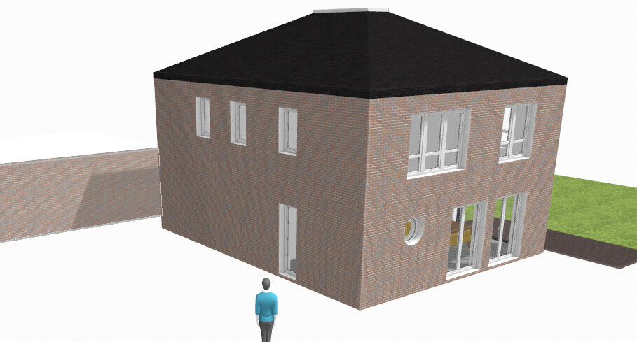

I experimented a bit with the garage placement and the villa’s appearance. Unfortunately, the grass seed didn’t quite make it all the way to the north 😉
The office door is transparent. The windows could of course be a bit larger; I based their size on the original floor plan (due to budget constraints). The bathroom probably needs some additional refinement as well 🙂
I
icarus1239 Mar 2023 14:42ypg schrieb:
I played around a bit with the garage placement and the villa-style look. Unfortunately, the lawn seed didn’t quite make it all the way to the north 😉
The office door is transparent. The windows could of course be a bit larger, but I stuck to the original floor plan dimensions (due to budget). The bathroom probably needs some refinement as well 🙂 Thank you for the effort, but the design exceeds our building limits. Also, the bend and the bend protection strip must remain free of any structures. It definitely looks great, but we’re only allowed 12m (39 feet) in depth…
