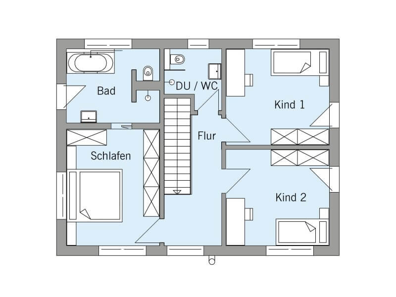

icarus1239 Mar 2023 21:14K a t j a schrieb:
Oh, well, Baufritz also has upper floors:
[ATTACH alt="Baufritz_Einfamilienhaus_Grundriss_DG.jpg"]78850[/ATTACH]
This one includes a master bathroom and a kids’ bathroom. For an office, the kids would probably have to be on the north side. That wouldn’t be ideal. Hmm, need to think about it some more. Yes, I don’t think that really suits us. We don’t need anything quite so luxurious with a master bathroom and kids’ bathroom, plus that’s going to affect the cost anyway.
