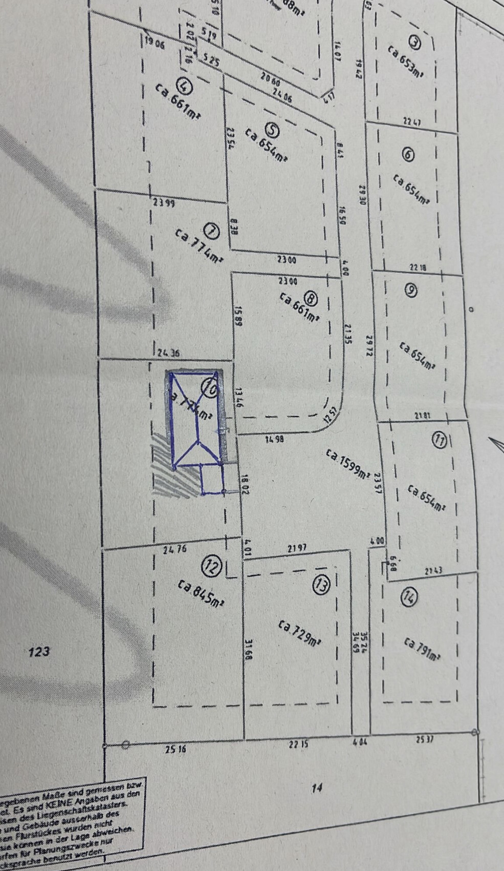

But the floor plan shows the garage on the other side, and I assume the orange marked area is supposed to represent the garage.
What is behind the garage on the site plan (double garage... does it fit the driveway?)... a terrace?
[ATTACH alt="1678299617554.png"]78805[/ATTACH] [ATTACH alt="1678299753724.png"]78807[/ATTACH]
Are there any measurements for the plot? According to the first site plan uploaded, there seems to be a parking space planned as well.

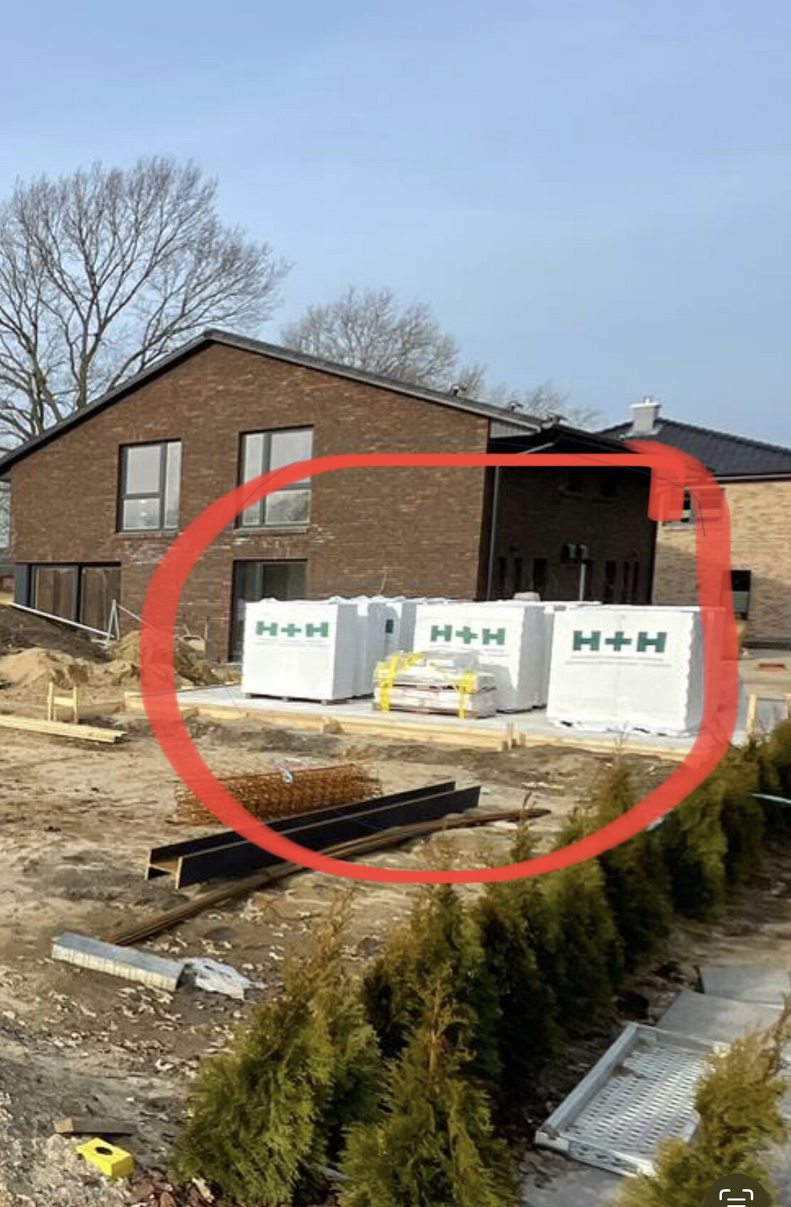

[ATTACH alt="1678300013013.png"]78808[/ATTACH] The orange area shows the effective range of the air-to-water heat pump.
The site plan initially had the first design roughly overlaid, but the measurements can be seen.

icarus1238 Mar 2023 19:35kbt09 schrieb:
But the house floor plan shows the garage on the other side, and I assume the orange marked area is meant to represent the garage.
What is behind the garage on the site plan (double garage… does it fit the driveway?)… terrace?
Are there any measurements for the plot? According to the first uploaded site plan, there seems to be a parking space planned as well.
The parking spaces in the above B plan must definitely remain exactly as shown according to the municipality.
The terrace is planned behind the garage marked in red, basically in the angle between the house and the garage.

icarus1238 Mar 2023 19:50kbt09 schrieb:
Where is the building boundary line at the back? How many meters is the building envelope?
As far as I can see, the house can be up to 10 m (33 feet) wide at the double garage driveway. The building envelope is 12 m (39 feet) deep, with a 3 m (10 feet) setback in front and on the sides from the road and neighboring property.
We assumed the house width as 13.46 m (44 feet) up to the driveway, then subtracting the 3 m (10 feet) setback from the neighbor, which leaves 10.46 m (34 feet) for the house. We then rounded to 10.50 m (34.5 feet) for the house width.

And the heat pump is supposed to be placed right on the property line next to the neighbor, who is unlikely to have a garage there but rather has their southeast side oriented that way?Actually, that is exactly where their garage is located, or is currently being built. (boundary development)
