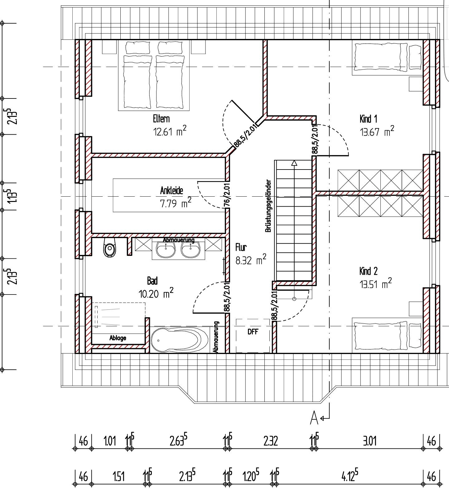

Hausbau Re16 Mar 2016 13:59Regarding the shower, I just want to mention that it will have a partition wall high enough to sit on. I also don’t understand why the showerhead being under the sloped ceiling should be a problem. The area where it will be installed should easily allow a height of 2.20 meters (7 feet 3 inches).
Well, it’s mainly about the path to the kitchen, the children’s rooms, and so on.
The route to the kitchen in the morning... and almost all of it as well, to get every schoolchild out the door. You can’t even quickly call upstairs from the kitchen to say that breakfast is finally ready, etc.
The sofa faces away from the window but is always nicely oriented towards the hallway.

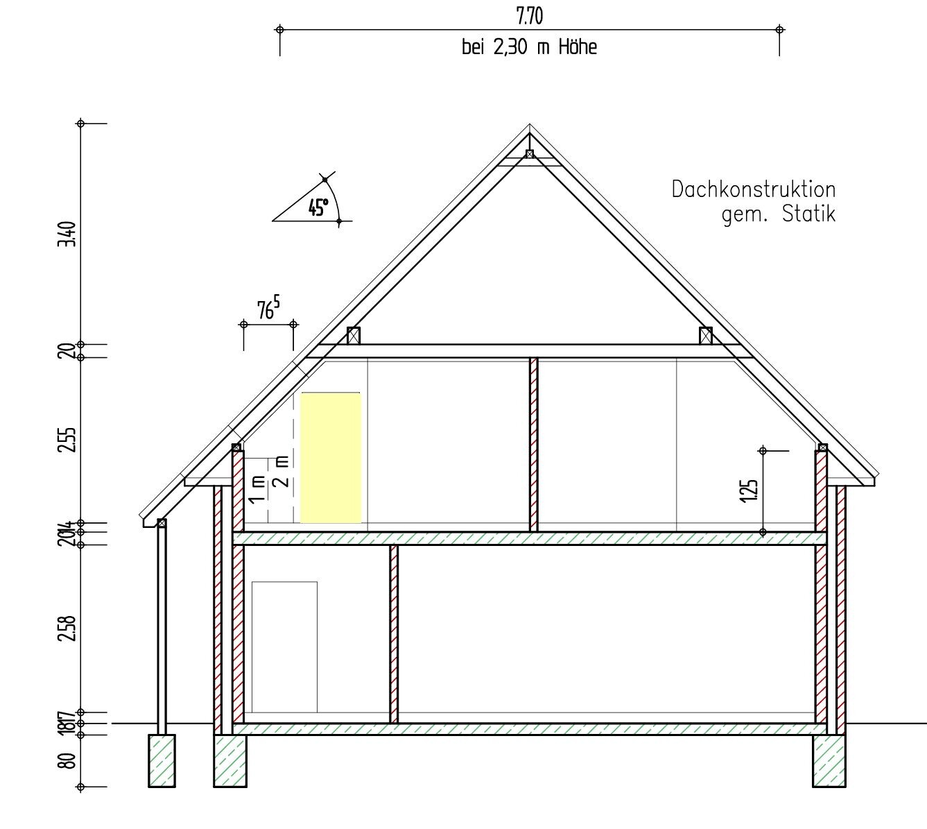

For example, Children’s Room 2 from your cross-section drawing:
Do you see what I mean? Usually, you don’t open a door fully and walk straight through, but rather at a slight angle... and that leads you to the sloping roof here. The yellow part is the door to the children’s room.
Upper floor... just the stair landing situation alone:
Rather narrow and dark.

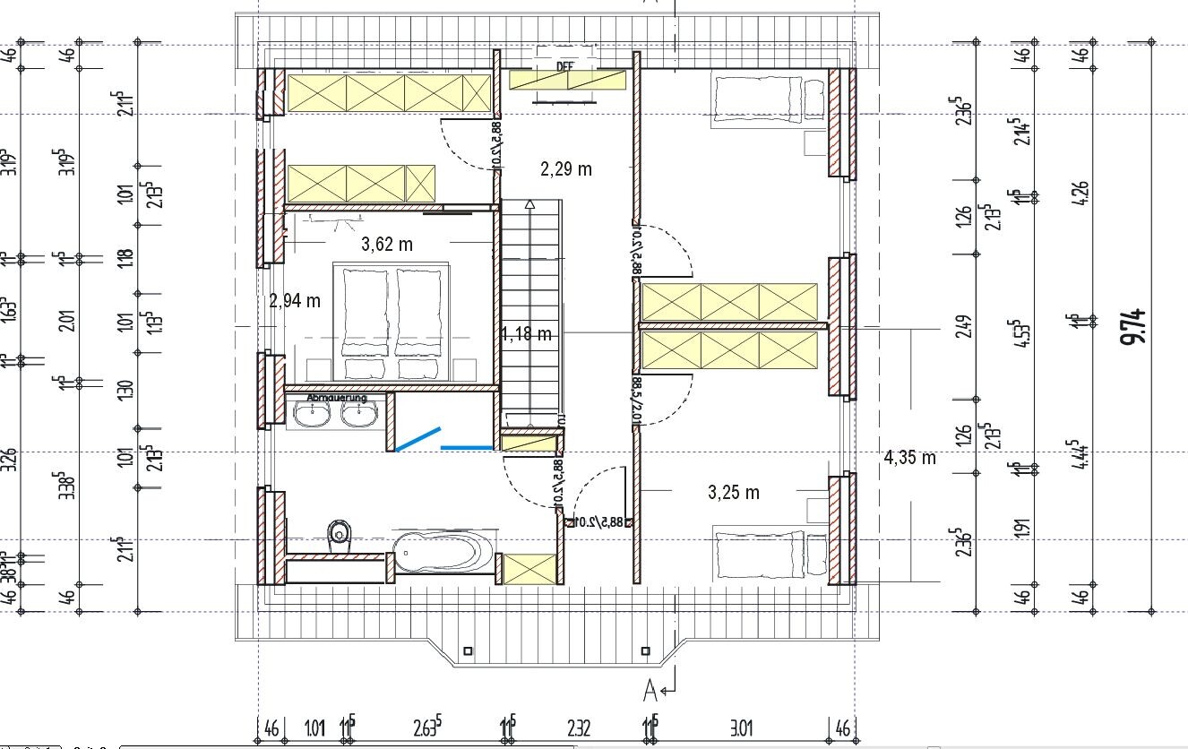

In contrast, here:
More open space, with the south-facing window. At the bottom of the plan, to the north, is the storage area for the upright vacuum cleaner and mop.
Bathroom storage for towels, toilet paper, etc., and a really large shower without a sloping roof.
Additional storage in the corridor, for example, bedding in the dressers under the roof window. Okay, the dressing area has somewhat less storage space under the sloping roof at the top of the plan than in your previous version, but it offers additional practically distributed storage.
In contrast, here:
Also, your upper floor covers two riser steps of the staircase coming from below. Unfortunately, this is not shown in the cross-section but could restrict headroom on the stairs, especially when going down.
Hausbau Re16 Mar 2016 14:27Your design isn’t bad, but I have a problem with our TV units, which together take up 3.26 meters (10 feet 8 inches) of space and simply won’t fit anywhere else.
In the bathroom, I don’t like that the vanity is tucked into the corner at the back, leaving no room for cabinets next to it. But the main thing seems to be a huge shower, which looks nice but we could manage with less.
I agree with you about the south-facing double casement window—it would look better, but it would take up space in the children’s room, which isn’t very large anyway. Also, it would reduce space in the bedroom for a dresser for bedding and other essentials we need.
We need 5 meters (16 feet 5 inches) of space in the walk-in closet with a ceiling height of 2.34 meters (7 feet 8 inches). That means the other walk-in closet would be too small, even though I liked the way it was planned.
Regarding the raised floor situation, I can only say that the floor plan with the straight staircase we insisted on doesn’t allow for more space. Since we don’t want to reduce the room sizes just to gain more hallway space, we are foregoing that window.
I need to discuss the step at the entrance with my architect to see what he suggests.
In the end, you have to decide for yourself, especially since you or you all will be the ones living there. But just the access situation to the children’s rooms alone would make me definitely not want the floor plan as it is!
Comparison (Estimated values)
Floor area (not living area) of the children’s rooms in your design is about 14.8m² (160 sq ft).
In kbt09's design, about 13.3m² (143 sq ft).
That’s about 1.5m² (16 sq ft) less, which is quite significant.
However, if you look at the plans more closely, in your design, nearly exactly these 1.5m² are already used up just for the entrance to the room — to even get inside.
So, 3m² (32 sq ft) in total, which in kbt09’s design can be used more efficiently — for example, to make the hallway brighter, or for other purposes.
I understand your situation, where you eventually get stuck without even realizing it. This has happened to everyone in this forum at some point. But the skill is, when you’re already given such a good starting point by someone like kbt09 (respect for that!), to at least try to question your floor plan objectively.
I’ve been in the same position, and we have been planning non-stop for six months now. But I am really glad that we didn’t just go with the first solutions we found!
