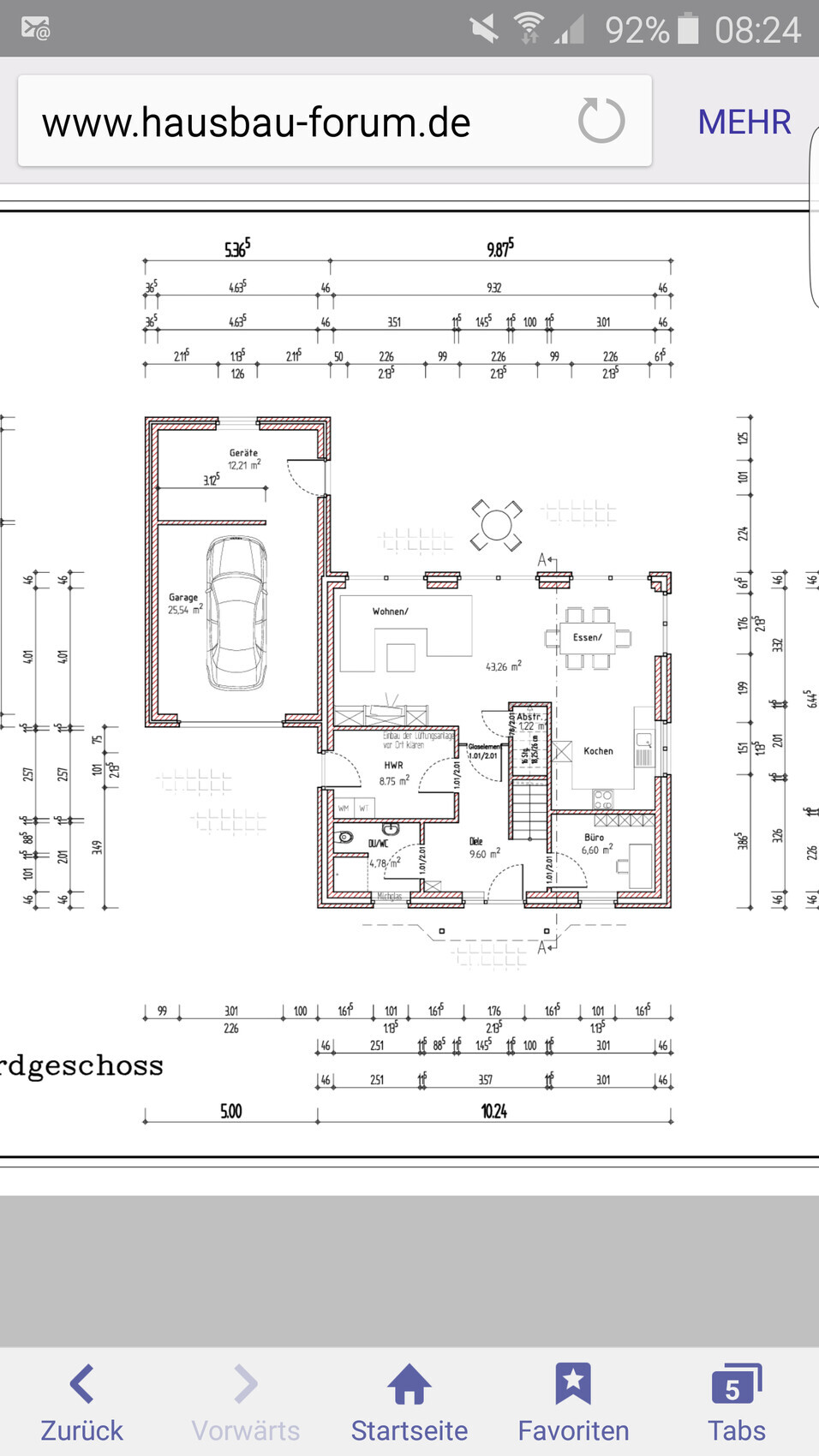

Hausbau Re23 Mar 2016 08:25The floor plan linked by @RobsonMKK comes from you, @Hausbau Re.
Regarding the floor plan:
I don’t see a real possibility of moving completely to the ground floor in old age—unless the living area is converted into a sleeping area. In general, the bathroom as it is now is not suitable for accessibility—see the toilet recess. At minimum, the bathroom door on the ground floor should open outwards.

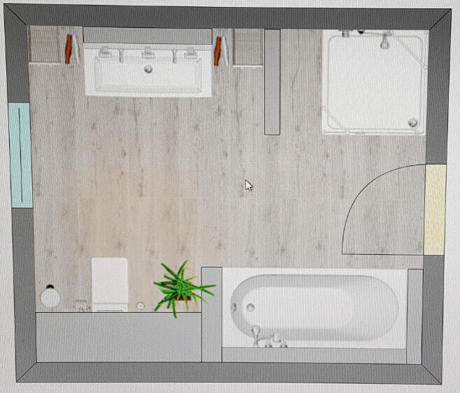

Hausbau Re30 Apr 2016 21:01Hello, I have been considering the advice from kbt 09 and others. At the same time, I spoke with tilers and painters, and they also advised against having a shower under the sloped ceiling.
So, I created a new bathroom plan and wanted to ask if there is anything that could still be improved. The shower shown in the picture is 1m x 1m (3.3 ft x 3.3 ft) because the online catalog did not offer anything larger. However, we plan to enlarge it to 90cm x 120cm (35 inches x 47 inches) or 90cm x 140cm (35 inches x 55 inches).
