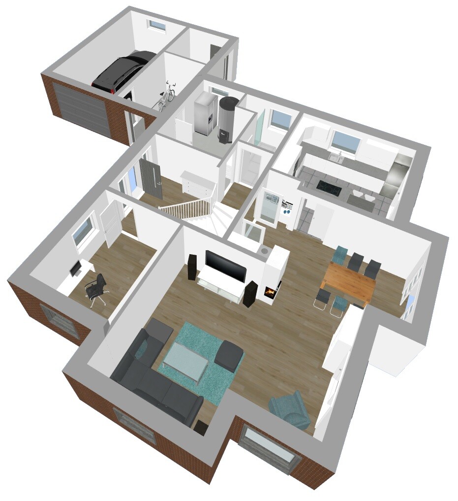

My wife and I are expecting a child and are planning to build our own house soon. We have visited two large model home parks, looked through many brochures, and gathered inspiration online.
We want to build a single-family house (to KfW 55 energy standard) with a gable roof and a bay window and are currently in discussions with several builders. We have presented them with our designs, but feedback has been limited, so we’re unsure whether we should also consult an architect.
Therefore, we would like to share our design here and get your opinions on whether the floor plan makes sense or if we might have overlooked something or made any mistakes.
Thank you in advance for your feedback and suggestions!

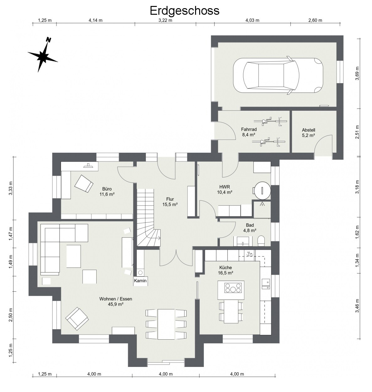

Ground floor: Spacious and bright living/dining area, kitchen (not open), office, utility/technical room

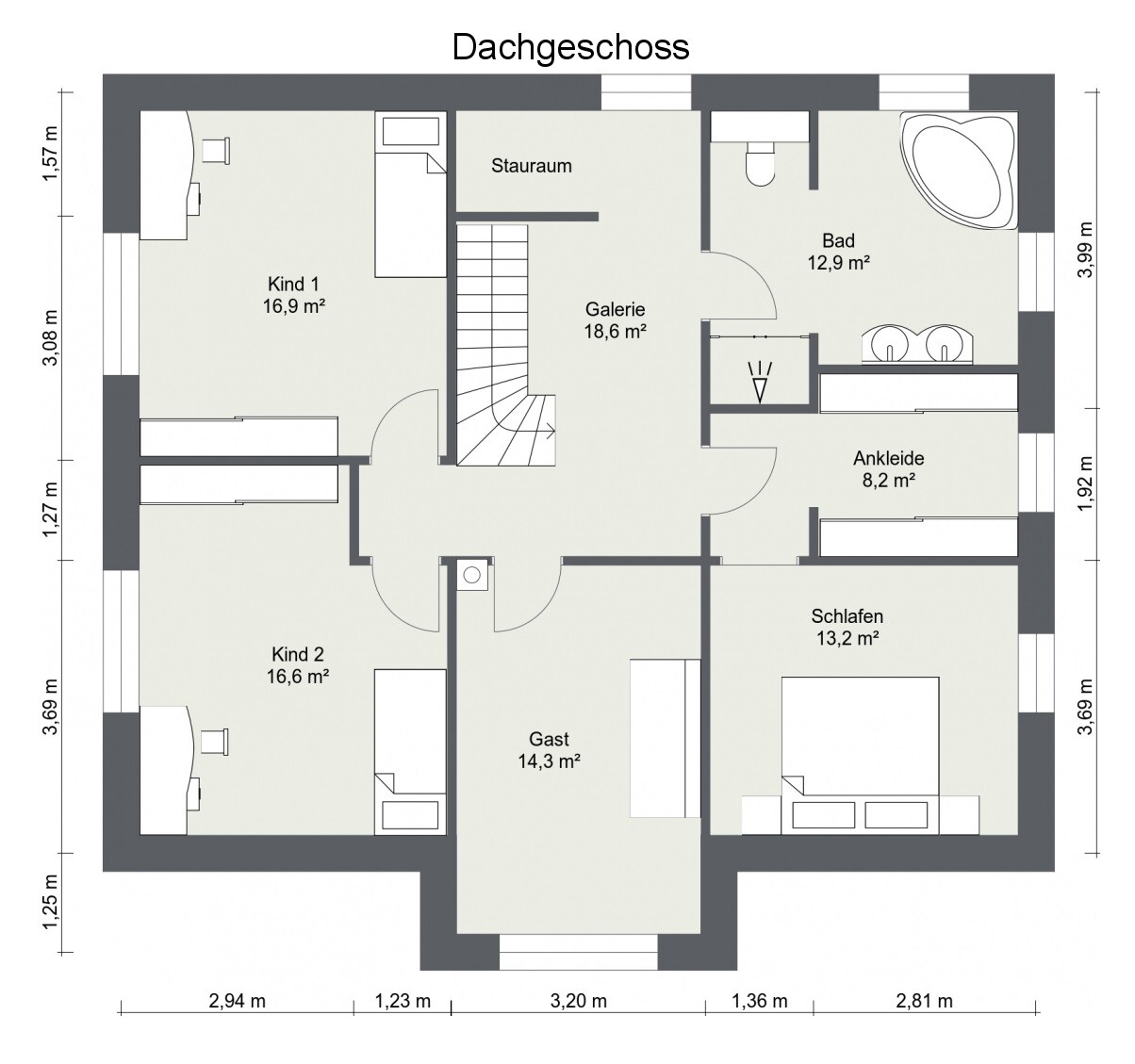

Upper floor: Bedroom with walk-in closet, 2 children’s rooms, guest room (or third children’s room), bathroom

Ground floor: Open living/dining area with fireplace, morning sun enters the kitchen and moves throughout the living room all day. The sofa always has a view of the garden and the fireplace.
Upper floor: Quite large children’s rooms, each room has windows

Ground floor: Position of the staircase, kitchen far from the entrance, distance of kitchen island from the wall, utility room too small?
Upper floor: Hallway too large and bathroom too small? Storage space poorly planned?

What do you think of the design, and what could be improved? Is a door from the hallway to the kitchen useful? Should we plan a half-landing staircase? Is the utility/technical room big enough? How do you rate the storage space upstairs?

And again regarding the measurements:
The office furniture doesn’t fit either. Likewise, the approximate measurement of 3.70m, 3.80m (12.1 ft, 12.5 ft) for the kitchen width/bedroom width doesn’t match up with the other rooms. How wide should the shower on the ground floor be? How deep should the shower on the upper floor be? On the upper floor, it’s currently not usable at all.
So be careful with the whole “spaciousness” of the house: it’s more appearance than reality. And as already mentioned, if you fix one corner properly, the other corner will suffer as a result.

We simply have an Ikea Pax wardrobe in the upstairs hallway where the vacuum cleaner is stored. I wouldn’t create a separate nook for cleaning supplies upstairs, as it would make the hallway look less appealing.
Your open-plan living and dining area is actually quite spacious, but the space is not used well. It gets very tight around the dining table, while there is plenty of room near the entrance and in the lower left corner. I also wouldn’t plan a shower with a glass door in the bathroom, as I wouldn’t want to deal with the constant cleaning.
Sabine
Sabine
