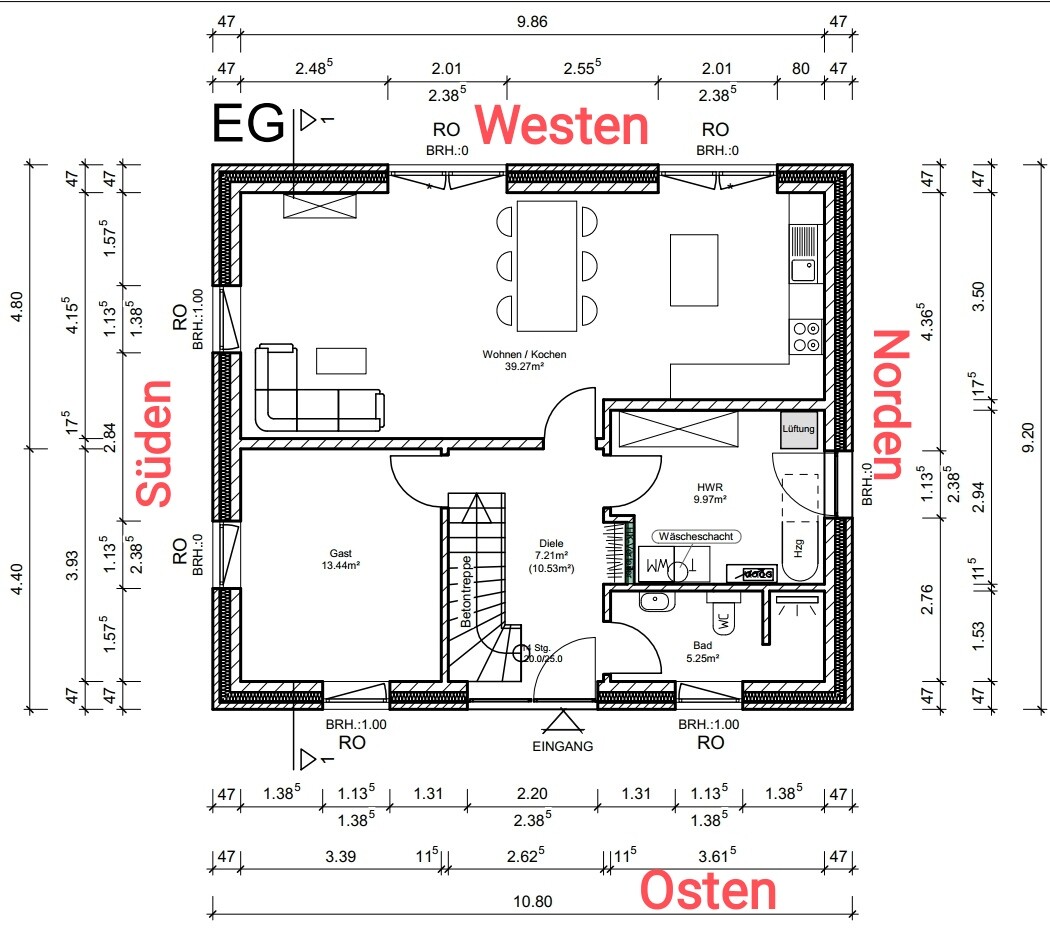

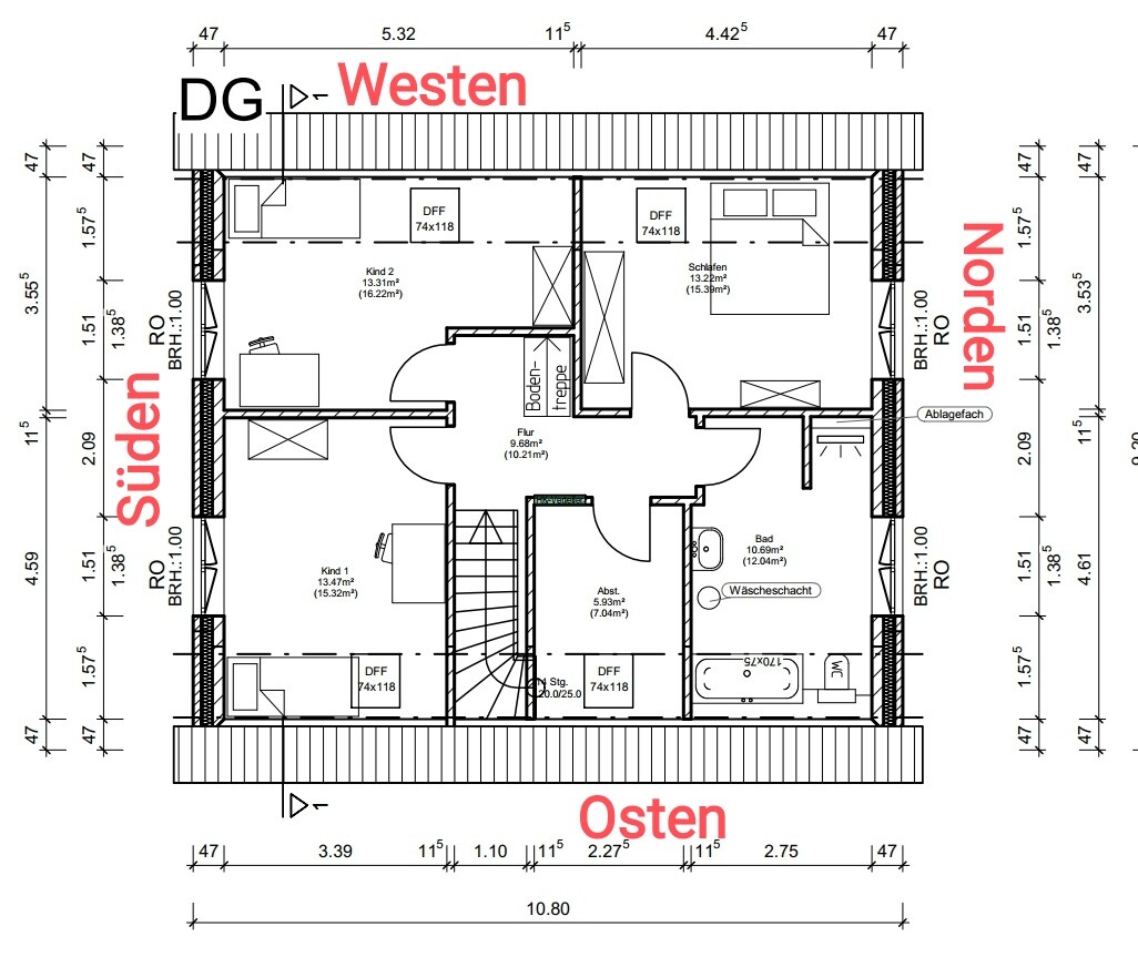

Pumpernickel129 Sep 2021 19:39Thanks again for all the previous responses. We now have a first draft of our floor plan with measurements and some furniture included. We have incorporated several suggestions from here and adjusted accordingly. What do you think of it now?
There is no window facing north in the kitchen area because the carport will be located directly adjacent to that side.
Upstairs, we are still undecided about the roof windows in the bedrooms, as we have read several times that they can cause noise issues from rain and hail. However, if we leave them out, we worry there won’t be enough natural light coming in. All bedrooms still have double casement windows.
Can you point out any disadvantages in our floor plan that we should maybe reconsider?

Pumpernickel1 schrieb:
There is no window on the kitchen side facing north because the carport will be directly adjacent there. The reasoning doesn’t quite make sense to me. North is an excellent orientation for non-glare light, ideal for kitchen work.
Can you point out any disadvantages of our floor plan, Counter question: where have you hidden the impro[vements]; I only see chan[ges]. Two disadvantages stand out: the toilet and the bathtub, both of which would cause head height issues. While having 3 cm (1.2 inches) of clearance above your head may be just enough to avoid actually hitting it, it probably won’t feel comfortable.
Pumpernickel129 Sep 2021 22:1111ant schrieb:
I don’t see the causality here. North is a great orientation for light that never causes glare, ideal for kitchen tasks.
Counter question: where have you hidden the improvements – I only see changes.
Two disadvantages stand out: the toilet and bathtub, both would cause head clearance issues. Having 3 cm (1.2 inches) of space above the head is enough to avoid actually hitting it, but it doesn’t feel comfortable. Our covered carport is located on the north side. That’s why we left out a window there, since the roof would block any light anyway.
There are improvements compared to the old design: for example, the small guest room with an integrated shower you mentioned has been removed.
But thanks for your suggestions anyway.
Pumpernickel129 Sep 2021 22:23ypg schrieb:
And where would the street be now?
Is everything rotated for the viewer or does it make sense? Do I have to somehow turn YOUR house myself? The traffic-calmed street is located to the east. To the west, the area is undeveloped.
