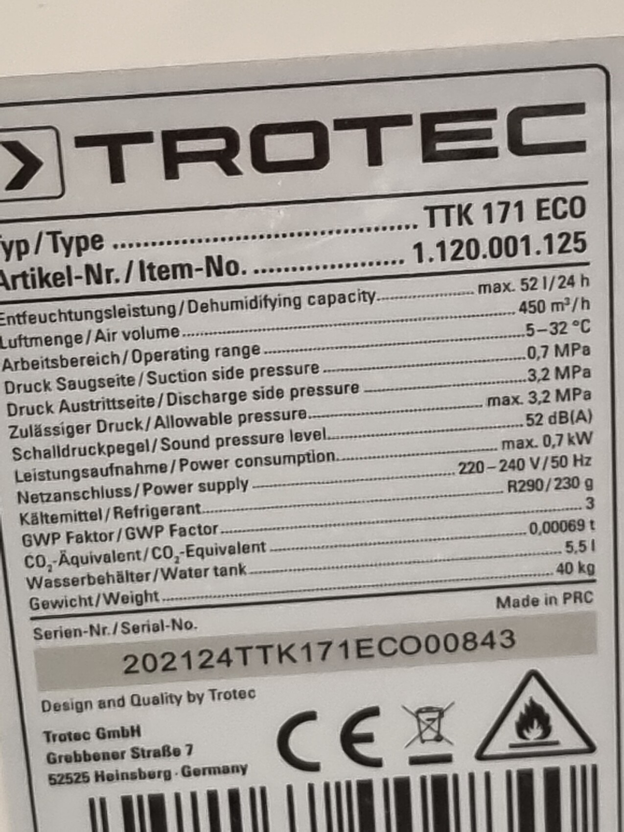

Neubau202226 May 2022 19:32Neubau2022 schrieb:
Here are the data for the dehumidifiers. If I read correctly, that would be around 100 kWh, which equals about 35 € per day. You have started a defined heating program with a specific warm-up protocol.
At some point, the moisture will release more slowly from the screed, and the plaster will also be dry.
Then using 2 construction dehumidifiers in the morning and 2 in the evening will be more than sufficient.
Eventually, just airing out twice a day will be enough.
Running everything continuously would really be a waste of money.
Dehumidifiers also work most efficiently at around 80% humidity.
Discuss this with the general contractor.

They will likely insist on this for warranty reasons. The screed is scheduled to be sanded by next week at the latest. This should ensure even faster drying. I will bring it up. Unfortunately, the drying process will take a bit longer because Kneif forgot to add two additives, and the site manager did not check this. The meter already shows 2,100 kWh since the start.
Neubau2022 schrieb:
The screed is scheduled to be ground down by next week at the latest. This should help speed up the drying process. I will bring it up. Unfortunately, the drying will take a bit longer because Kneif forgot to add two additives, and the construction manager didn’t check this. The meter has already recorded 2,100 kWh since the start. You can estimate about 5 kW per liter of water evaporated (latent heat of vaporization) and extracted with the construction dryer.
+ Heating up the masonry
+ Significant heat losses due to an uninsulated roof
