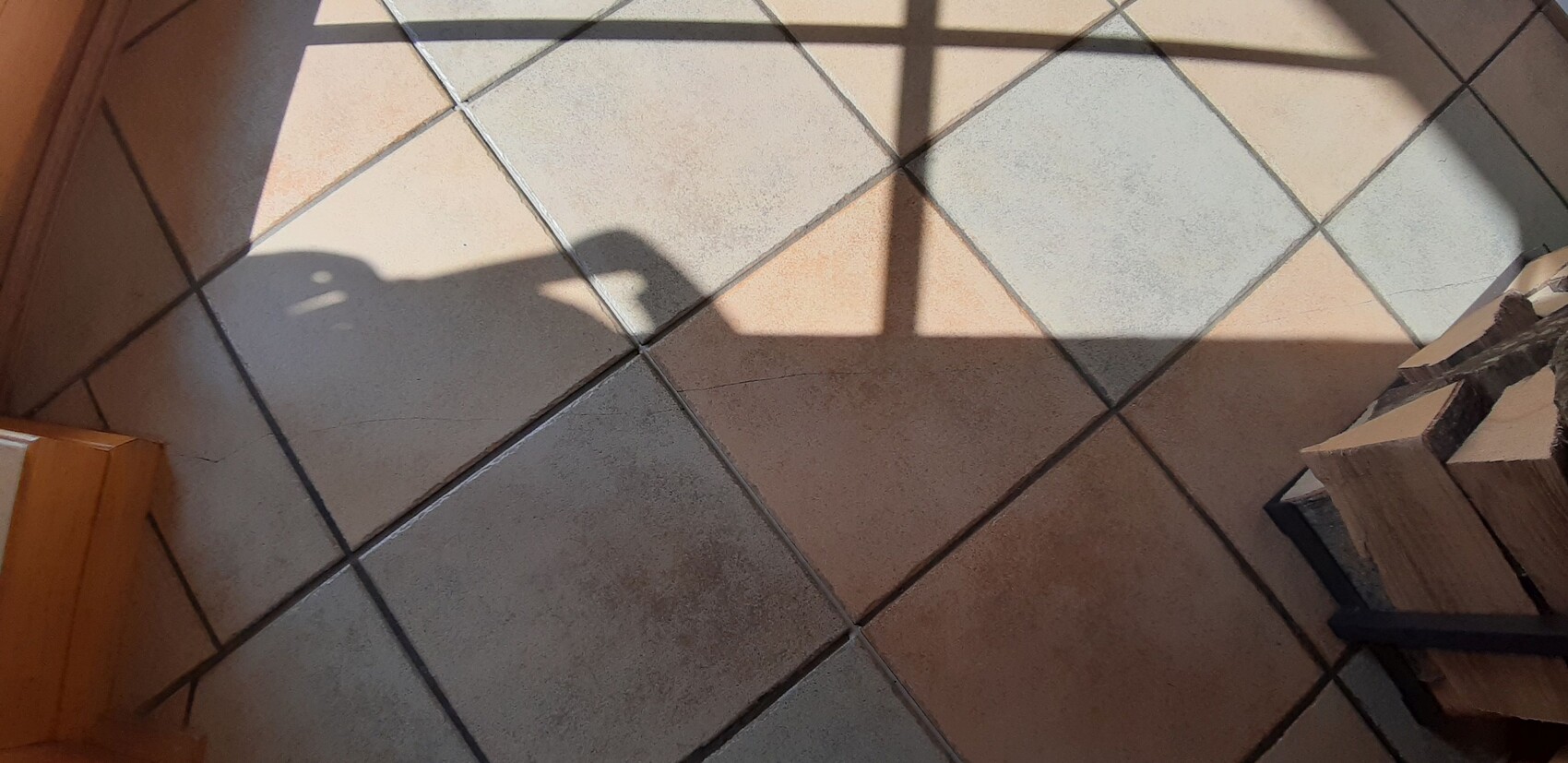

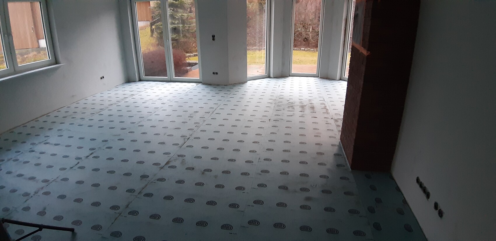

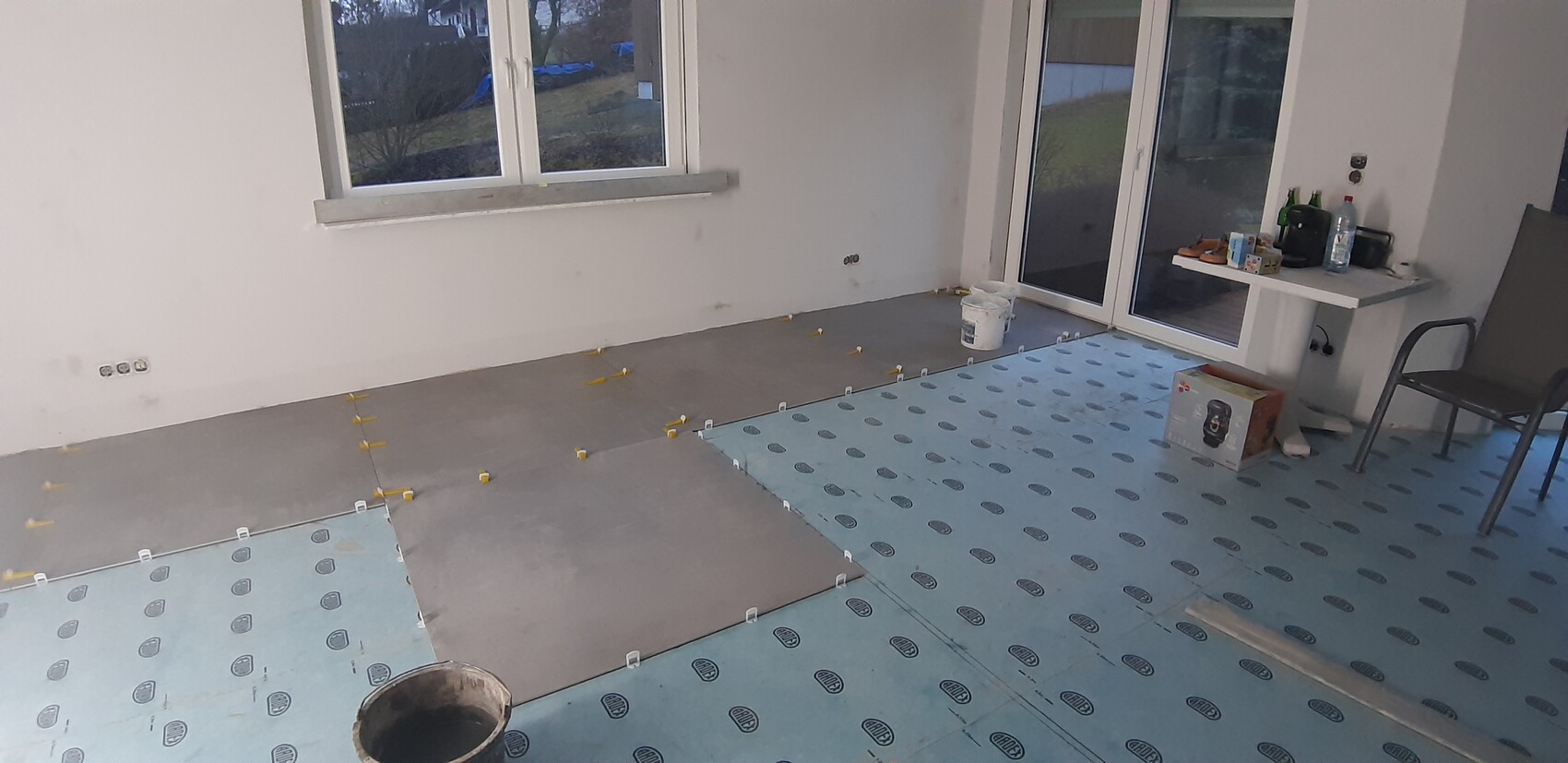

When we took over our house a year ago, the tiles in the living/dining area were cracked in several places (see example in the picture). The expert insisted that the screed probably wasn’t fully cured when it was installed. To be on the safe side, decoupling mats were laid before installing the current tiles. Since it’s not a new build, this probably wouldn’t have been necessary... but better safe than sorry 🙂
Crack at the living room/kitchen transition:
Tile floor with a pattern of square tiles; shadow of a person with a camera.
Decoupling mats:
Bright interior under construction with large windows; floor shows round insulation pad patterns.
Partially tiled living room:
Room under renovation with unfinished floor: blue underlays, yellow spacers, bucket, glass sliding door.
