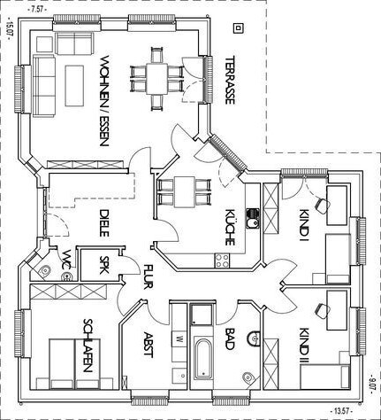

At the end of April 2019, we reserved a plot (plot no. 10) and started working on the floor plan. The plot is tied to the developer, and unfortunately, the planner has not turned out to be very creative (myself included). Two weeks ago, we had another meeting with the developer and talked about the three options mentioned above. We then chose one variant and want to proceed with it. We have now received a draft, which certainly still needs improvement.
For this reason, I would like to present the floor plan here again for discussion and hope for feedback, ideas, suggestions, and tips. Maybe you will immediately see things that “just don’t work” or are not practical for everyday life. I have also already noticed a few things that I would change, but since we will probably make quite a few modifications anyway, I have not yet suggested my own improvements in the floor plan. Also, the planner and I have not yet discussed doors and windows.

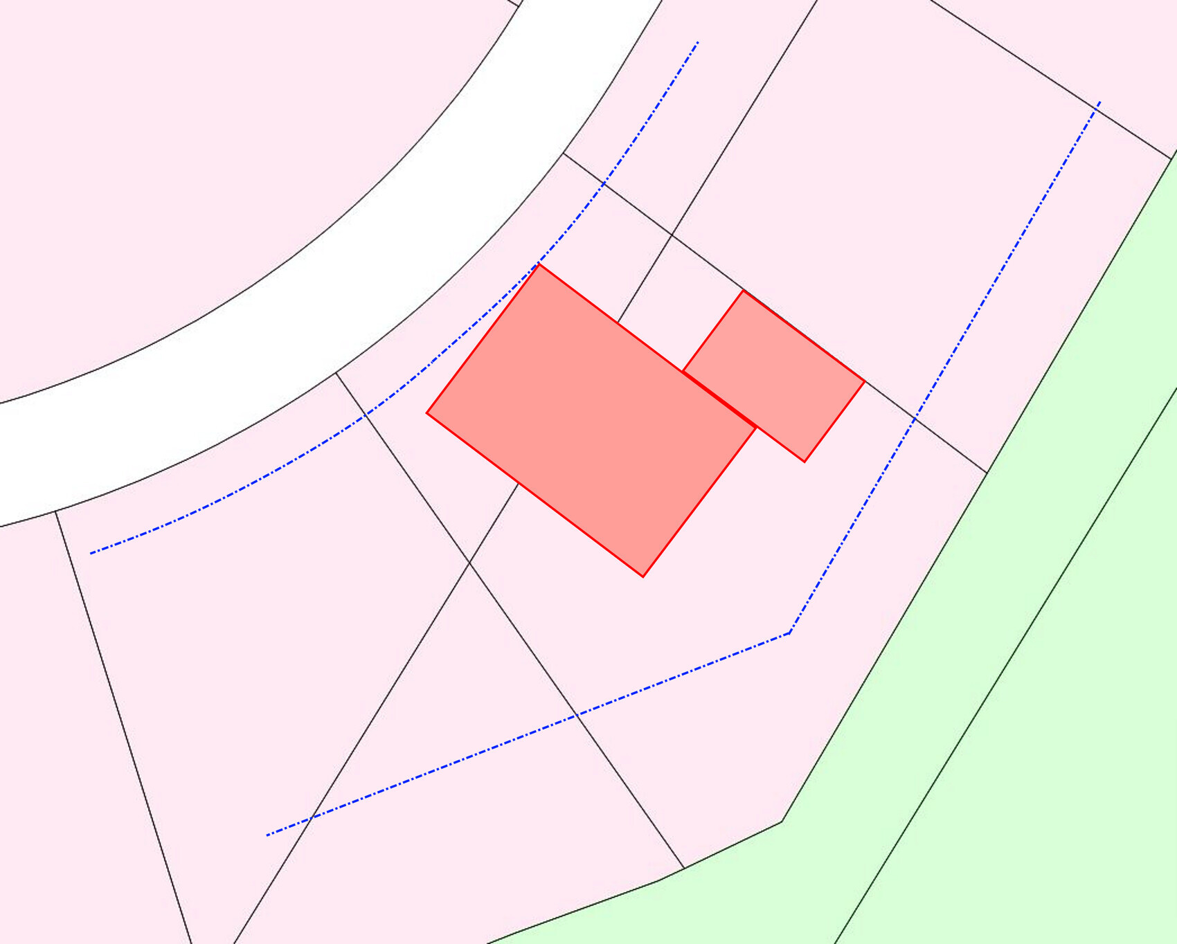

Development plan/restrictions
Plot size: 819m² (8809 sq ft)
Slope: NO
Floor area ratio (FAR): 0.4 (allowable exceedance 25 per 100)
Building envelope, building line and boundary: On the northeast side approximately 31m (102 ft) deep, west side approximately 35m (115 ft) deep, plot frontage on the street 18.7m (61 ft) and rear boundary (development limit) approximately 27m (89 ft). The major challenge with the plot is the narrow width at the front. Depending on house orientation, after the 3m (10 ft) building setback on the street side, we have about 19.5m (64 ft) to 20.4m (67 ft) available. This means that if the house is parallel to the street, it is 19.5m (64 ft), and parallel to the neighbor in the northeast direction about 20.1m (66 ft).
Side building setback: 3m (10 ft)
Number of parking spaces required: no specification
Number of floors: maximum 2 full floors
Roof type: gable roof, hip roof
Other requirements: Garage must be at least 5m (16 ft) from the property boundary.
Client requirements
Style, roof shape, building type: bungalow with hip roof
Basement, floors: no basement due to high groundwater level
Number of people, age: 4 people aged 36 years (female), 37 years (male), 2 years (child), 7 months (child)
Ground floor: living/dining/kitchen, utility room, guest toilet with shower, hallway with coat area and stairs to the upper floor, children’s rooms, master bedroom, bathroom, and storage room.
Upper floor: office, children’s playroom and additional storage space.
Overnight guests per year: 1–2 times
Open or closed floor plan: a mix of both
Conservative or modern design: a mix of both
Open kitchen, kitchen island: open kitchen with island would be nice but not a must, closed kitchen also has advantages
Number of dining seats: 4, with the option for 6–8 would be nice but not essential
Fireplace: no
Music/sound wall: sound system in the living room
Garage, carport: Space for 2 cars is required. Currently, I am considering a garage (3x6m / 10x20 ft) and carport (3.6m / 12 ft).
Other wishes/special requirements/daily routine, including reasons for preferences or restrictions
Who designed the plan:
-Developer’s planner / do-it-yourself
-There should be enough space in the coat area and behind the stairs to store jackets, shoes, etc.
-The children’s rooms have a comfortable size and are practically equal in size.
-Living room/kitchen are close to entrance and garage.
-The storage room has a good (central) location.
What do you not like? Why?
-Garage/carport is very far to the back (but I can probably live with this)
-The utility room is comparatively large and long
-The kitchen in my opinion is somewhat too large
-The living room is only the desired minimum size and could use 5m² (54 sq ft) more
-The main bathroom is located between both children’s rooms and the noise from showering and toilet use is likely to be a major issue
-The main bathroom could be slightly larger
-Between the garage and the property boundary there will be a dead space where weeds will probably grow later. Does anyone have ideas on how to prevent this?
-The garage is currently planned with a length of 9m (30 ft), of which 6m (20 ft) is for the garage and 3m (10 ft) for a storage room. The current position directly behind the garage is not optimal in my view
Price estimate according to architect/planner: no new price estimate received yet
Personal price limit for the house including equipment: 400,000
ideas from planner and do-it-yourself ideas from me
The main bathroom is located between the children’s rooms. How can we reduce noise disturbance to a minimum?
Imagine I drive a Skoda Superb into the garage. Since the garage is on the property boundary and the driveway narrows between the house and property line, I have to enter at a slight angle. Does this cause problems in everyday life? See pictures.
Assuming we build a double garage directly attached to the bungalow instead of a garage and carport, is there anything special to consider during construction?

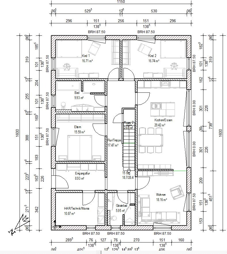

Chrisi190615 Aug 2019 20:45kbt09 schrieb:
uh .. you repeatedly mention the particular issue of your loud subwoofers, the noise from washing machines/dryers, etc., and then you want to place the subwoofers right between the bedrooms again with this proposal?I’m just stating what’s important to me first. What I can’t say quickly is the order of priorities. That the subwoofer should, if possible, not be next to a child’s room is a high priority. But if the living room is very far away from the terrace, that bothers me even more. So, in this case, I think the living room should go upstairs.
No, that’s not what he wants.
He actually wants the living room upstairs (at the back).
Ladies, we are playing games here. But are you aware that none of this will actually be implemented?!
Chris wants 150% but no compromises. He’s a guy who doesn’t think beyond being able to enjoy his subs in the evening.
The woman’s job is to do the laundry and much more. For some reason, we’re dealing with Chris here, who feels his chill-out spot is threatened if the house is logically and practically designed to work well for the family.Now you’re really bullying me hard. I’m definitely willing to make compromises. For example, I already did by placing the office upstairs. Usually, I spend about 32 hours a week in the office. One day I might go to the company. If there is any place where I spend a lot of time, it’s the office. Unfortunately, it’s not a chill-out spot. :-(
If you have to accommodate subwoofers, south-facing kids’ rooms, dryers, and short utility connections all under one roof: in my opinion, that’s waiting for Godot.
You’re wrong there, I think the generous dining table is confusing you.
In reality, it’s much less dramatic than in the drawing, and with a hip roof it’s also subtler than with a gable roof of the same pitch.
Anyway, definitely with a standard garage – any possible parallel offset is handled much better in a carport in between.
Ceterum censeo: a bungalow is a house type whose domain – apart from the special case of a wheelchair-bound family member – is the couple with completed family planning (whether childless, children already moved out, or the willingness to move when having more children). But the need for a children’s room on the ground floor automatically brings extra attic floor space and is its own strongest argument against leaving the attic unfinished. For such young children (2 years / 7 months), I still see a shared room as sufficient for a long time and the option to later separate them onto different floors to avoid each other (or then move the master bedroom upstairs) as worth considering.Our family planning is complete; my wife would like another child, but she respects my wish. Exactly right, with such young children it can still work for a long time that they share a room. For now, I’ll use one children’s room as an office.

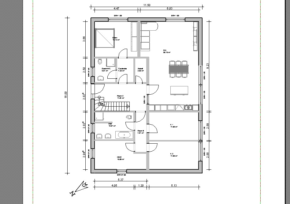

kaho674 schrieb:
I’ve adjusted the plan to 11.5 x 16 meters (38 x 52.5 feet), just for fun:
I really, really like this floor plan now. I don’t dislike the idea of a second storage room at all. Criticism? The children’s rooms are a bit long and narrow, but that’s not a big deal! Subwoofer by the bedroom? I can live with that! Oh wait, the stairs are missing. We still have to find a place for them somehow. If the house ends up a bit longer, that’s no problem. Half a meter (about 1.5 feet) would be okay if that’s enough?
I saved mine...
Subwoofer...check
Washing machine...check
Short utility lines...check
South-facing kids...checkGood floor plan, but I like kaho674’s version better.

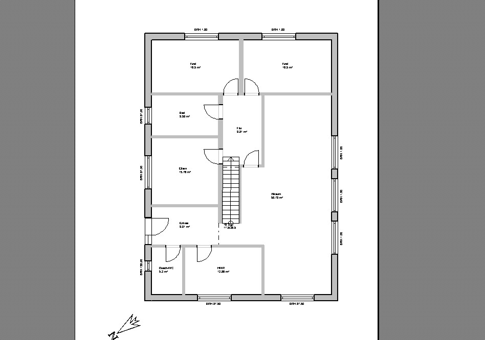

Chrisi190615 Aug 2019 21:02ypg schrieb:
I’ve saved mine...
Subwoofer...check
Short plumbing lines...check
Children facing south...check This one is also really good... Now the decision is tough... Sorry, I didn’t look closely at first, so my earlier comment about it being better isn’t quite accurate. I would say they are equally good...
You want to have the terrace connected to the living room upstairs and the rest of the garden.
We (Kerstin and I) suggest placing the terrace on the south side, so it will still be sunny in the evening after your work (by the way, we also work 40 hours per week). The living spaces should also be filled with sunlight. This wouldn’t be the case if the open-plan area is only placed on the east side, as a working person would then get little sun.
