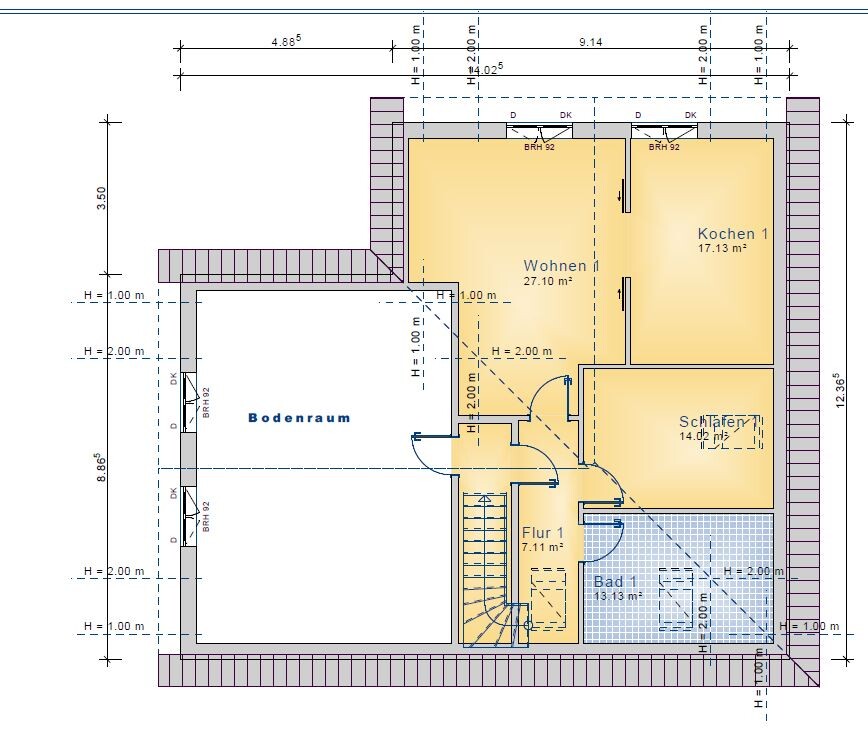

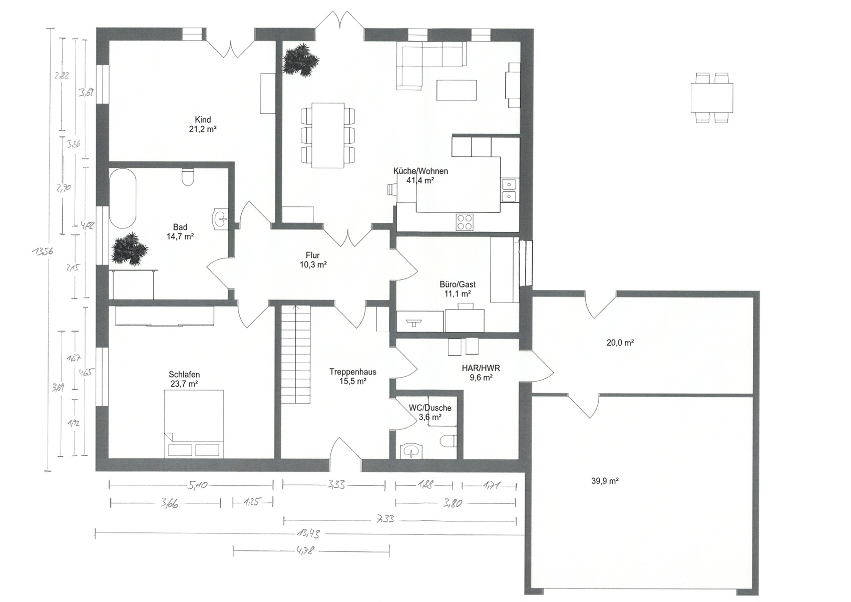

The ground floor (GF) will be as shown in my sketch below. The upper floor (UF) will be larger, but the room layout will remain the same.

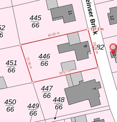

The house will be positioned parallel to the street, with the front door facing the street.
Now I am cautiously looking forward to criticism, questions, and hopefully lots of input from you!
Plot size 23.5 x 40 m (77 x 131 ft)

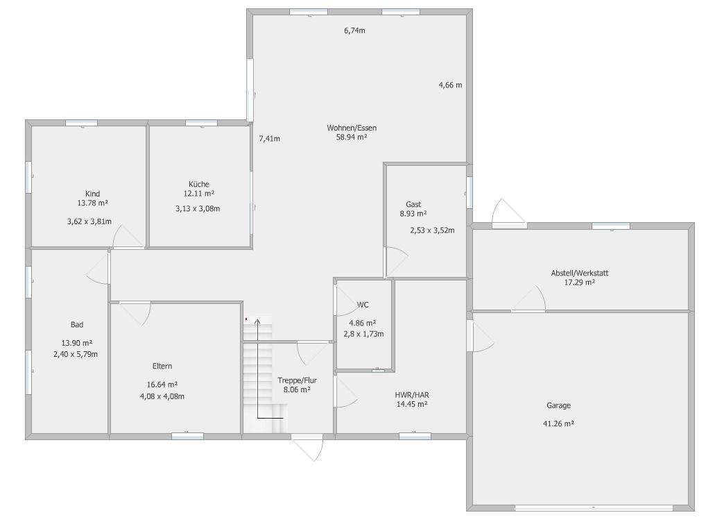

as I have mentioned several times before, your current floor plan isn’t ideal when considering a possible wheelchair. But even without a wheelchair, I find it rather uncomfortable. The dining area feels like a cave.

To be honest, the upper floor doesn’t impress me either. The corridors seem quite narrow up there, among other things.

For now, we are quite satisfied again, and therefore I would like to have you review the new floor plan once more. We have left out the upper floor for the time being. The knee wall height and roof shape do not matter to us at this point. We have various ideas about that.
What bothers us about the floor plan are the following points:
- Passage to the children’s room
Later on, our daughter will probably like that the parents are not standing right in the middle of the room, but unfortunately, a bit of space is lost here
- Hallway
It will be dark; we hope to improve this somewhat with glass doors towards the stairwell and living room. Still not ideal, but we could live with it
- Utility/technical room
Due to the angle and circulation paths, we lose a lot of usable space. Maybe the technical equipment could be moved to the upper floor?
I hope you see our new floor plan as a step in the right direction and I look forward to your honest feedback.
P.S.: The windows are not yet drawn in their final positions (one is definitely missing above the sink). And can you tell me when it will be possible to send messages here?
in a few weeks, we have an appointment with a "building consultant" who had already offered to support us. Whether we will work with him, whether he will help us find other companies/architects, or if he will simply act as a discussion partner, remains to be seen. For now, we have slowed down the whole process a bit.
Nevertheless, we think about it every day, and since we do not want to completely discard the construction company that has already given us an offer, we have drawn a new floor plan ourselves. Some elements from the old floor plan have been incorporated, but we also tried to include your feedback.
- Hallway
