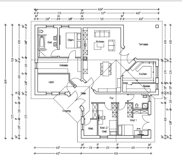

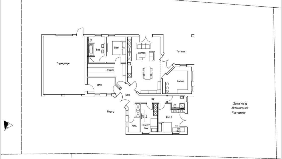

we are still in the planning phase and are having some difficulties progressing. Although the design is already quite good in many aspects, it doesn’t yet fully match what we envision.
The plan is for a bungalow of about 150sqm (1,615 sq ft). Having separate parents’ and children’s areas was important to us. The kitchen should be closed off, and there should be a covered terrace.
Development plan/restrictions
899sqm (9,676 sq ft)
slight slope
bungalow
Homeowners’ requirements
Rather Mediterranean style
No basement, bungalow
3 people, ages 36 / 29 / 3
No office
Guest room/ironing room
conservative or modern architecture: We like to combine old and new
open kitchen, kitchen island: closed
Number of dining seats: Kitchen 3, dining area preferably 8–10
Fireplace: Yes
Balcony
Garage: Double garage with space
Who created the design: Floor plan from us, implemented by a designer
What don’t you like? Why? We are not quite satisfied with the children’s room as the bed is in the wrong place, and we think a 1.40 x 2.00 meter (4.6 x 6.6 ft) bed should fit in there eventually.
The biggest problem at the moment is with the kitchen/living/dining area layout, as we can’t find a good position for the dining table. Somehow the table is always in the way however we turn it. If we swap the living and dining rooms, we then have problems with fitting the couch and TV wall unit.
Price estimate from architect/designer: 300,000
Personal price limit for the house, including fittings: 350,000
Preferred heating system: Gas heating with solar collectors on the roof for hot water

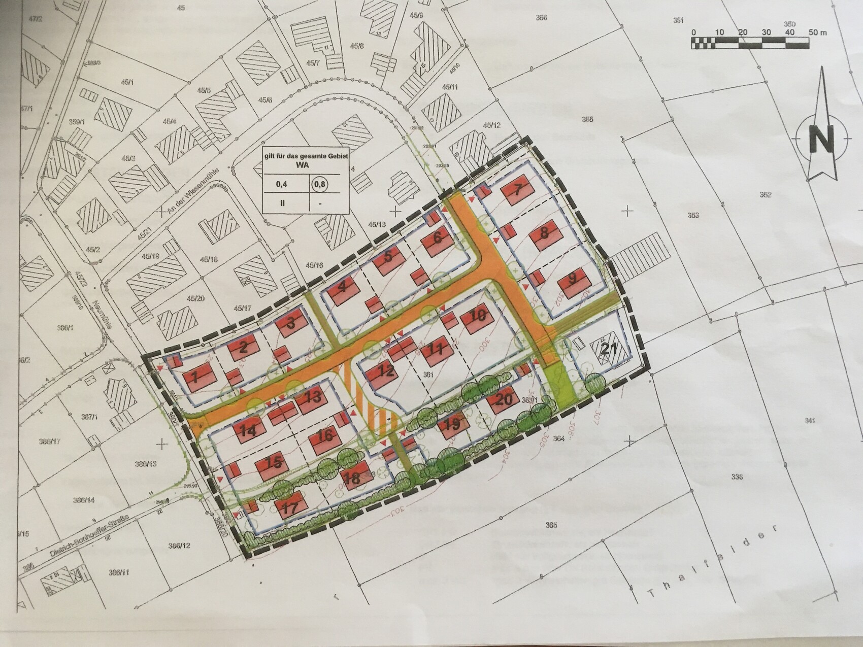

Plot number 18 is ours.
You are also welcome to point out any other mistakes or issues we might have made or incorporated. Best regards, Alex

illvisionz1 Jul 2019 20:16Thank you all for the many responses.
We like the suggestion with the children’s room and will pass it on as such.
We want to keep the separate area for parents and child/guest.
And if someone comes upstairs, it will be us as parents with a small terrace and a hot tub.
Feel free to make changes to our floor plan; a picture often says more than a long text.
Best regards, Alex

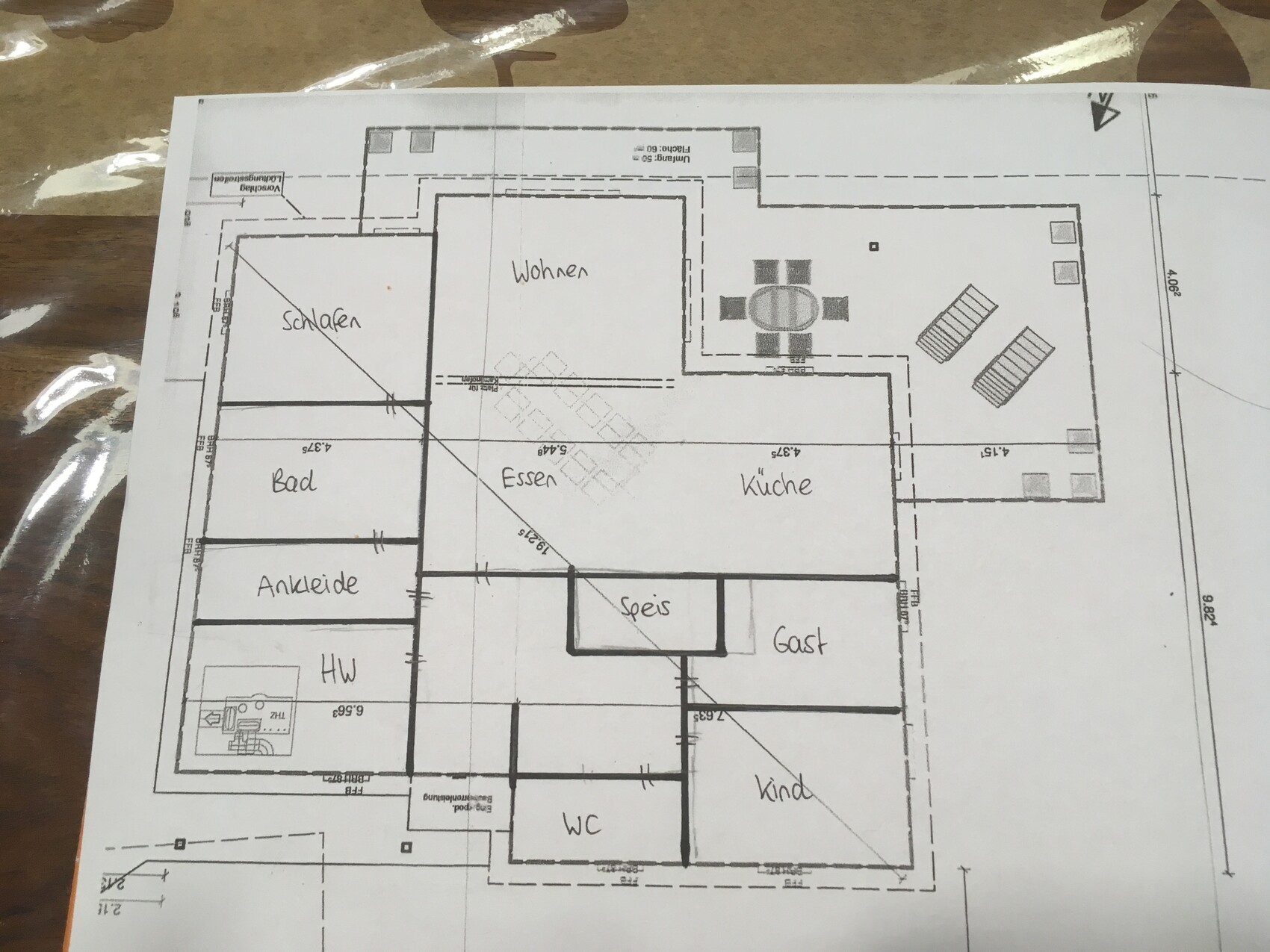

illvisionz2 Jul 2019 21:01Hello, I looked at both plans. We absolutely dislike it when you enter a house and immediately encounter two doors leading to the parents’ and children’s bedrooms within a meter, that’s a deal breaker for us.
I’m attaching a picture of a floor plan idea we had before, until we came up with the idea of having a diagonal entrance. We liked that this design didn’t provide direct access to the parents’ and children’s areas, but I’ll explain that briefly below. Unfortunately, there are no dimensions. Please disregard the pantry.
