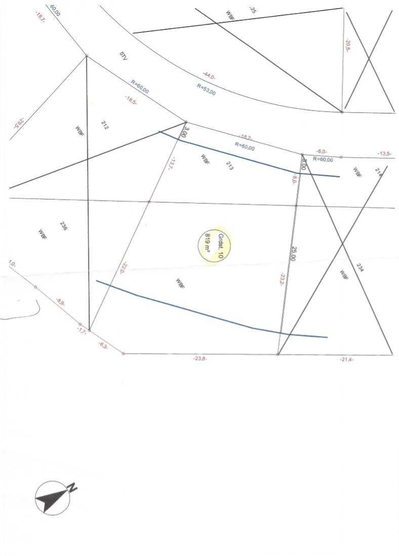

Plot size: 819m² (8,813 sq ft)
Slope: no

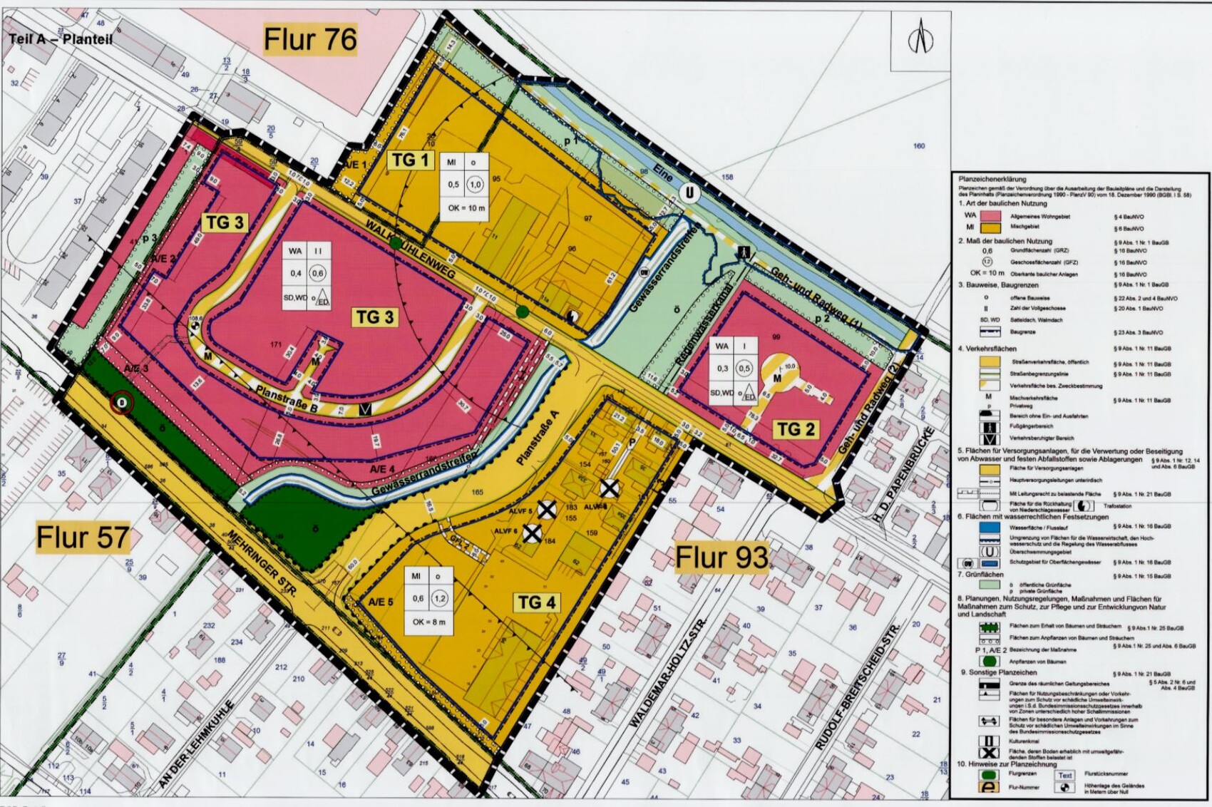

Site coverage ratio: 0.4 (allowable exceedance 25 per 100), so 0.5? -> This only applies to auxiliary buildings, right?
Floor area ratio (FAR): 0.6
2 full floors
Building envelope, building line and boundary: approx. 13m x 25m (after southeast enough space), see drawing
Minimum garage distance from the street is 5m (16 ft)
Roof type: gable, hip roof

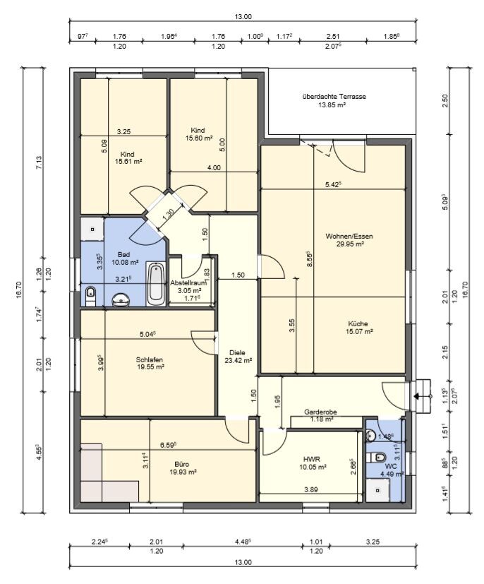

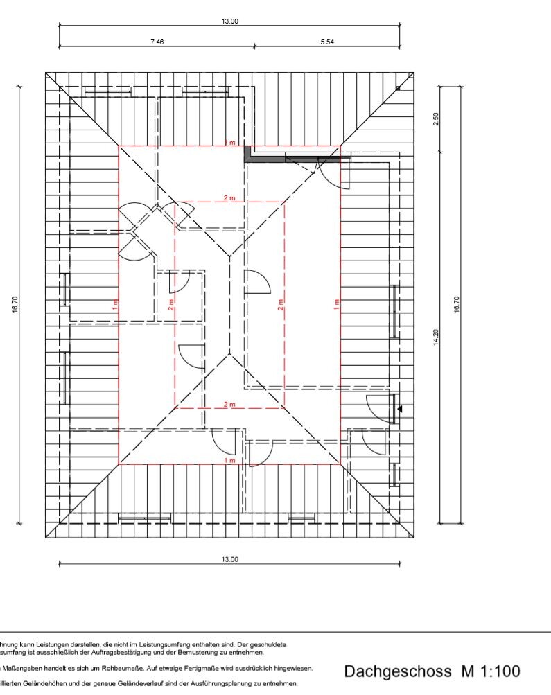

What is the most important/basic question regarding the floor plan in 130 characters?
Are there other floor plans that meet our needs? (Alternatives) Is there enough space in the bathroom for a walk-in (barrier-free) shower? Is the office too narrow? (3.11 x 6.59m (10 x 21.6 ft)) If the attic is to be converted, where could a staircase be placed? Current design is 13m x 16.7m (43 x 55 ft). Would extending it to 13m x 17.7m (43 x 58 ft) affect the appearance negatively? I think it would look too stretched to the rear.

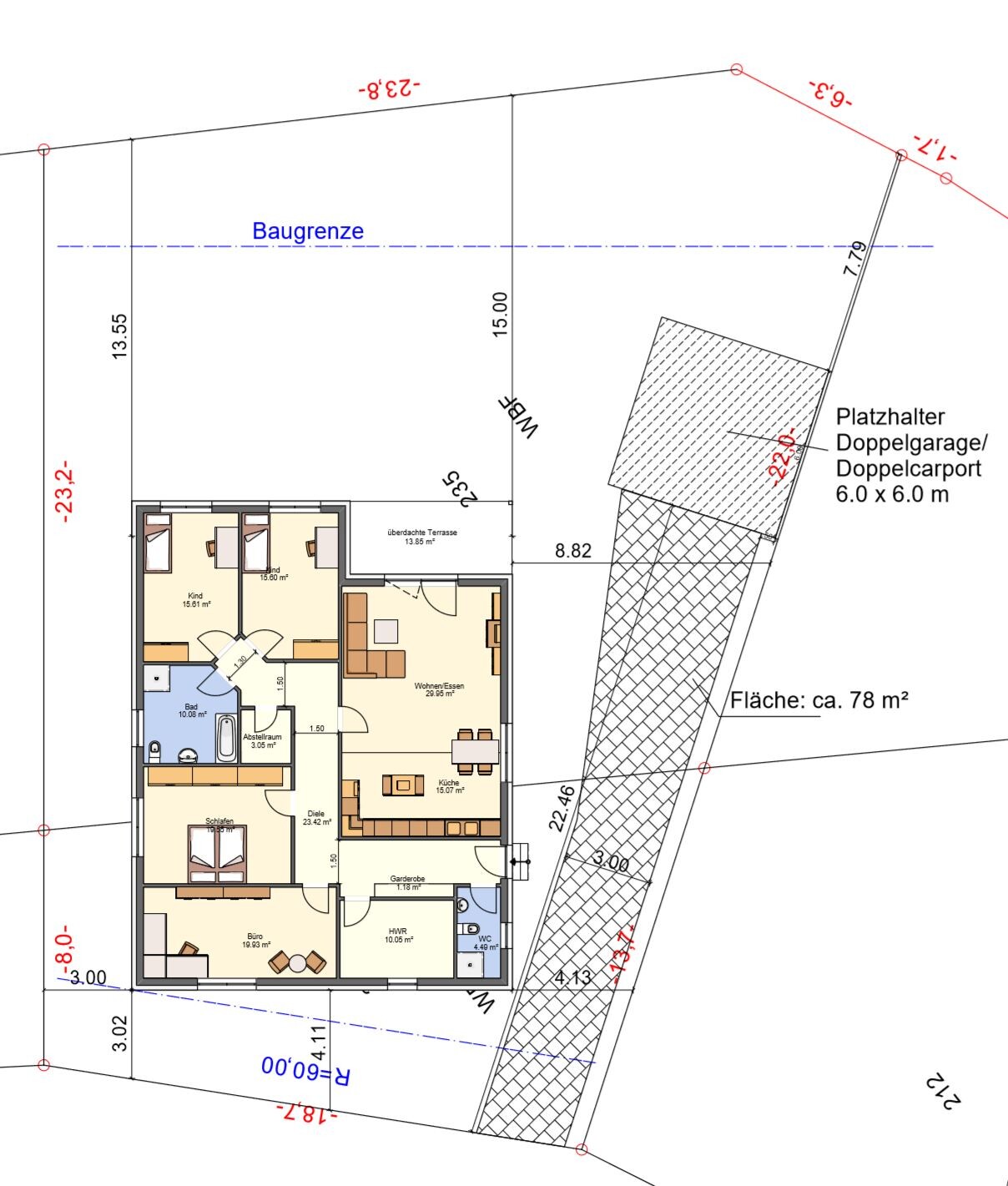

Chrisi1906 schrieb:
To me, it almost looks like we should start completely from scratch. The question I have is how do I get from what we want to the optimal floor plan? Should I reconsider the shape of the house?When I say the plot is not easy, I am actually understating it.
Maybe this is an approach?
Chrisi190623 Jun 2019 09:52ypg schrieb:
When I say that the plot is not straightforward, I am understating it. Maybe this is an approach? Thank you very much for the sketch. Which side faces the street? The one with the bedroom? What do the dashed dots represent? What kind of room is marked with a U? What is the room above the bathroom?
Sorry, this is JUST A SKETCH... so nothing final, and it might be a bit distorted or exaggerated...
Chrisi1906 schrieb:Bottom
Chrisi1906 schrieb:The roof... while the ones on the right are not valid
What do the dashed dots mean?
Chrisi1906 schrieb:I don’t see a U... oops:
What kind of room is this U?
Chrisi1906 schrieb:The living room? No, of course the utility room... that’s still missing in your plan, isn’t it?!
Chrisi190623 Jun 2019 12:57ypg schrieb:
Sorry, it’s JUST A SKETCH... so nothing final, and it might be a bit skewed or exaggerated...
Below
The living room? No, of course the utility room... that’s still missing in your plan, isn’t it?! Yes, the utility room was still missing. I meant the U at the bottom right in the room.
As a reminder, we need the following rooms:
2 children’s bedrooms
1 office
Living room
Kitchen
Bathroom
Guest toilet
Utility room
Could you please clarify what K stands for and where the living room, kitchen, and both children’s bedrooms are located? Thanks!
Chrisi1906 schrieb:
The U at the bottom rightI think that’s a K for kids’ room.C

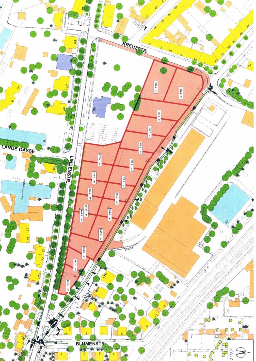

Chrisi190623 Jun 2019 23:25In our town, a new residential area is currently being developed. If I were willing to wait, I could probably buy one of these plots of land later on. However, it would be significantly more expensive, meaning at least 25€ more per square meter (11 USD per square foot).
Let’s assume I choose one of the plots in the northern part, where the two large orange buildings are located. Wouldn’t these be easier to build on?
