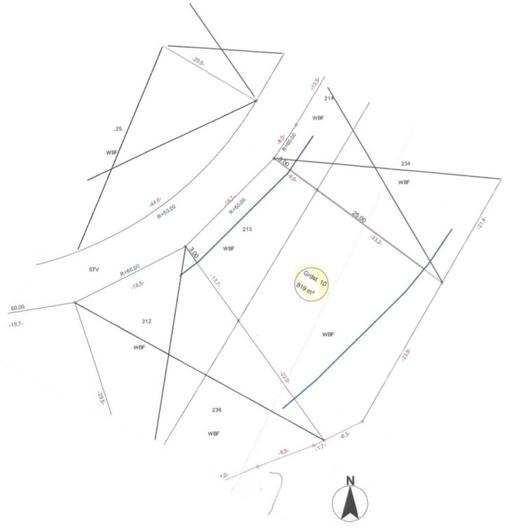

I don’t understand how planning is even possible without a proper site plan. You don’t have a straight boundary line along the street at all. So why do you align the house “parallel” to it? Also, the building boundary is an arc, which needs to be taken into account when positioning the building.
[ATTACH alt="Lageplan_LK.png"]37393[/ATTACH]
Here is the version with a 6m by 9m (20ft by 30ft) double garage.
Take another look at the graphic below. You can see the front boundary is straight. I can’t explain why it’s shown as a curve in the zoning plan.
Site plan with boundary lines, dimensions, WBF markings, and north arrow.

Yes, and where does the graphic come from? The basis for my site plan is the current cadastral map from the Sachsen-Anhalt Viewer. I trust this geometry more because even your plan shows R=60.00, yet a straight line is drawn. Also, the representation of the rear building limit does not match the zoning plan.

Yes, and where does the graphic come from? The basis of my site plan is the current property map from the Saxony-Anhalt viewer. I trust this geometry more, since even in your plan it says R=60.00, but a straight line is drawn anyway. Also, the depiction of the rear building boundary does not correspond to the development plan.
I received the graphic from the developer. I will ask the developer why there are differences.
