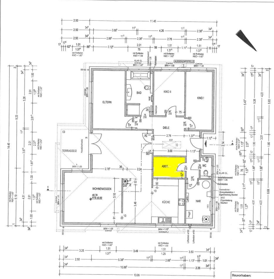

As a bungalow owner, let me share some of my endless wisdom:
Basically, when you choose a bungalow, you accept a certain level of closeness. You will never be able to separate your living areas completely. Even with a hallway, you will still hear what your little boy is doing in his room. That’s the nature of a bungalow. If you want much more separation, you will have to consider adding another floor.
Another principle of a bungalow is short distances. This means you try to design as “circular” a hallway as possible. You can only really achieve this by grouping living areas together or by building large enough so that everyone has their own bathroom. Because nothing is more annoying than passing the front door in the nude, rushing to the walk-in closet and then moving into the bathroom. A walk-in closet should always be located near the bedroom anyway.
I know others might see this completely differently, but you’re primarily building the house for yourselves. Your child will move out in about 17 years. By then, having your bedroom far away from the main bathroom will become very inconvenient for you. Plan the bathroom next to your bedroom. The young generation can be expected to walk a few extra meters.
Kitchen: It seems a bit small. Especially if you want to bake or cook together sometimes and one person opens the dishwasher—you will end up bumping into each other. Give yourselves a bit more space there.
Living room: I also find it a bit cramped. You’ll be entertaining guests there, and it will get quite tight.
I’ve attached our floor plan for you. Maybe then you’ll understand what I mean by a “circular hallway.”
Floor plan of a house: master and children’s bedroom, kitchen, bathroom; yellow highlighted storage room.
