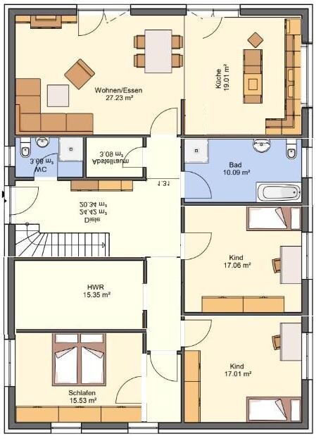

For the initial selection, there were three rough floor plan drafts. One was from Yvonne, the second from kbt09, and the third from the planner/ourselves. Many thanks to both of you for the good ideas! After some time for consideration and consultation with the developer, we decided to pursue the third floor plan.
If I say that the plot is not easy, I am understated.
Maybe this is an approach?
kbt09 schrieb:
I continued with the approach from the floor plan adjustments.
Architect’s floor plan of a single-family house with living room, kitchen, bedroom, and bathroom.
Floor plan of a building on a plot as architectural drawing
Now to the main topic.
At the end of April 2019, we reserved a plot (plot no. 10) and started working on the floor plan. The plot is tied to the developer, and unfortunately, the planner has not turned out to be very creative (myself included). Two weeks ago, we had another meeting with the developer and talked about the three options mentioned above. We then chose one variant and want to proceed with it. We have now received a draft, which certainly still needs improvement.
For this reason, I would like to present the floor plan here again for discussion and hope for feedback, ideas, suggestions, and tips. Maybe you will immediately see things that “just don’t work” or are not practical for everyday life. I have also already noticed a few things that I would change, but since we will probably make quite a few modifications anyway, I have not yet suggested my own improvements in the floor plan. Also, the planner and I have not yet discussed doors and windows.

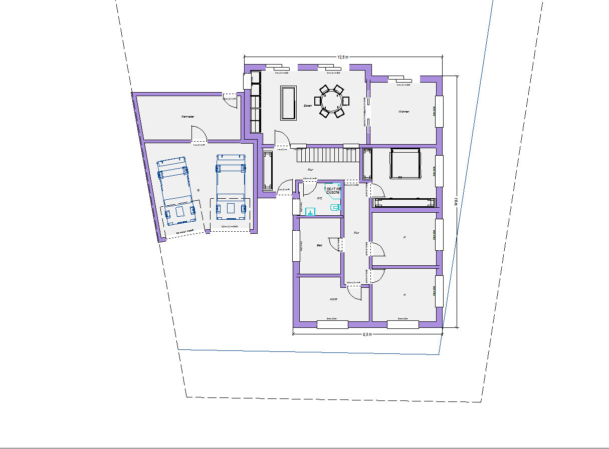

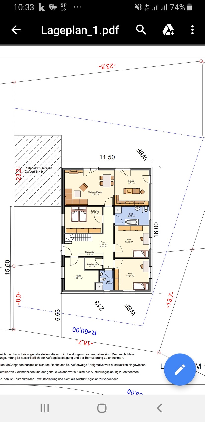

The main bathroom is located between the children’s rooms. How can we reduce noise disturbance to a minimum?
Imagine I drive a Skoda Superb into the garage. Since the garage is on the property boundary and the driveway narrows between the house and property line, I have to enter at a slight angle. Does this cause problems in everyday life? See pictures.
Assuming we build a double garage directly attached to the bungalow instead of a garage and carport, is there anything special to consider during construction?

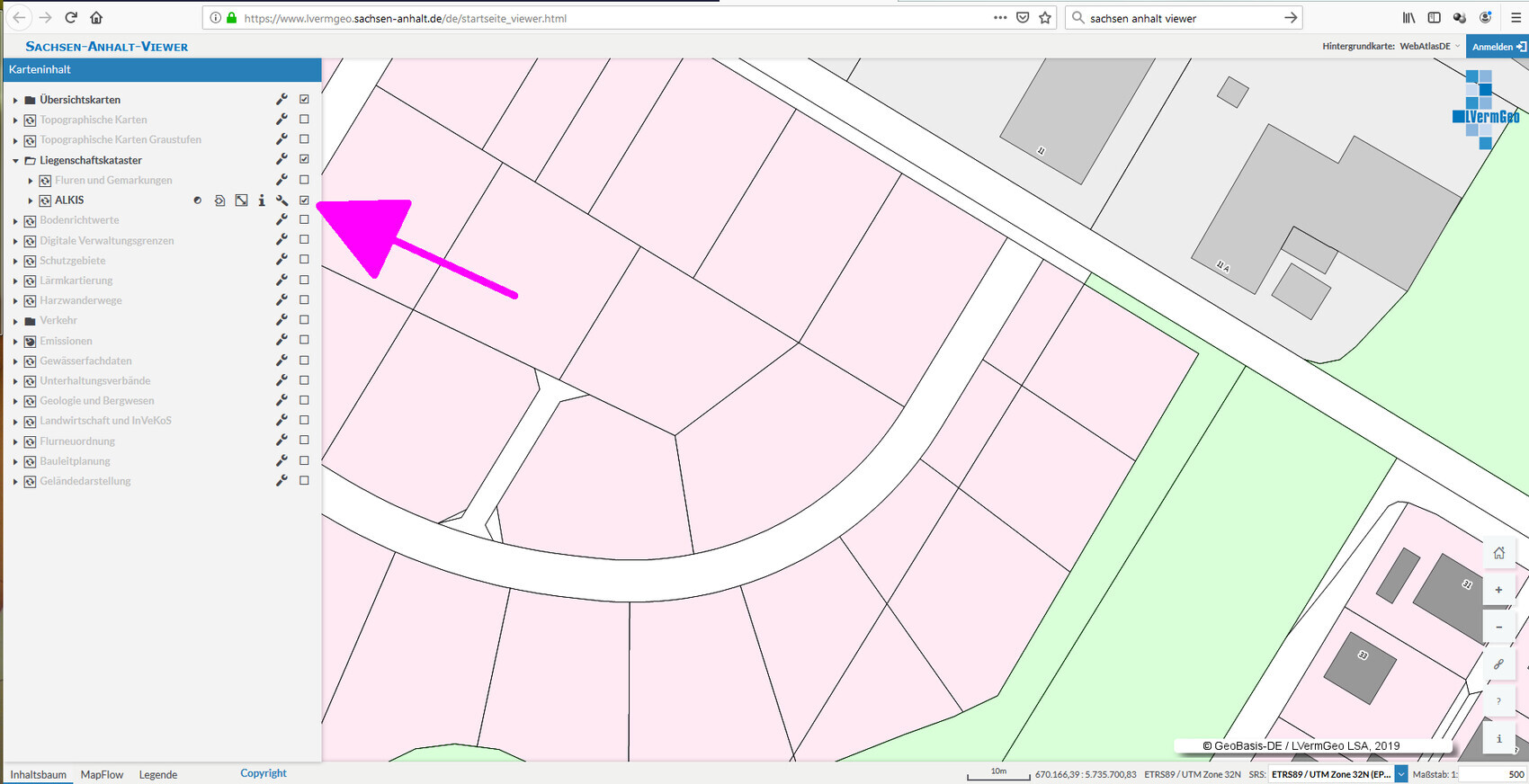

1. If you had read everything, you would know that this is not yet my plot of land.
1. I have read everything.
2. I don’t know who owns the plot now, since you only mentioned reserving it over three months ago.
3. Ownership is irrelevant to the contradiction between the detailed planning and the lack of understanding of the geometry.

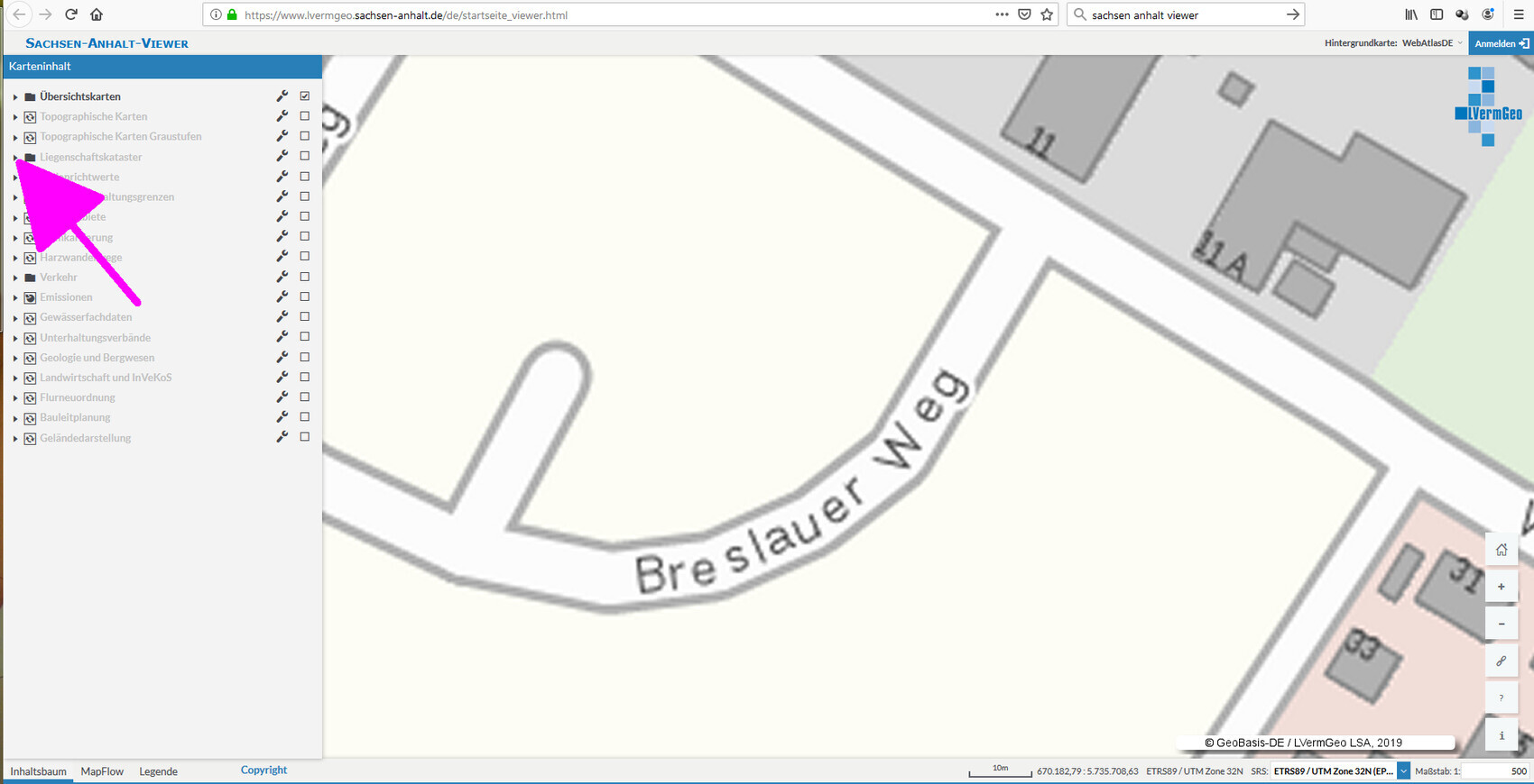

Chrisi1906 schrieb:
If you look at the building area, you can see that the road is not a smooth curve.
Fascinating. You still don’t believe it!?
Even if you base your geometry statements on WebAtlasDE, the contradiction remains on the opposite side of the road, which also has kinks but is shown as a smooth circular arc with a radius of 53m (175 feet) in the developer’s plan.
Chrisi1906 schrieb:

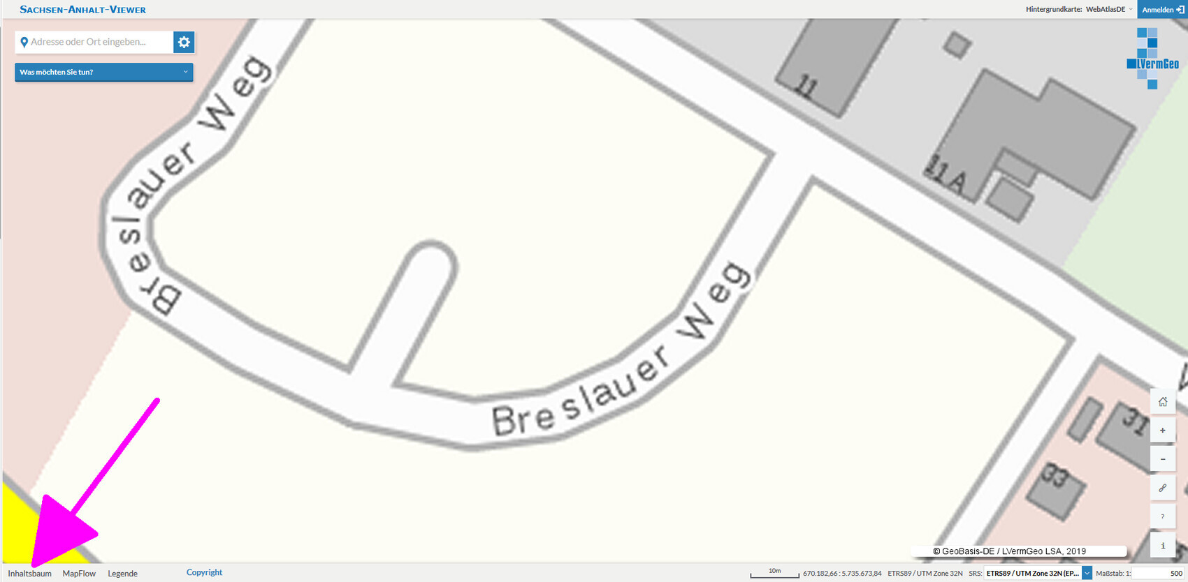

Could you show me how you filled in the Sachsen-Anhalt Viewer?
Gladly:
Map view with Breslauer Weg; surrounding areas, pink arrow bottom left marking.
Sachsen-Anhalt Viewer map view with pink arrow on the left content list and street names.
Sachsen-Anhalt Viewer map view: pink parcels, arrow marking a parcel along the street layout.

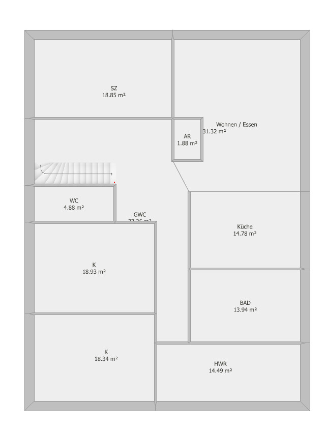

I’ve gathered the designs here once again. Honestly, I’m not really satisfied with any of them (except for my own, which I’ll leave out here ). The biggest drawback of most designs, in my opinion, is the poor zoning between the private and living areas. When I have guests, it’s not ideal for them to have to pass the bedrooms or the family bathroom first to get to the living room. And with kids, you have guests quite often.
Also, when entering the house, you want to be able to quickly drop off your things, and in the next step, the house should open up invitingly into the living area. I think Yvonne’s design handles this quite well, while the others give me more of an office building vibe.
Unfortunately, in Yvonne’s design, the kids’ rooms face the dark north and the driveway, because otherwise, they would be next to the disco room again. In my opinion, the distance probably isn’t enough for the children to sleep peacefully.
Well, you always have to swallow some toad, and no one has died from that yet. I’m curious to see what will come out in the end.

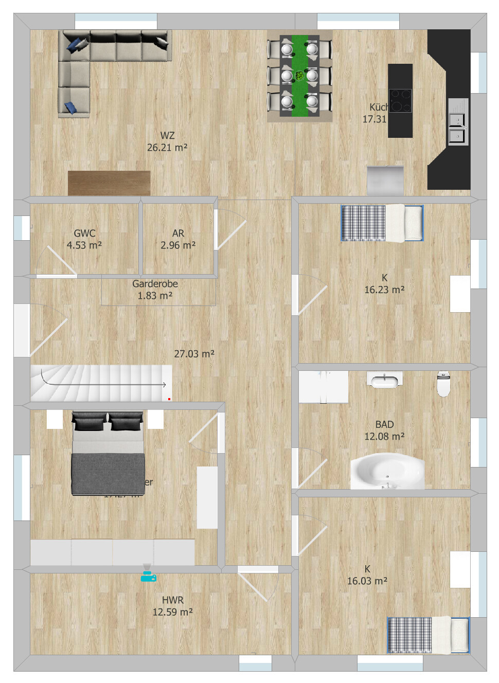

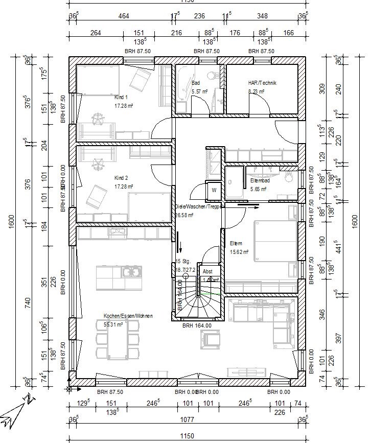

I had changed ypg’s floor plan incorrectly. Here is her original...
Hand-drawn floor plan of a house: rooms, hallway, staircase and doors.
In your floor plan, I find the living room very small. The rest looks very good to me, especially the solution with the garage is great.
Floor plan of a single-family house with garage on the left, living room, dining, kitchen, hallway, bedroom.

Hand-drawn floor plan of an apartment with several rooms, doors and furniture

kaho674 schrieb:
Unfortunately, Yvonne’s children’s rooms are located on the dark north side and next to the driveway –
I have not placed any children’s rooms on the north side, nor is that part of my design.

I find the living room in your floor plan quite small. The rest I really like. Especially the solution with the garage is excellent.
I would simply try angling the house with a standard-sized garage, meaning aligning it parallel to the northern property boundary. This has the advantage of allowing more afternoon sunlight into the lower part of the house and creates a more interesting terrace layout on the south side.
Regarding children's rooms in the north or south:
There’s no general rule here: south- and west-facing rooms are definitely more comfortable because of natural daylight. However, if the south-facing window only accounts for about 10% of the wall area, a north-facing window with 20% glazing will likely provide better light.
But honestly: imagine two identical rooms—one on the north side painted in pastel colors, furnished with light furniture and carpet, and with only a few neatly put-away toys; the other on the south side with white walls, a dark blue carpet, and a colorful, cluttered mix of items, like Elsa meets DiddleMaus... Which one feels more cozy?

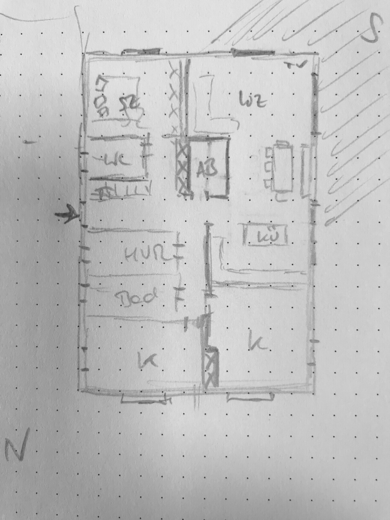

I would simply position the house with a standardized garage at an angle, meaning parallel to the northern property boundary. This has the advantage of bringing more western sunlight into the lower part of the house and creating a more interesting terrace layout on the south side.
Regarding children's rooms on the north or south side:
There is no one-size-fits-all answer: south- and west-facing rooms are definitely more comfortable due to daylight. But if the south window is only 10% of the window area, a north window with 20% will certainly outperform it.
But honestly: two identical rooms—one facing north, painted in pastel colors, with light furniture and carpets, and the minimal selected toys put away // the other facing south, white walls, dark blue carpet, and everything else colorful and messy, Elsa meets DiddleMaus... which one feels cozier?
You mean like this? This is a suggestion from an old draft, so ignore the room layout. As you can see, the house would then need to be positioned significantly forward.
Floor plan of a single-family house: living/dining, kitchen, bedroom, 2 children’s rooms, bathroom, WC, utility room, carport.
