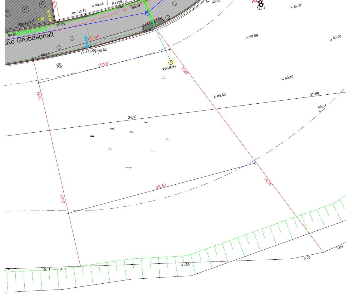

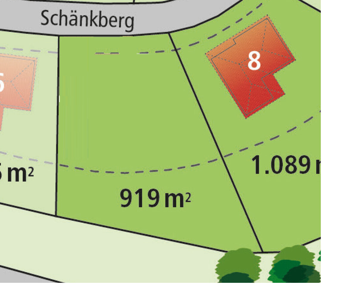

The plot is not rectangular, which makes it difficult to create a simple design as amateurs. The size is 919 m² (9,893 sq ft). The zoning plan and regulations are attached.

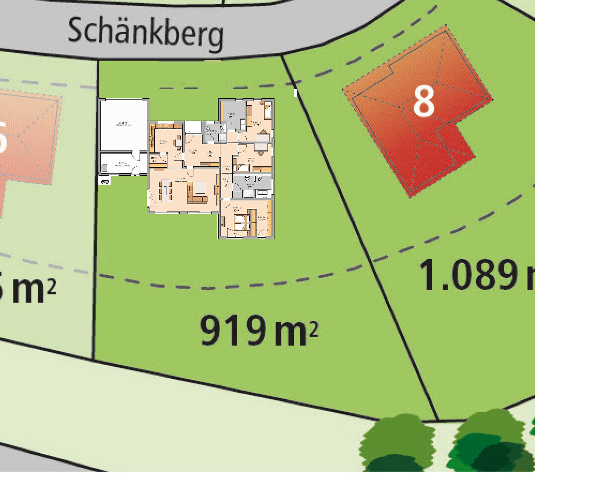

I have also attached an idea for the layout, although the proposed size doesn’t quite fit on the plot.

Have you given the children away, or why don’t they get any rooms anymore? Where is the storage space supposed to be with this floor plan?
A wardrobe for 4 people if the children haven’t been given away?
Regarding option 4: you go straight from the vestibule into the dining room. I wouldn’t like that at all.
If I were forced to build like this, I would probably choose option 1 as well. I think options 2 and 3 are complete junk.

None of the options convince me for three reasons: 1. each one individually does not, 2. there are four of them in total, and 3. yet none of them is two-story. Which professional architect would proceed like this? — probably at most one with very little experience.
There were several versions with very small, narrow, tube-like children's rooms. I did not like any of them. Regarding this point, I found version 3 to be the best.
Then there is the question of cardinal directions. Did I overlook this? If south is at the bottom of the plan, then in most versions the children’s rooms face north.

And how old are the children? If they are no longer very small, do they perhaps prefer to be upstairs (so you could make two rooms on the left and right)? That way, everything else can stay on the lower floor and the layout will be age-appropriate while remaining compact. You could also still fit a storage room in there.

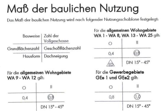

An inquiry with the city revealed that only a bungalow is allowed to be built on this plot (to maintain the uniform appearance of the neighborhood). However, deviations from the roof style (gable or flat roof) are permitted.

An inquiry with the city revealed that only a bungalow is allowed to be built on this plot (to maintain the uniform appearance of the neighborhood), although deviations from the roof style (gable or flat roof) are permitted.Does that mean the zoning plan has not yet come into effect, and the property is still subject to the integration requirement according to §34? – because the zoning plan clearly specifies "II," and verbal side agreements are uncommon in zoning plans. I definitely would not consider building a bungalow without a compelling reason if children are involved.https://www.instagram.com/11antgmxde/
