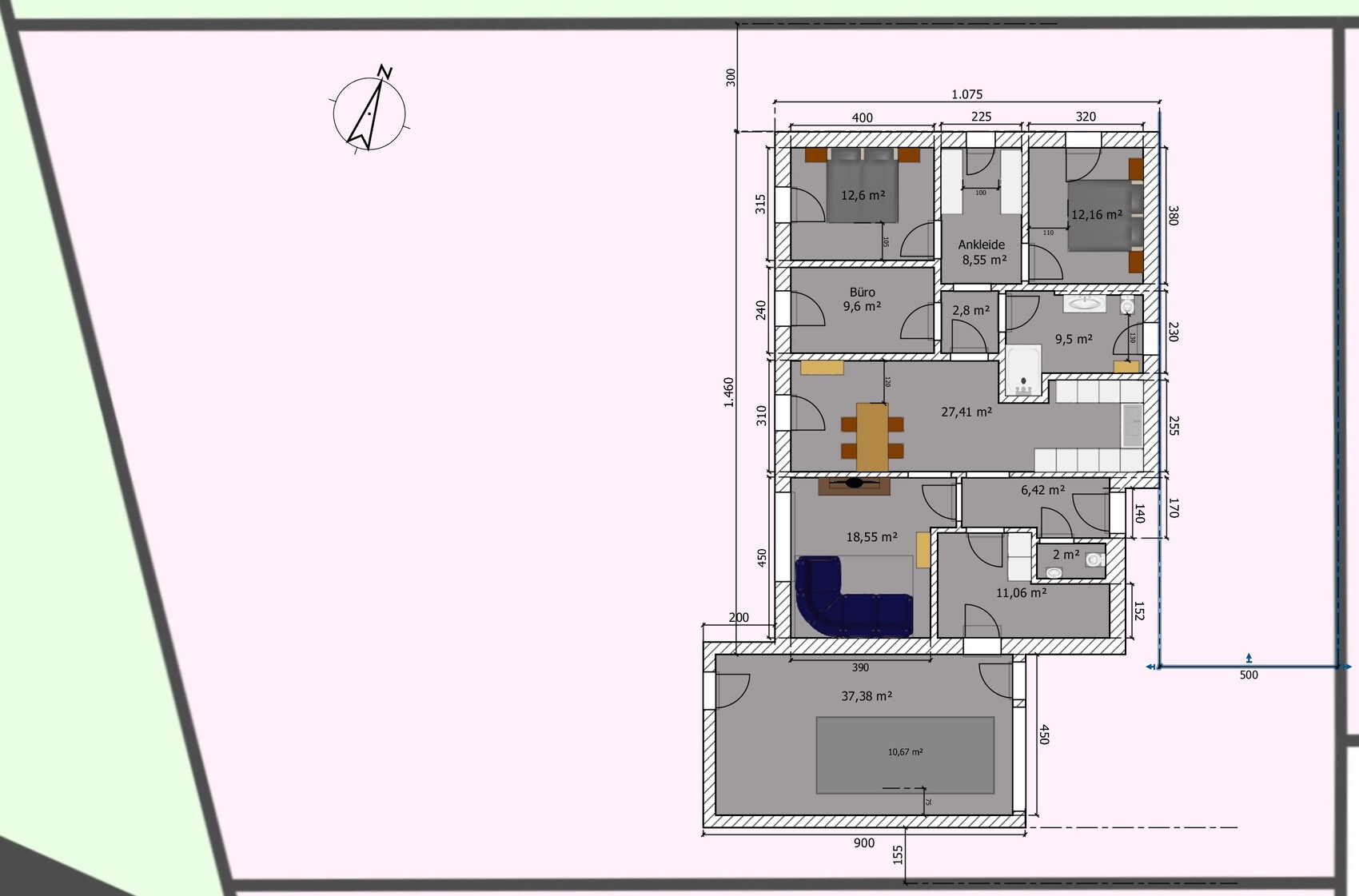

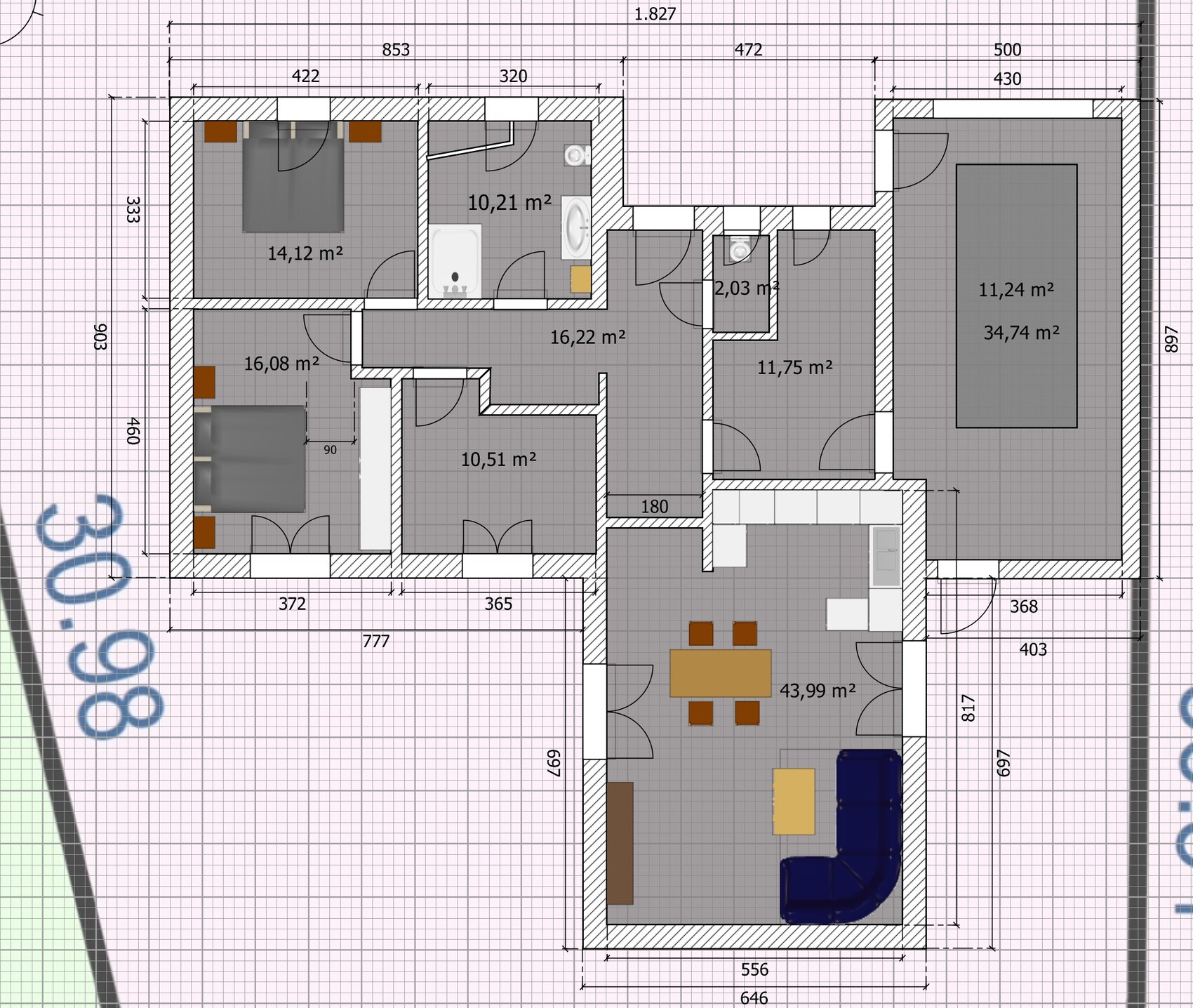

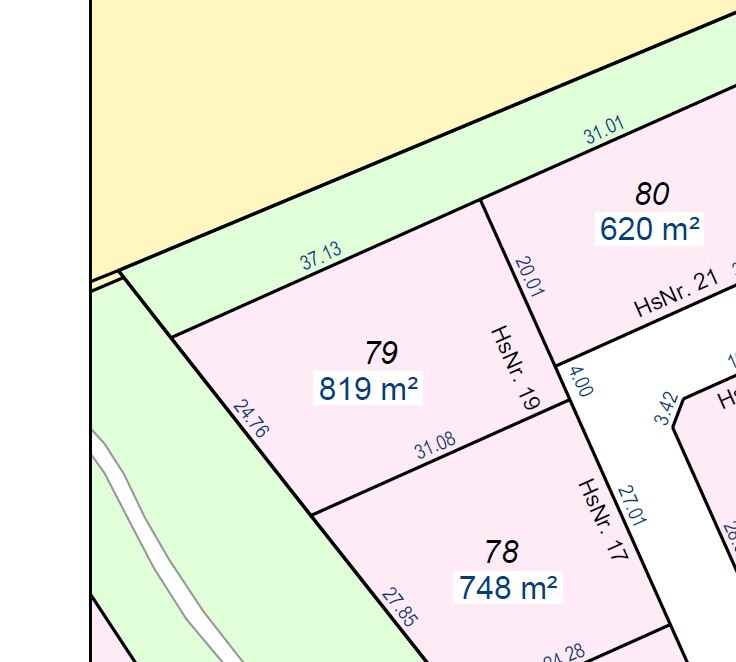

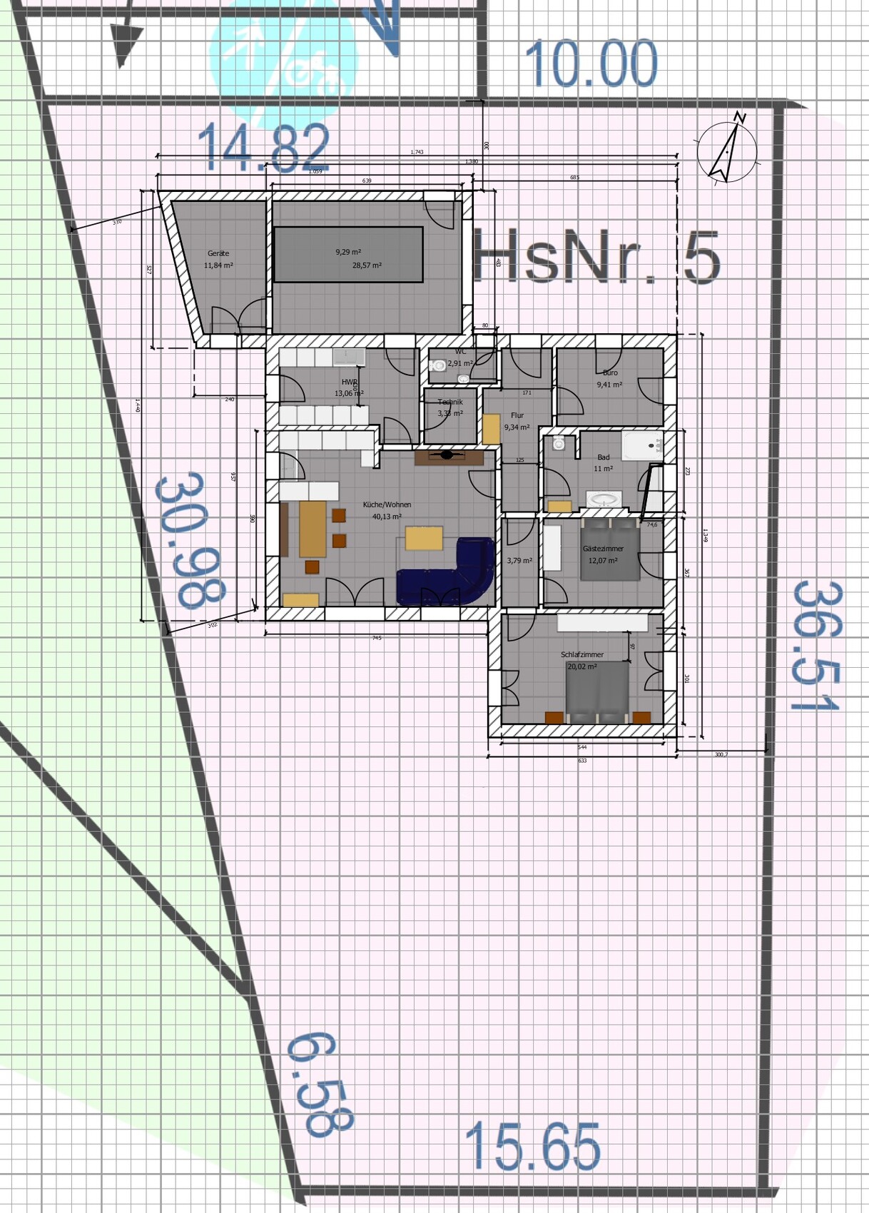

forrestde28 Sep 2024 17:22Hello everyone,

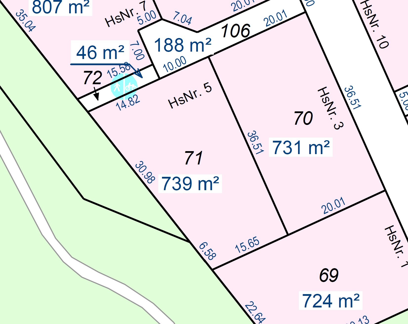

we had the opportunity to change the plot within the same development area because a corner lot at the edge of the field became available again. I continued planning the floor plan and will keep using this thread for that.
In the first image, you can see the plot (the image is oriented north); the driveway is on the east side and 4m (13 feet) wide.

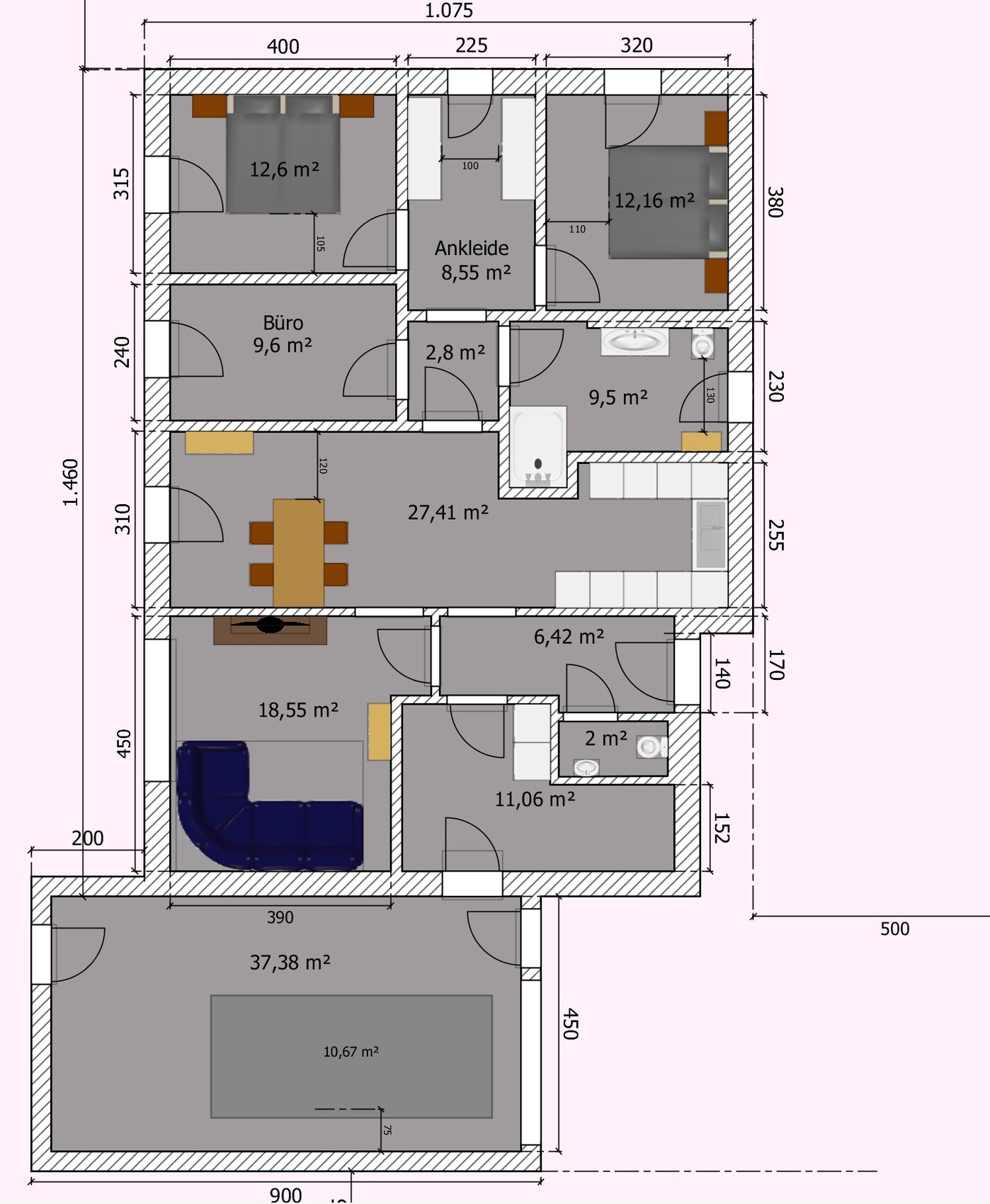

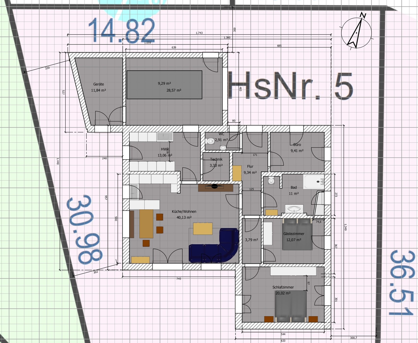

In images 2 and 3, you can see the planned floor plan.
What we like:
- A clear line of sight from the entrance area into the living room and onto the terrace
- Separate dining area
- Living room is also separate (not a walkthrough room)
- Access from the garage to the utility room (because of the dog)
- Shared walk-in closet for both bedrooms. The larger bedroom is the master bedroom, the smaller one is the secondary bedroom or guest room. Currently, the secondary bedroom would be used permanently because one of the gentlemen snores terribly (unfortunately me).
- The design results in about 121 m² (1300 sq ft) of living space, which is good because we want/need to save.
The entrance area with the utility room and guest toilet might still be optimized.
I would appreciate your feedback.
Thanks and best regards
What we like:
forrestde schrieb:
because a corner lot at the edge of the field became available again. Were there problems with the other lot? Why the change? Because of the location by the field? And why can the field location only be guessed at and only glimpsed through one or two windows?
forrestde schrieb:
What we like:
- From the entrance area, a direct line of sight into the living room and onto the terrace
- Living room also separate forrestde schrieb:
From the entrance area, a direct line of sight into the living room and onto the terrace The line of sight you mention isn’t really one, since there is a door in between.
forrestde schrieb:
Living area open, the rest closed Does this explain your change of mind regarding separating the living room and dining area? It does not for me.
Let me put it this way: if you keep going like this, the house build won’t happen next year either. You have been fiddling with your self-drawn bungalow designs for half a year, don’t accept any criticism, keep starting over but with the same mistakes repeated. Have you ever involved a general contractor? Your effort is pointless if a cost-effective builder won’t construct something like this!
Personally, I think the orientation of this lot is much worse than the other one. If the field edge is a plus for you, then I wonder why. There is no sign of the field edge in the design.
Same dilemma as half a year ago: narrow, dark hallway, no cloakroom. Then comes a very long room, 10 meters (33 feet) in length but narrow, getting even narrower at the kitchen. A narrow patio door. 3.10 meters (10 feet 2 inches): that dimension challenges every dining area. Another kind of walk-in closet: over 8 square meters (86 square feet) for 2 wardrobes, the rest taken up by 3 doors.
From wall to wall, the house is dark because there are no south-facing windows.
That’s my feedback, nothing more.
forrestde schrieb:
I continued working on the floor planOh god, why though? ypg schrieb:
Let me put it this way: if you keep going like this, the house construction won’t happen next year either. You’ve been tinkering with your own bungalow designs for half a year, not accepting any criticism, always starting over, but making the same mistakes repeatedly. Have you involved a general contractor yet? Your effort is pointless if a cost-effective builder won’t construct something like that?!
Personally, I find the plot’s orientation much worse than the other one. If the field edge is a plus for you, I wonder why. The design doesn’t incorporate any field edge.
The same dilemma as half a year ago:I can only agree with that. I don’t see any progress here; it’s like Groundhog Day Mk I Release 4.7.11. That’s not a shame if you’re doing something else professionally, but watching you go around in circles is hardly enjoyable. If there was any evolution in the designs, at least you’ve consistently maintained the same spirit. It breathes stagnation.https://www.instagram.com/11antgmxde/
Since we also live in a bungalow, here are some points that can make a bungalow great or seriously spoil it:
- Pay attention to your hallway design! In a bungalow, you often walk through hallways, so they deserve to look attractive.
- The best room layout for a bungalow is usually an L-shape. This way, you separate the living area from the sleeping area.
- Avoid unnecessary doors! They only make the interior darker. That small, pointless door between the living room and bedroom is completely unnecessary! Since the hallway is so narrow, you’ll probably have it removed often because otherwise, you’ll keep hitting the person coming the other way with the door.
- Try to create as few walls and corners as possible. Simple structures are visually pleasant and allow more light.
I find your design quite awful and uninviting. It strongly reminds me of my grandparents’ old farmhouse bungalow.
