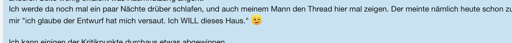

Thank you all for the many opinions.
The main takeaway is that there is quite a lot of hallway space for the overall size. On one hand, this creates a nice, open, and distinctive feel, but on the other hand, it’s not very efficient in terms of space usage.
I’ll sleep on it a few more nights and also show this thread to my husband. He already told me today, “I think this design has spoiled me. I WANT this house.” 😉
I can see the point in some of the criticisms.
I also like the idea of having a slightly larger bathroom and office.
We might even consider dropping the guest room completely. I’d also like to ask the architect of another favorite design to share a floor plan that covers our requirements. Surely someone can come up with a layout that has less hallway space.
The “huge” floor plan here is well thought-out in many areas but also really generous, I admit that.
I wouldn’t heat the garage conventionally. Possibly this hobby room, if that’s even feasible, but the rest is just garage/workshop/storage shed, and I wouldn’t expect those spaces to be heated.
