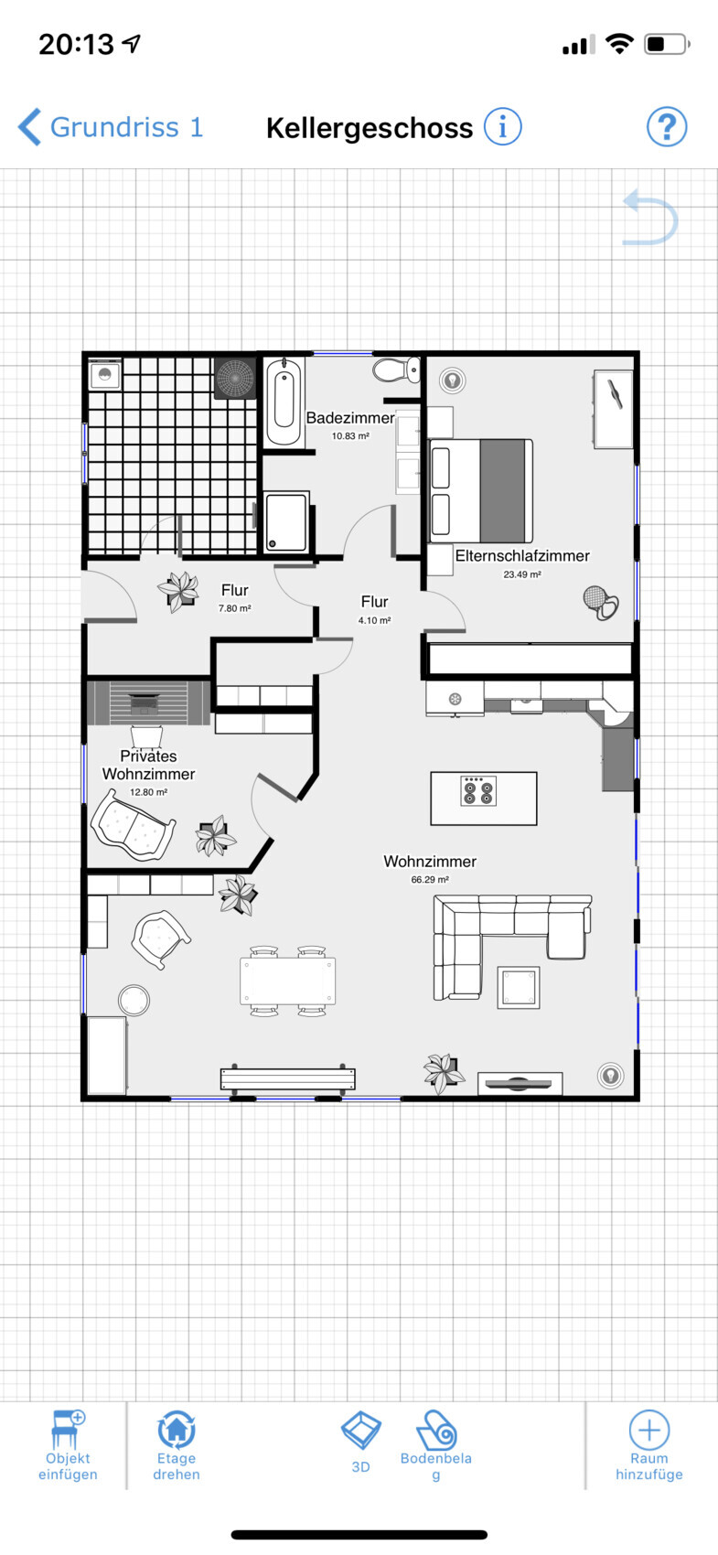

- Bathroom layout: I’d like to set back the shower slightly (see current floor plan) to make the bathroom feel more open/bigger. Somehow it still doesn’t feel quite ideal.
- Window arrangement: Does this make sense to you? Will we get enough light in the living area? The floor-to-ceiling windows to the terrace are on the east side, so only the morning sun comes in there. Are the south-facing windows sufficient?
Is there anything we have overlooked or forgotten? From your perspective, is anything highly unfavorable? Any improvements for the windows? How can the bathroom layout be optimized?

Reluctance schrieb:
I have about 4 meters (13 feet) of bookshelves. I prefer not to place them directly in the line of sight. That's funny, for me it's exactly the opposite: I really enjoy looking at my books and always look for space for bookshelves in floor plans where I can have them in view.R
Reluctance7 Jul 2019 20:22Niloa schrieb:
That’s funny, it’s the exact opposite for me: I really enjoy looking at my books and always look for space for bookshelves in the floor plans where I can keep them in sight.Well, I don’t want to lock them away in a room where no one sees them either. But I’m afraid having them in the immediate line of sight might look cluttered.

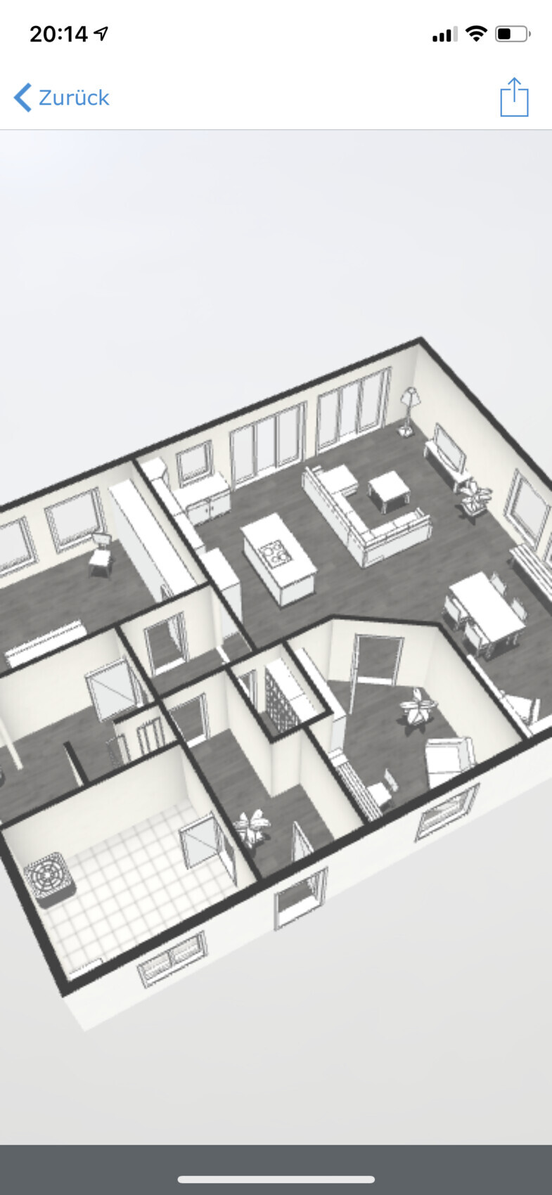

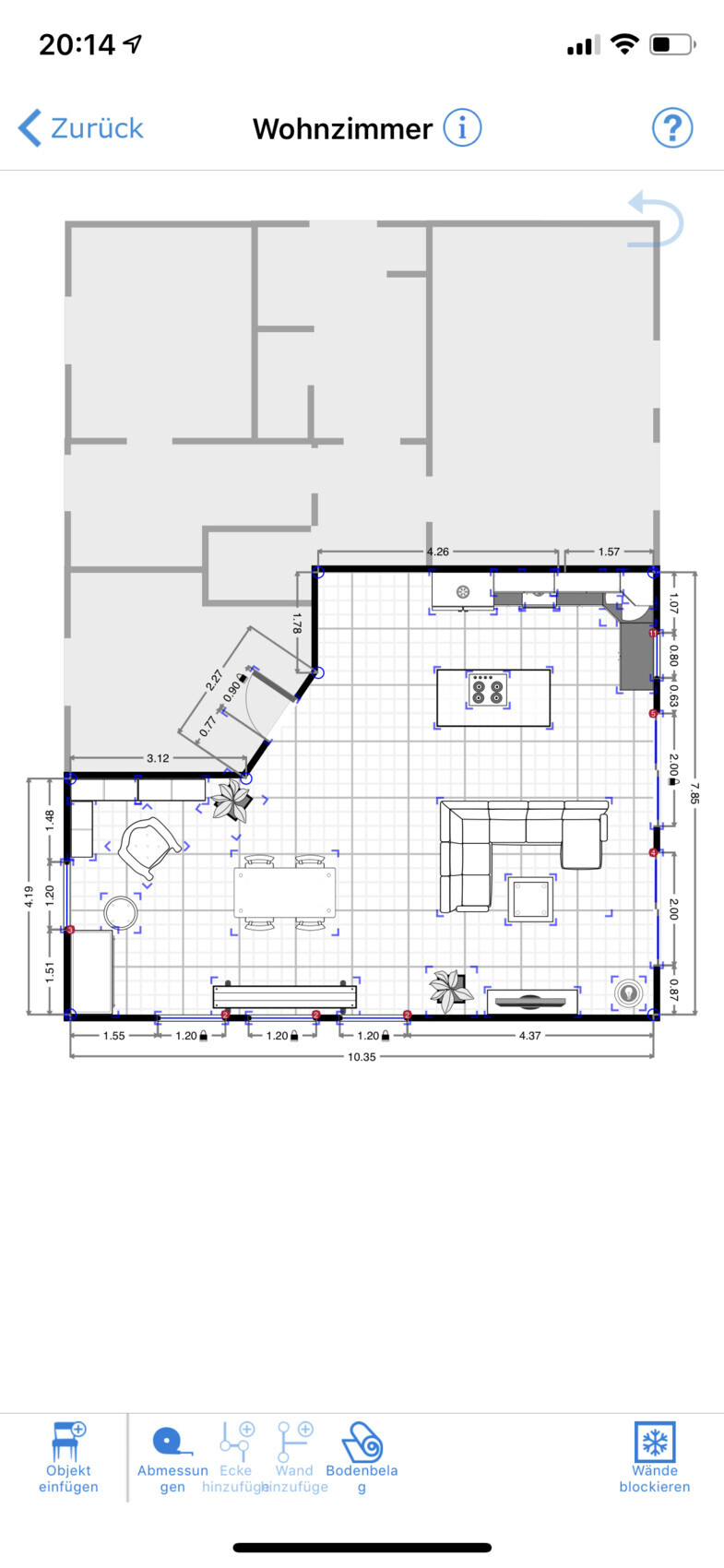

I also dug out my old floor plan app and sketched in some furniture. It’s not perfectly drawn, but somehow it looks to me like it could work… well…
This has already been mentioned, and we don’t know what your dream kitchen looks like, but there is no space for a tall cabinet to accommodate an oven, microwave, or pantry in that area. If you want to experiment a bit, try using the Alno kitchen planner. In my opinion, the kitchen island is also not deep enough.
I don’t like that the sofa is positioned with its back to the kitchen. If one person is watching TV and another is cooking, it would be nicer to face each other, just as an example. I also think it makes more sense for the dining table to be next to the kitchen, rather than having the sofa squeezed in between.

This has already been mentioned, and we don’t know what your dream kitchen looks like, but there’s no space for a tall cabinet for the oven, microwave, pantry, etc. If you want to experiment a bit, try the Alno kitchen planner. In my opinion, the kitchen island isn’t deep enough either. Okay, I’ll check out the kitchen planner. But sorry if this sounds like a silly question: how much space do I actually need for tall cabinets? Theoretically, I could fill the entire wall with tall cabinets if I wanted to (which isn’t necessary). Does that require any special space? I was thinking of a layout like this for the cabinet arrangement (and I’ll probably have even more space on the long wall if I’m estimating the measurements correctly):
Maybe that’s a bit naive and I’m overlooking something important?

I don’t like that the sofa faces away from the kitchen. If one person is watching TV and another is cooking, it would be nicer to be able to see each other, just as an example. I also think it makes more sense for the dining table to be next to the kitchen, not with the sofa in between. Yes, that’s definitely a matter of taste. If I positioned the sofa facing the kitchen, I wouldn’t know where to put the TV and so on.
We probably won’t use the dining table very often. We had one in our current apartment but got rid of it (or converted it into a desk) because we never used it. So maybe it’s okay if it doesn’t play a major role here... There are only two of us anyway...

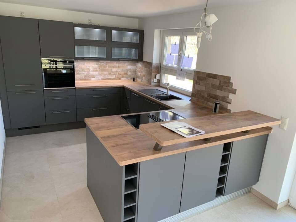

The side with the oven will definitely fit in your layout, but I don’t see a U-shape in your floor plan. We currently have a U-shaped kitchen with 1.80 m (6 feet) between the long sides. In my opinion, it shouldn’t be less than that, as you can easily get in each other’s way. That means 60 cm (24 inches) + 180 cm (6 feet) + 60 cm (24 inches) + I’d estimate another 60 cm (24 inches) = 360 cm (12 feet). At that point, your kitchen will run into the sofa.
If you plan to have a cooking island, the distance should be about 100–120 cm (40–48 inches), and the island should be at least 90 cm (36 inches) deep. If you then plan to add a bar, it will get tight for the chairs again.

The side with the oven will definitely fit, but I don’t see a U-shape in your floor plan. We currently have a U-shaped kitchen with 1.80m (5 ft 11 in) between the long sides. In my opinion, it shouldn’t be any less than that, as you quickly get in each other’s way. So that means 60cm (24 inches) + 180cm (5 ft 11 in) + 60cm (24 inches) + I’d estimate another 60cm (24 inches) = 360cm (12 ft). Then your kitchen would bump into the sofa.
If you’re planning with a kitchen island, the clearance should be about 100–120cm (39–47 inches), and an island should be at least 90cm (35 inches) deep. If you plan to add a bar counter to it, space around the stools will be tight again. Yes, the U-shape won’t work like that, so it will be the island instead... but yes, it will definitely get tight with chairs. I’m worried about that too *sigh*
