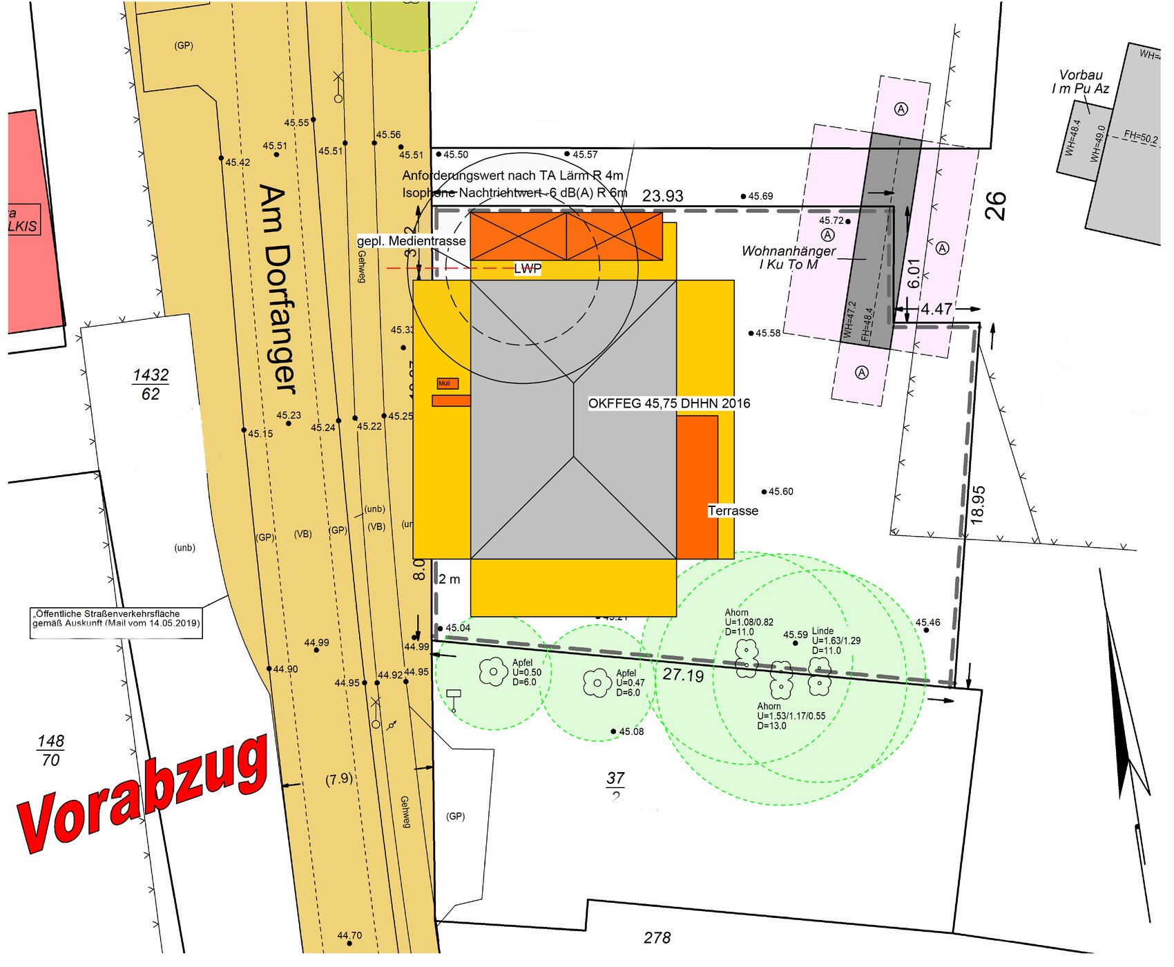

Plot size: 635 sqm (6,839 sq ft)
Floor area ratio (FAR): 0.4
Site occupancy index: 0.3
Roof style: 35° to 45° pitch, hipped roof or gable roof
Distance to front property boundary (street side): max. 3 m (house must remain in current position)

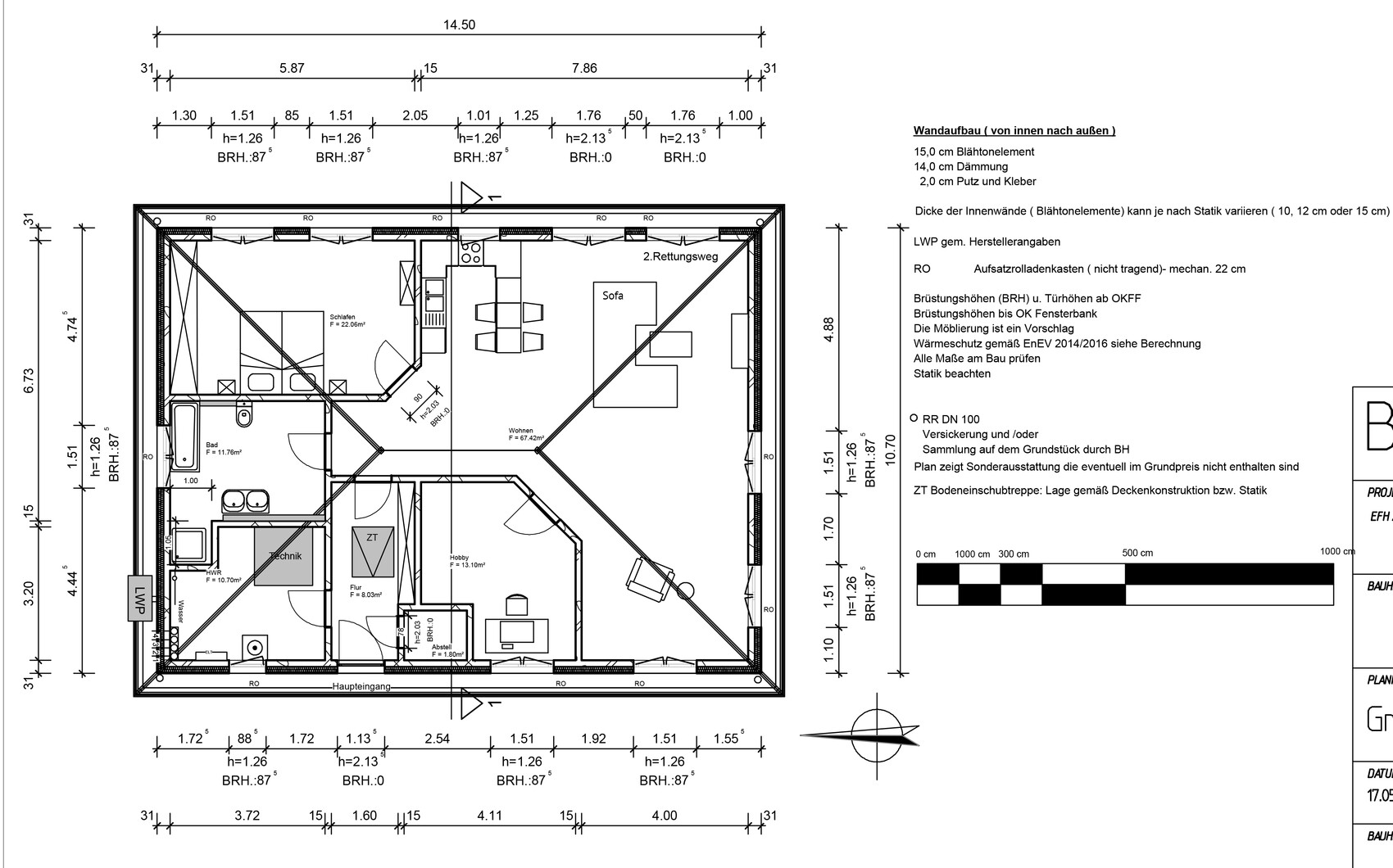

We initially sketched our design on paper, which the designer then realized. Further considerations and discussions with the designer shaped the final result.
Our main goal was a large living space with an open kitchen and a reading nook. Currently (in our present apartment) we have another room with my books (around 1,000) and desk, but I rarely spend time there, as I do everything in the living room. For this reason, we first reduced the number of rooms to enlarge the living area and bedroom (we omitted the walk-in closet to create even more space). The reading nook (located on the west side of the living area) is arranged so it can be separated as a room from the rest of the living room if needed.
We made sure the bedroom faces east to get morning light. We opted out of a guest toilet and instead planned a small storage room for odds and ends (dog supplies like food, leashes, vacuum cleaner, etc.) and made the utility room somewhat larger than the usual 8 sqm (86 sq ft).
Currently, we are still unsure about the following:
- Bathroom layout: I’d like to set back the shower slightly (see current floor plan) to make the bathroom feel more open/bigger. Somehow it still doesn’t feel quite ideal.
- Window arrangement: Does this make sense to you? Will we get enough light in the living area? The floor-to-ceiling windows to the terrace are on the east side, so only the morning sun comes in there. Are the south-facing windows sufficient?
Is there anything we have overlooked or forgotten? From your perspective, is anything highly unfavorable? Any improvements for the windows? How can the bathroom layout be optimized?
By the way, some time ago I created a thread about a 1.5-storey floor plan on the same plot. At that time, we ultimately decided to build a bungalow – which we are now doing. Hence, this new thread…
Best regards and thanks in advance.

Don’t you have an architect or general contractor to help you with this? Surely not the forum for such final decisions! Well, we have a planner (from the general contractor) – but for example, after my last request for recommendations, they installed 1m (3.3 ft) windows everywhere to comply with the “vertical format” required by the regulations. So that doesn’t really help me. I will send them our proposals again tonight and ask for recommendations once more – maybe something will come of it.

Reluctance30 Jun 2019 14:28A brief note on the topic of "lintels": my question is not related to building regulations. It concerns the fact that our floor-to-ceiling windows are currently planned by the general contractor with a height of 2.13m (7 feet). With a room height of 2.56m (8 feet 5 inches), this results in a lintel height of 43cm (17 inches). This seems quite large to me, and I’m wondering if I should ask the designer to increase the window height to, for example, 2.20m (7 feet 3 inches).
Reluctance schrieb:
that our floor-to-ceiling windows are currently planned by the general contractor with a height of 2.13 meters (7 feet).For whatever reason: tripping edge at the bottom and top.
Honestly, I can’t imagine that he would install different lintel heights. It complicates the construction, and such special features are only planned if requested.
