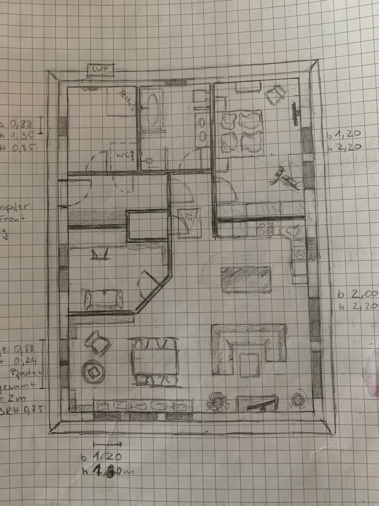

Draw all the furniture to scale as you want it.
We have 10 meters (33 feet) for cooking, dining, and living. The extra half meter (about 1.5 feet) I wanted is missing significantly.
Your living area currently feels like a kitchenette in a holiday apartment, with a tiny table for two, a small seating area, and an unused dance hall around the corner.
There is space for more. Move the living area into the dance hall, and you’ll have a decent kitchen and room for a table near the kitchen.
For this, the windows need to be changed.

Take your plan, check the scale, draw your desired furniture to scale on a sheet of paper, cut them out, and place them on your plan. This way, you’ll get a sense of the available space and where everything could fit.

I can only recommend that you follow the advice regarding the layout for furniture. For example, I also consider the kitchen to be critical. This is important for the building permit / planning permission because realistic furniture arrangements might still lead to adjustments in window placements or changes in window sizes.

The entire room is only about 4.50 x 2.30 m (15 x 7.5 ft) or so (I would need to measure again)... that’s the size I can refer to. And I’m happy that it will be bigger in the future.
Have you calculated how many cabinets you need, including the sink area and stove? Keep in mind that the amount of stuff usually increases over time rather than decreases.
Reluctance schrieb:
It’s also annoying to have to deal with that later... so I just sketch it out myself on paper and leave the planner’s drawing incomplete.
So you’ve already drawn something? Please share it.

I do recognize the space issue regarding the kitchen and living room. Ultimately, I still somewhat want to keep the current layout because:
I have about 4 meters (13 feet) of bookshelves. I’d rather not place them directly in the main view (but I also don’t want a separate room for them—since I would never use it). That’s why the dance hall is intended for those books, seating areas, and places to put my laptop and such.
I prefer the living room not to face the street, but rather the garden. So swapping the “dance hall” with the living room is not my first choice.
What might make more sense is swapping the kitchen and the dance hall. But then I’d be the first to enter into the clutter of books and would have to walk through the entire apartment with my groceries to get to the kitchen. I’d have to move the entrance. Then again, we would lose the connection from the hobby room to the living room, which would also be a shame.
This is why the floor plan is the way it is now. Right now, to me, it feels like none of this will work at all. That worries me a bit—the planner wants to forward the floor plan to the surveyor tomorrow...
About the holiday-home-style kitchen: The kitchen shown in the planner’s floor plan is not accurate. I don’t know how big such a kitchen should be for ‘normal’ people; we cook about once or twice a week. We just need a reasonable amount of workspace and the necessary appliances. Regarding kitchen utensils, I’m quite minimalist—I don’t keep anything unnecessary. I hope that a 6-meter (20 feet) length can fit quite a bit, possibly with an island or something similar.
kbt09 schrieb:
I can only recommend that you take the advice about including furniture layouts seriously. I also see the kitchen as critical. For the building permit (planning permission), this is important because realistic furnishing might still require adjusting window locations or sizes.
Our latest drawing is attached... maybe you can spot something there. The window sizes on the west side are no longer 100% correct; a double casement window wasn’t possible due to regulations, but that shouldn’t make a difference...
There is now a 1 by 2 meter (3 by 6 feet) island drawn in the kitchen—it could also be a table. We are basically open to either, depending on what fits better. We haven’t started detailed kitchen planning yet, and an island is not exactly inexpensive.
