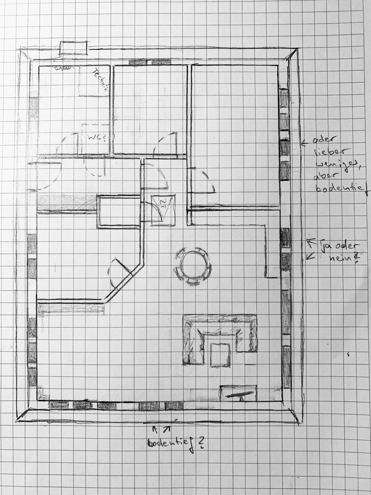

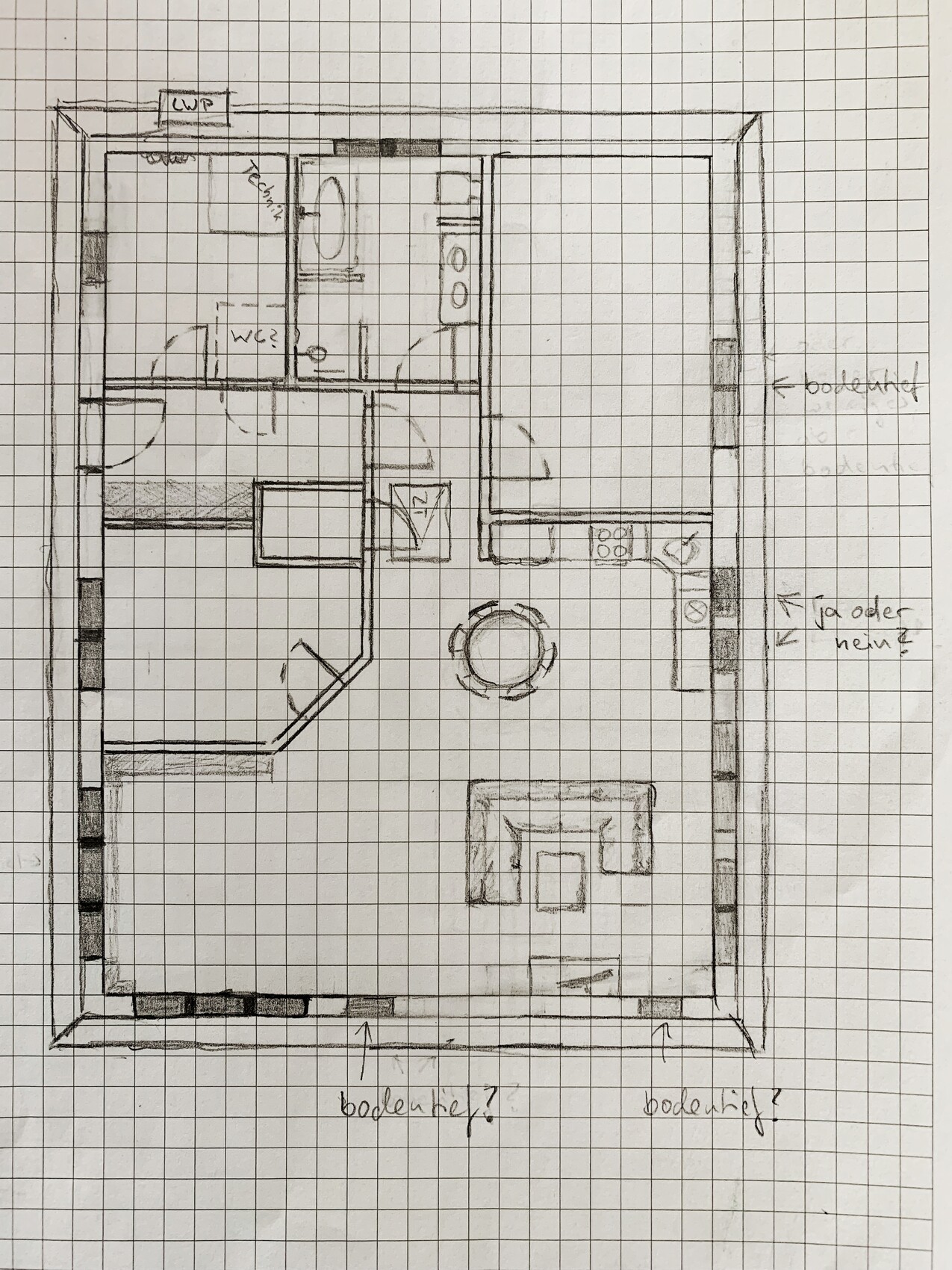

We initially sketched our design on paper, which the designer then realized. Further considerations and discussions with the designer shaped the final result.
Our main goal was a large living space with an open kitchen and a reading nook. Currently (in our present apartment) we have another room with my books (around 1,000) and desk, but I rarely spend time there, as I do everything in the living room. For this reason, we first reduced the number of rooms to enlarge the living area and bedroom (we omitted the walk-in closet to create even more space). The reading nook (located on the west side of the living area) is arranged so it can be separated as a room from the rest of the living room if needed.
We made sure the bedroom faces east to get morning light. We opted out of a guest toilet and instead planned a small storage room for odds and ends (dog supplies like food, leashes, vacuum cleaner, etc.) and made the utility room somewhat larger than the usual 8 sqm (86 sq ft).

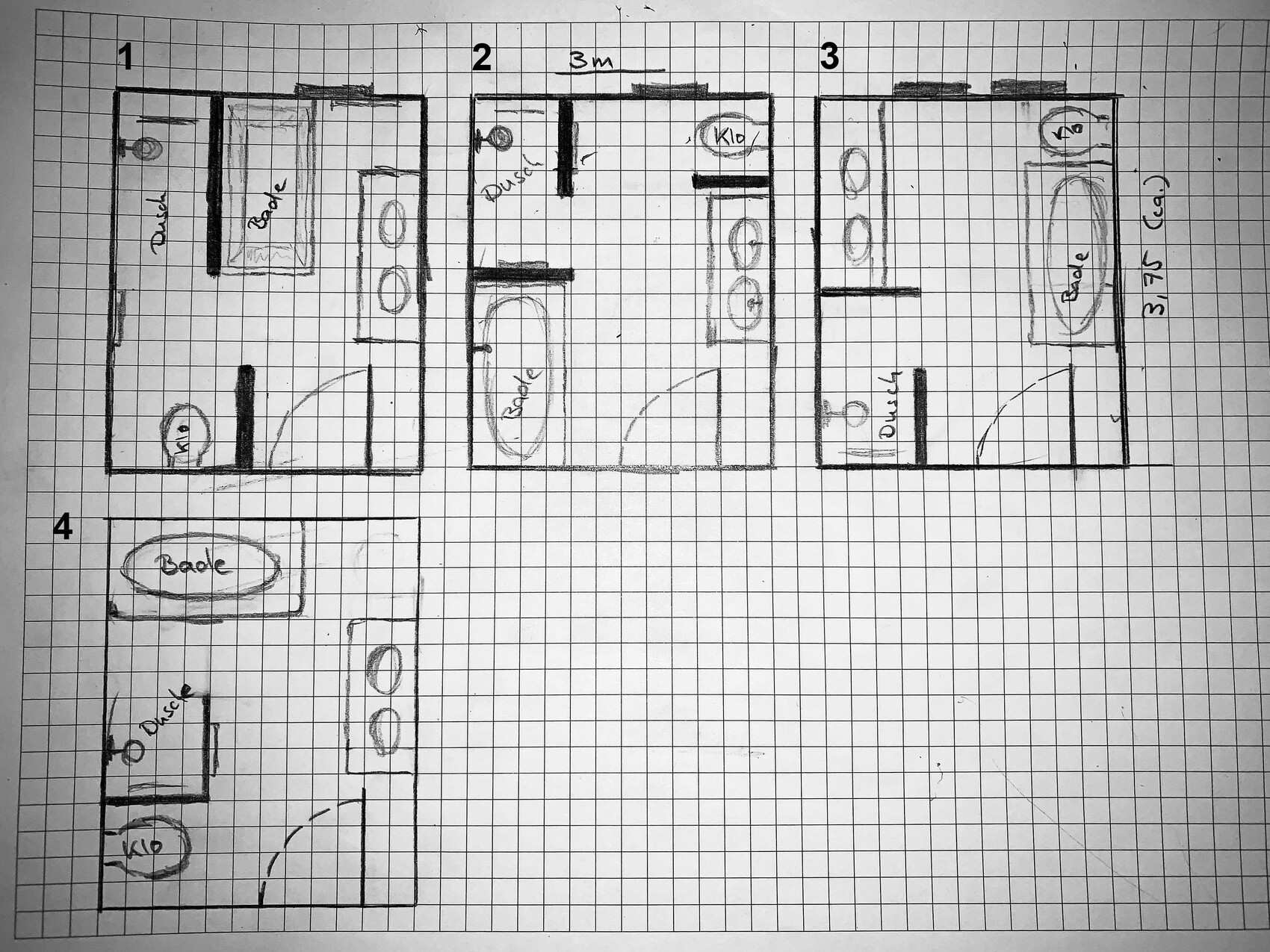

- Bathroom layout: I’d like to set back the shower slightly (see current floor plan) to make the bathroom feel more open/bigger. Somehow it still doesn’t feel quite ideal.

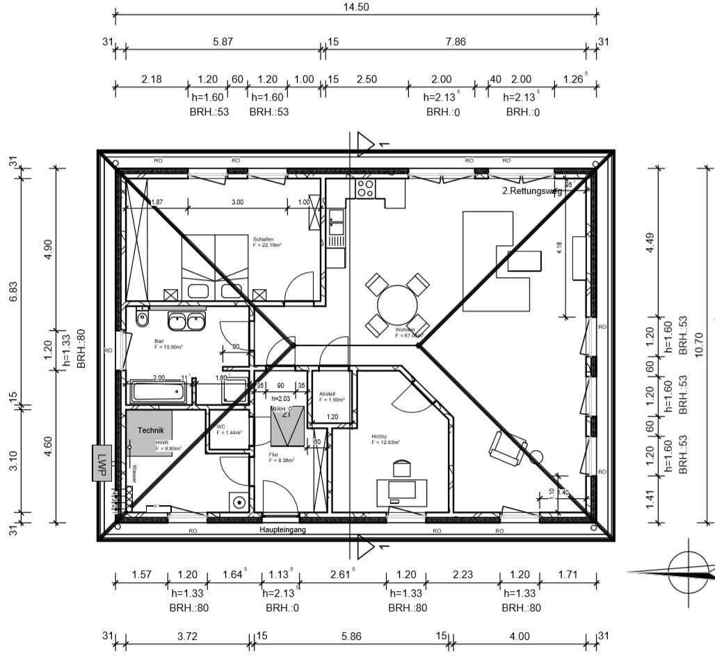

- Window arrangement: Does this make sense to you? Will we get enough light in the living area? The floor-to-ceiling windows to the terrace are on the east side, so only the morning sun comes in there. Are the south-facing windows sufficient?
Is there anything we have overlooked or forgotten? From your perspective, is anything highly unfavorable? Any improvements for the windows? How can the bathroom layout be optimized?

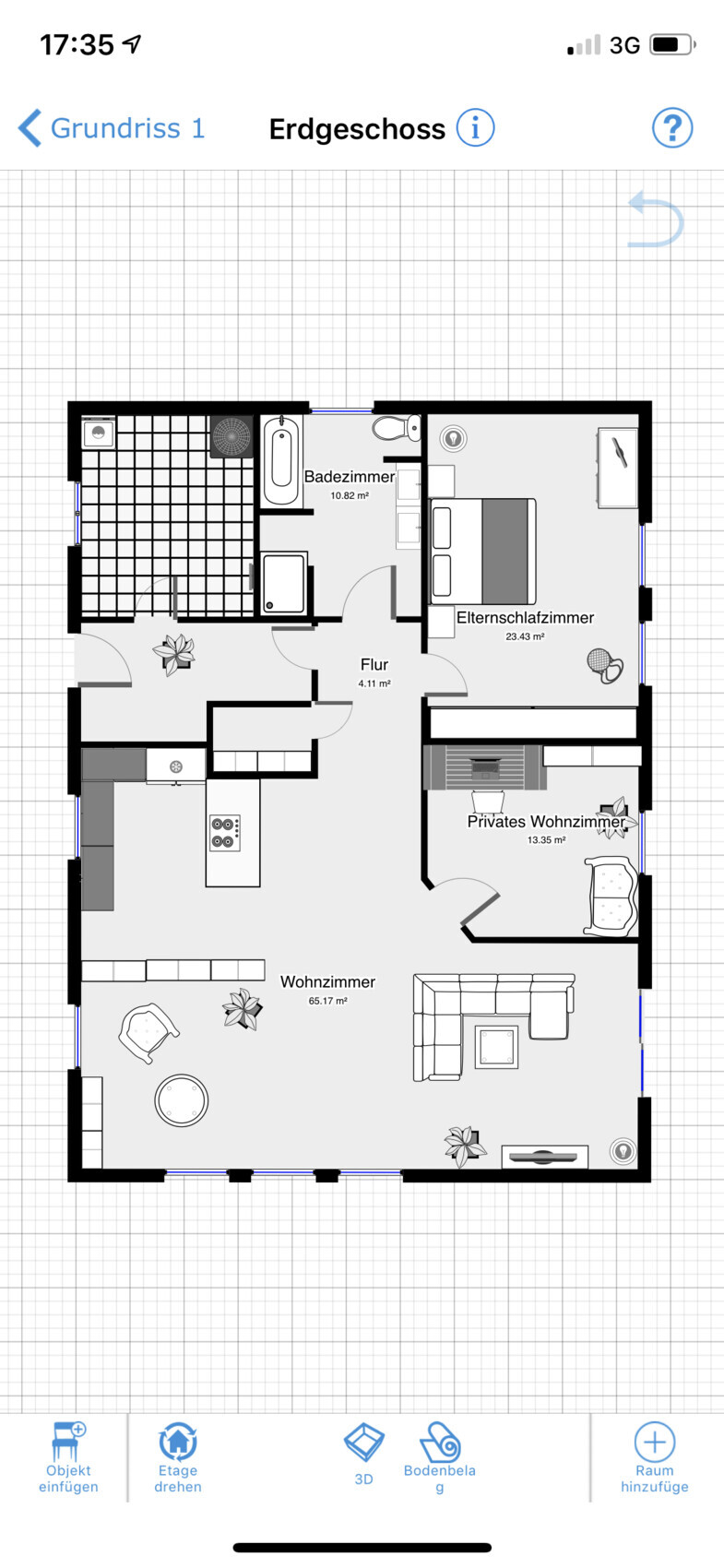

-> Swap the hobby room with the kitchen.
You can fit great tall cabinets and a kitchen corner unit in the niche created by the storage room. In front, there would be a round 80cm (31.5 inches) table that can be extended or a table placed against the wall next to the storage room.
The man’s gaming room opposite with the angled wall as desired.
The kitchen is, of course, semi-open. I tried to sketch this out. Yes, it definitely makes the kitchen feel more spacious, but doesn’t that make the living room a bit more cramped? And isn’t it a pity that 70–80 percent of the living area faces the street rather than the garden?
Reluctance schrieb:
Isn’t it a shame that 70-80 percent of the living area faces the street, instead of the garden?If you rarely use the kitchen anyway and spend more time on the sofa, then it works. I don’t really like the angled wall; how about a corner sliding door instead? This way, the area can be separated or the living room can be enlarged. That’s how I imagine it, of course other styles are also possible.

Reluctance8 Jul 2019 18:15Niloa schrieb:
I’m not a fan of the slanted wall. How about a corner sliding door instead? That way, you can either separate the area or enlarge the living room. That’s how I imagine it, but of course, the style can be different.
[ATTACH alt="Bungalow-135sqm-floorplan-windows-333733-1.jpg"]36273[/ATTACH] I really like sliding and hinged doors too... if I ever have some extra money, I’ll have something like that installed somewhere. But for now, probably not yet. Even my patio doors aren’t sliding doors... you have to prioritize after all...
