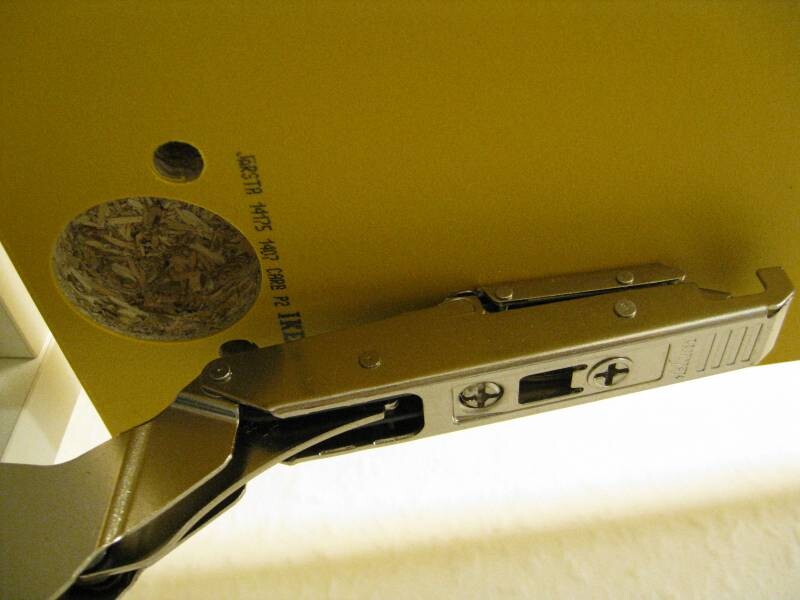

20 Jul 2014 22:56
I took a photo of my hatch. The bracket for the hatch fitting is far away from all the drill holes:
