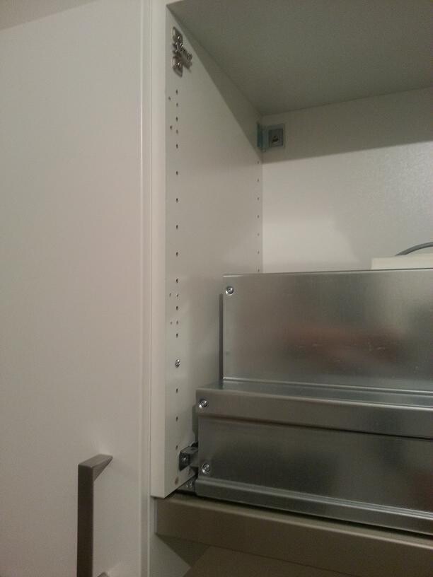

Why it doesn’t work in the original position is clearly visible here:
Ignore the bottom hole; that was for the base panel. The two above are for the hinges, but with the metal strip for the extractor fan, it just doesn’t quite fit.

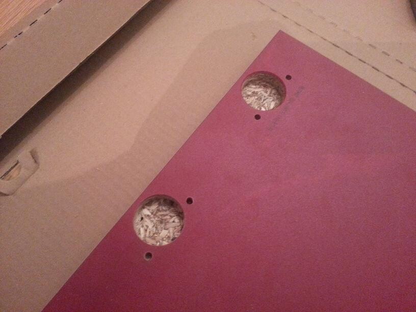

I think the drilling turned out really well:
I couldn’t even tell it’s not original if it weren’t obvious 🙂

IKEA-Experte20 Mar 2014 20:11In the picture, the two small holes appear slightly misaligned, but this is probably just an optical illusion. Using a straight mounting plate instead of the cross-shaped one would likely have avoided the need for a new hole drill, but the main thing is that it works. Since the air above the stove is also a bit more humid when cooking, even with an extractor hood, I would tape over the open hole to prevent any swelling over time.
Z
zetterberg21 Mar 2014 07:38Just use waterproof wood glue or silicone; it also works for countertops around cutouts.
I
IKEA-Experte21 Mar 2014 10:20If you seal the surfaces with silicone, you might also be able to add a cover cap, which you can get from customer service. Otherwise, a piece of aluminum adhesive tape, decorative foil, or anything that is vapor-tight will do.
