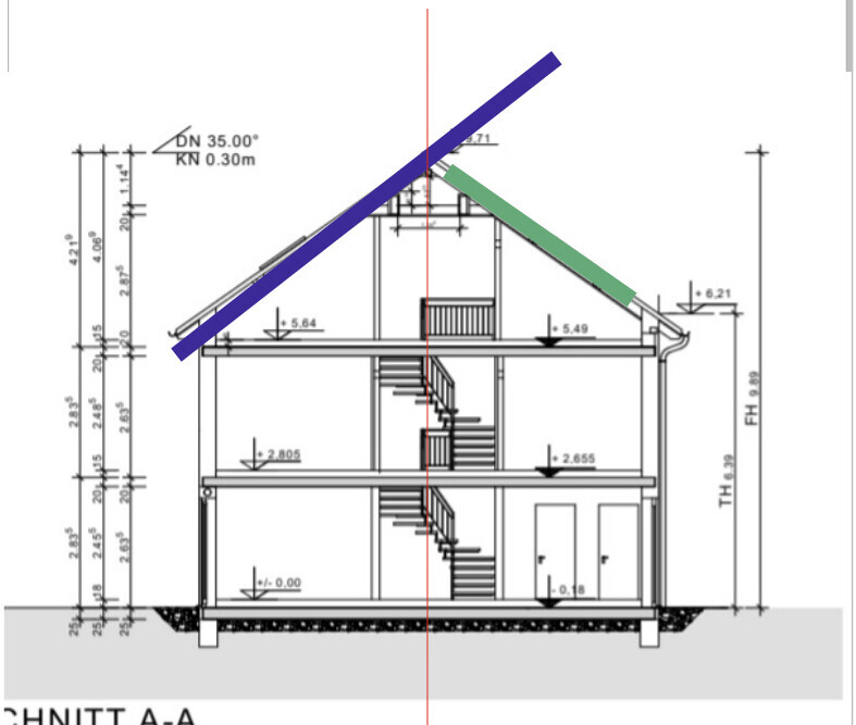

Hello dear forum members,
we are building an end-terrace house measuring 7 by 10 m (23 by 33 ft) without a basement. It will have 2 full floors and an attic above. Now the question is which roof we should have. I was shown a house with a 38-degree gable roof without a knee wall, which I found very nice in terms of the feeling of space. Now we have been informed that only a 35-degree gable roof is allowed for us, but with a 30 cm (12 inches) knee wall. What I didn’t realize was that our attic has a maximum height of only 63 cm (25 inches). So the attic space is very low. Now I have no basement and hardly any storage space and I’m a bit frustrated because the building permit application is now in front of me. I initially agreed that this was okay, but I would prefer a 1 m (3 ft) knee wall. The development plan only allows a maximum of 30 cm (12 inches). I’m really unsure what to choose... I don’t want to spend unnecessary money if it doesn’t make a big difference since we have a very large plot and can build storage in the garage, barn, or garden house...

A. 38-degree gable roof or
B. 35-degree gable roof with 30 cm (12 inches) knee wall or
C. 35-degree gable roof with 1 m (3 ft) knee wall, applying to the city office...
We would need to submit a request to the building authority to increase the knee wall to 1 m (3 ft), which would mean more effort, bureaucracy, and delays... I don’t know what it would cost or if it’s even possible, but it’s weighing on my mind because I only read online about people who built houses with a knee wall on the attic. The extra cost of $3,000–$5,000, if that’s roughly the amount, would be worth it to me if it creates nicer rooms and I get a higher attic for storage.
The second problem is that the plot is much lower than street level. We are paying an extra €10,000 to fill the plot with gravel up to street level. Now the house will be built just slightly above street level, so there will be a step at the entrance. There will be a total of 3 terraced houses, and we have the end house. In our row, two finished terraced houses from other builders are already standing next to ours. However, these are built 1 m (3 ft) above street level with 3 or 4 steps higher, so they probably look taller overall. I find this visually unappealing and also, personally, I want our house to be higher.
What are your thoughts on this?
I’m also uploading my floor plan, which I think is finished. I don’t understand how high the ceilings are; can someone tell from the plans? Inside the rooms, how high are they? And generally, do you notice anything about the floor plan?
My building permit application is ready, but I want to change it after all. It doesn’t suit me, and I’m sure it will cause trouble with the company if they have to make changes for us, but I want to be able to decide again and just need some feedback here.
Looking forward to your support!

Just sketch it out for yourself.
As I understand it, the options are a 35° roof pitch with a 30 cm (12 inch) knee wall, or a 38° pitch without a knee wall.
And by attic, you mean that small loft space, right? It will be almost identical in both versions... see
Blue = 38° with 0 cm (0 inch) knee wall
Red = Centerline
Green = 35° to simply highlight the drawing line as well.
Regarding roof height, taller knee wall, etc... you just have to check whether that will be approved. I still don’t understand how the houses right next to yours were built. Because they are crucial for this.

Bauherrin12323 Aug 2022 23:26kbt09 schrieb:
Just draw it out for yourself.
As I understand it, the options are 35° with a 30cm (12 inches) knee wall or 38° without a knee wall.
And by attic, you mean just that small loft space ... right? It’s almost the same in both versions ... see
Blue = 38° with 0cm (0 inches) knee wall
Red = Center line
Green = 35°, just to clarify the drawing line as well.
And regarding roof height, higher knee wall, etc. ... you’ll have to check whether that will be approved. I still don’t understand how the houses directly in your row are built since they are decisive.Thank you very much. So,... in my row, it’s like this: my developer is building 3 houses: A, B, and C. House C is ours, the end house. In this row, there are already 2 houses from another developer, where house A from our row will border.
It will be like this: House XA (different developer), XB (different developer), then our houses A and B, and finally ours at the end. The XA and XB houses have basements and are much taller, I think about 2m (6.5 feet) higher than ours. Ours will be built without basements at street level, while the others are 1m (3.3 feet) above street level.
Yes, what bothers me is that the loft space becomes much smaller. According to your drawing and also the construction company, not much changes,... but I’ll show you a plan from an acquaintance, he has a 38° roof and 110cm (43 inches) attic height. Can you explain how that works? I’ll upload his plan and mine...
He measured his attic height today at 38°,... it is much higher than ours... I thought 3 degrees wouldn’t make much difference, but apparently it does.
