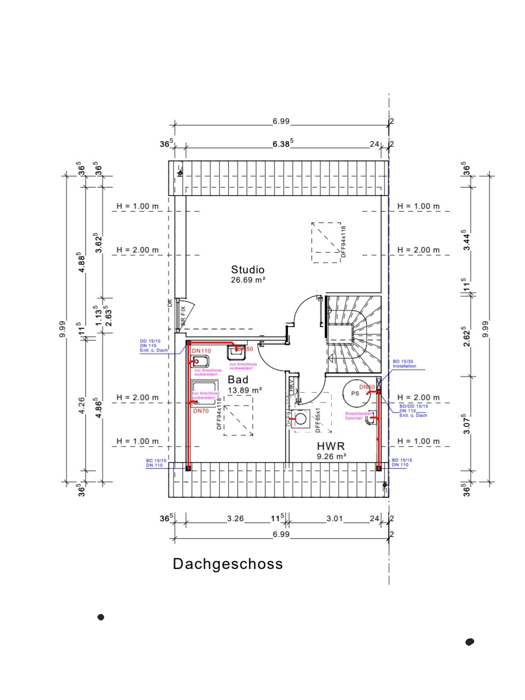

I’m also uploading my floor plan, which I think is finished. I don’t understand how high the ceilings are; can someone tell from the plans? Inside the rooms, how high are they? And generally, do you notice anything about the floor plan?

K a t j a23 Aug 2022 11:37
In addition to #83
In the attic, you can now create a bit more space for the studio:
Floor plan attic with studio, bathroom, utility room, stairs, and dimensions.
23 Aug 2022 12:13
evelinoz schrieb:
The kitchen is unnecessarily wide, the wardrobe is missing, better like this
[ATTACH alt="bauherrin123.jpg"]74149[/ATTACH] [ATTACH alt="grundriss-reiheneckhaus-in-planung-aenderungsvorschlaege-591336-2.png"]74151[/ATTACH]
and this is the rest at the top of the plan, 2m (6.6 ft) from the niche corner, 1 small square equals 10cm (4 inches)
