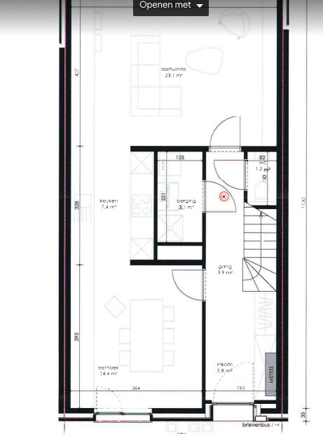

I’m also uploading my floor plan, which I think is finished. I don’t understand how high the ceilings are; can someone tell from the plans? Inside the rooms, how high are they? And generally, do you notice anything about the floor plan?
My building permit application is ready, but I want to change it after all. It doesn’t suit me, and I’m sure it will cause trouble with the company if they have to make changes for us, but I want to be able to decide again and just need some feedback here.

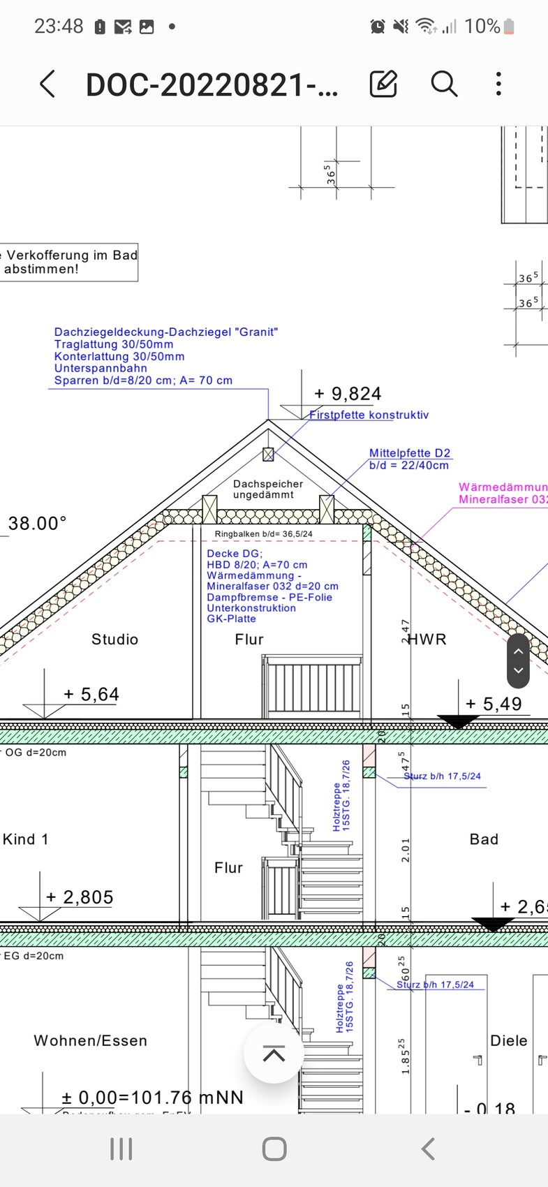

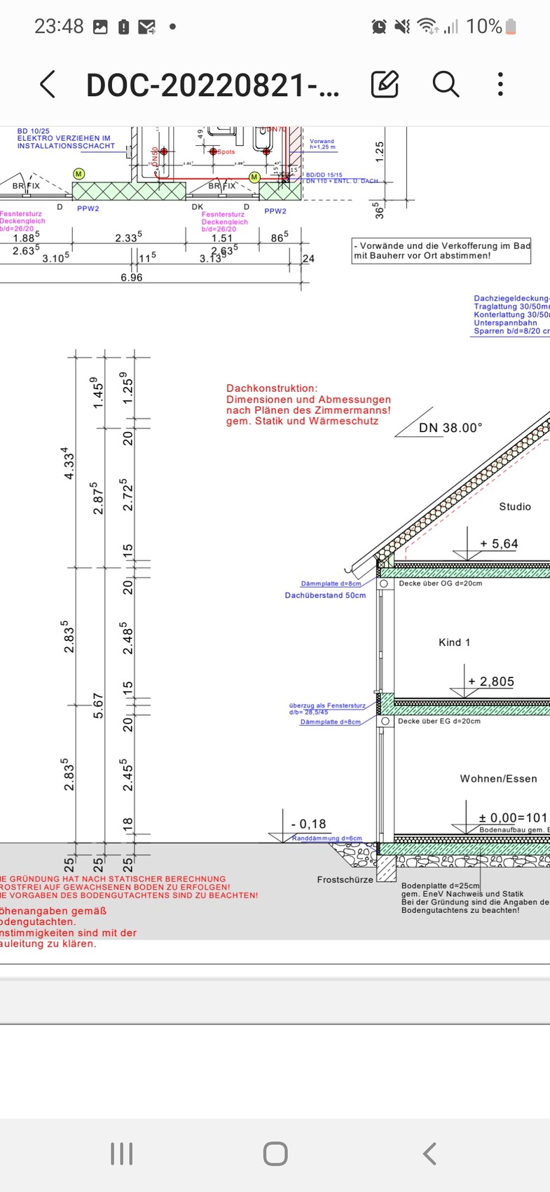

Bauherrin12323 Oct 2022 23:54This is the house of an acquaintance. I am supposed to get the same design, just with a slightly different roof pitch... he has 38 degrees, I have 35 degrees plus a 30cm (12 inches) knee wall. Otherwise, the ceilings should be the same height everywhere, right? I don’t understand why the acquaintance has an attic space with a height of 120cm (47 inches), but it’s not possible for me... I visited his house, he measured it... I will also ask him about the ceiling heights in the basement and upper floor... according to the plans, we have the same heights... I thought they were acceptable, and we can’t change them anyway.
The house is 10 cm (4 inches) taller, and I don’t see 120 cm (47 inches) at the attic peak; I’m not sure where you got that number from.
You should take a few minutes to carefully understand all these height measurements.

Bauherrin12324 Oct 2022 00:13Regarding the storage height, it was measured on site, and it is 120cm (47 inches) high. He measured it three times for us. According to the plan, it doesn't have this height, but on site, it does.
