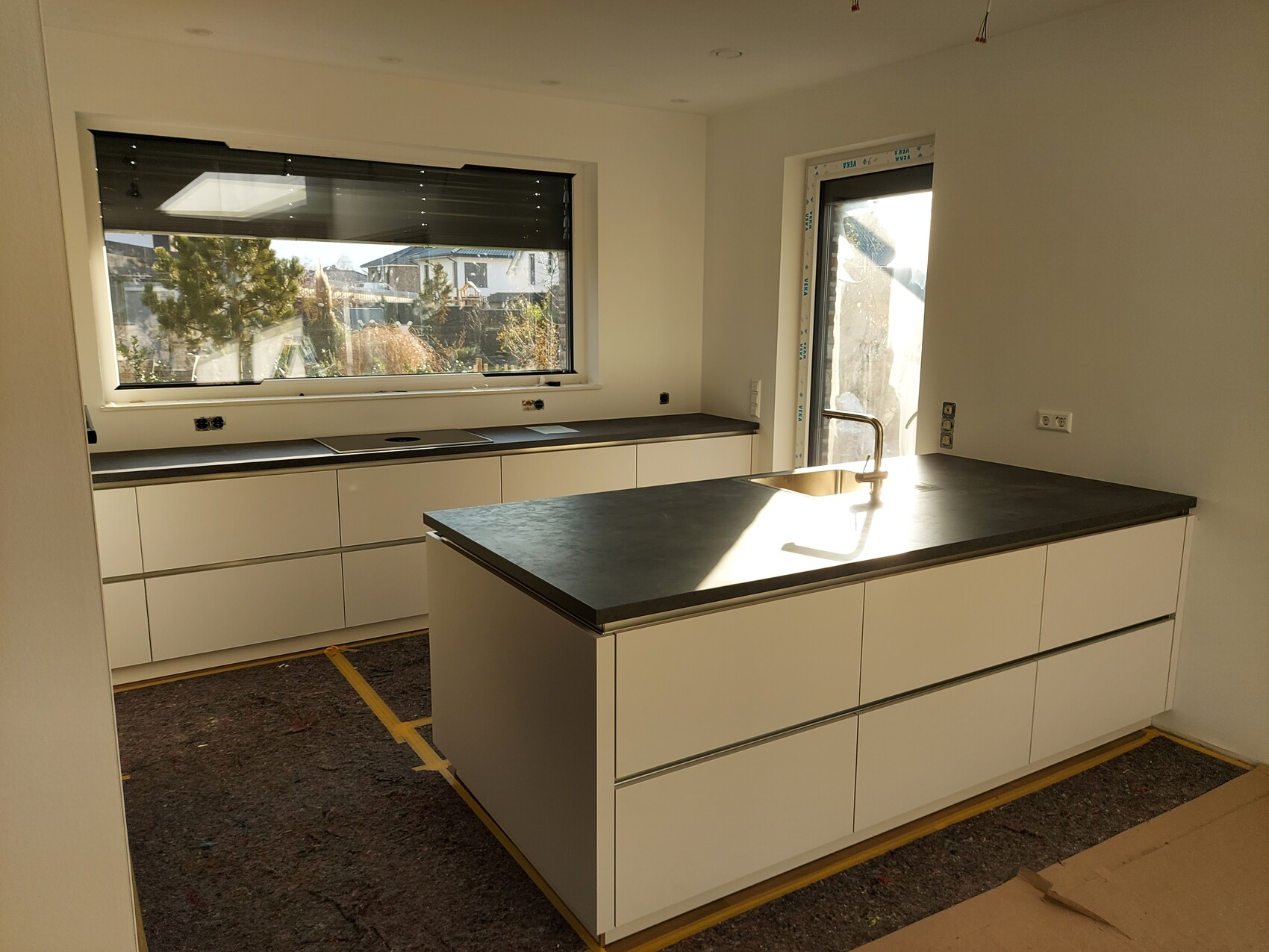

We have 112cm (44 inches). The window is a fixed pane measuring 1.4 × 2.5m (4 ft 7 in × 8 ft 2 in). Additionally, there is an 8cm (3 inches) frame. I wouldn’t go any smaller; otherwise, it will be tight with the electrical outlets.
From the top edge of the countertop (92cm / 36 inches) to the bottom edge of the window sill, it’s 19cm (7.5 inches).
Weiße Küche mit Insel, dunkler Arbeitsplatte und Spüle in Bauphase.

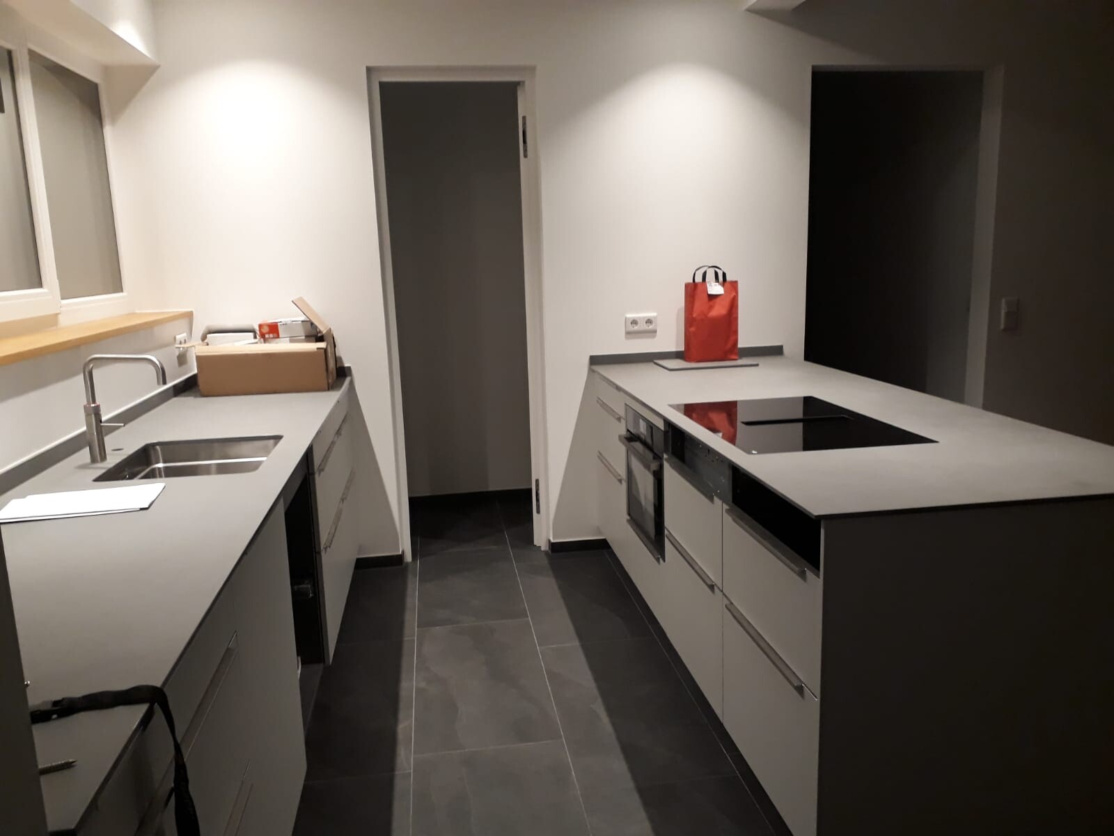

I don’t like countertops that run into the window recess, so we did it almost the same way as @AMNE3IA: 2.5 m wide (fixed glazing on the outside, with an opening in the middle), 1 m high, sill height 1.23 m (4 ft).
Photo from the construction phase:
Modern kitchen with gray countertops, sink, induction cooktop and oven; red bag.
