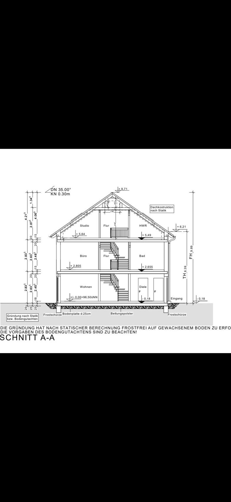

Hello dear forum members,
we are building an end-terrace house measuring 7 by 10 m (23 by 33 ft) without a basement. It will have 2 full floors and an attic above. Now the question is which roof we should have. I was shown a house with a 38-degree gable roof without a knee wall, which I found very nice in terms of the feeling of space. Now we have been informed that only a 35-degree gable roof is allowed for us, but with a 30 cm (12 inches) knee wall. What I didn’t realize was that our attic has a maximum height of only 63 cm (25 inches). So the attic space is very low. Now I have no basement and hardly any storage space and I’m a bit frustrated because the building permit application is now in front of me. I initially agreed that this was okay, but I would prefer a 1 m (3 ft) knee wall. The development plan only allows a maximum of 30 cm (12 inches). I’m really unsure what to choose... I don’t want to spend unnecessary money if it doesn’t make a big difference since we have a very large plot and can build storage in the garage, barn, or garden house...
What would you do?
A. 38-degree gable roof or
B. 35-degree gable roof with 30 cm (12 inches) knee wall or
C. 35-degree gable roof with 1 m (3 ft) knee wall, applying to the city office...
We would need to submit a request to the building authority to increase the knee wall to 1 m (3 ft), which would mean more effort, bureaucracy, and delays... I don’t know what it would cost or if it’s even possible, but it’s weighing on my mind because I only read online about people who built houses with a knee wall on the attic. The extra cost of $3,000–$5,000, if that’s roughly the amount, would be worth it to me if it creates nicer rooms and I get a higher attic for storage.
The second problem is that the plot is much lower than street level. We are paying an extra €10,000 to fill the plot with gravel up to street level. Now the house will be built just slightly above street level, so there will be a step at the entrance. There will be a total of 3 terraced houses, and we have the end house. In our row, two finished terraced houses from other builders are already standing next to ours. However, these are built 1 m (3 ft) above street level with 3 or 4 steps higher, so they probably look taller overall. I find this visually unappealing and also, personally, I want our house to be higher.
What are your thoughts on this?
I’m also uploading my floor plan, which I think is finished. I don’t understand how high the ceilings are; can someone tell from the plans? Inside the rooms, how high are they? And generally, do you notice anything about the floor plan?
My building permit application is ready, but I want to change it after all. It doesn’t suit me, and I’m sure it will cause trouble with the company if they have to make changes for us, but I want to be able to decide again and just need some feedback here.
Looking forward to your support!

Now I finally received something from the architect, she made some changes… do you think it’s better this way? Does this give me more storage space?

What exactly is supposed to have been changed?
Here is the drawing from post 104
And here is the new one from today:
Section through a three-story house with staircase; rooms: living, office, studio, bathroom, hallway.
Same building height, same ceiling heights, same roof pitch... so what exactly is supposed to have been changed?

kbt09 schrieb:
What exactly is supposed to have changed?
Same house height, same room heights, same roof pitch... so what exactly is different?

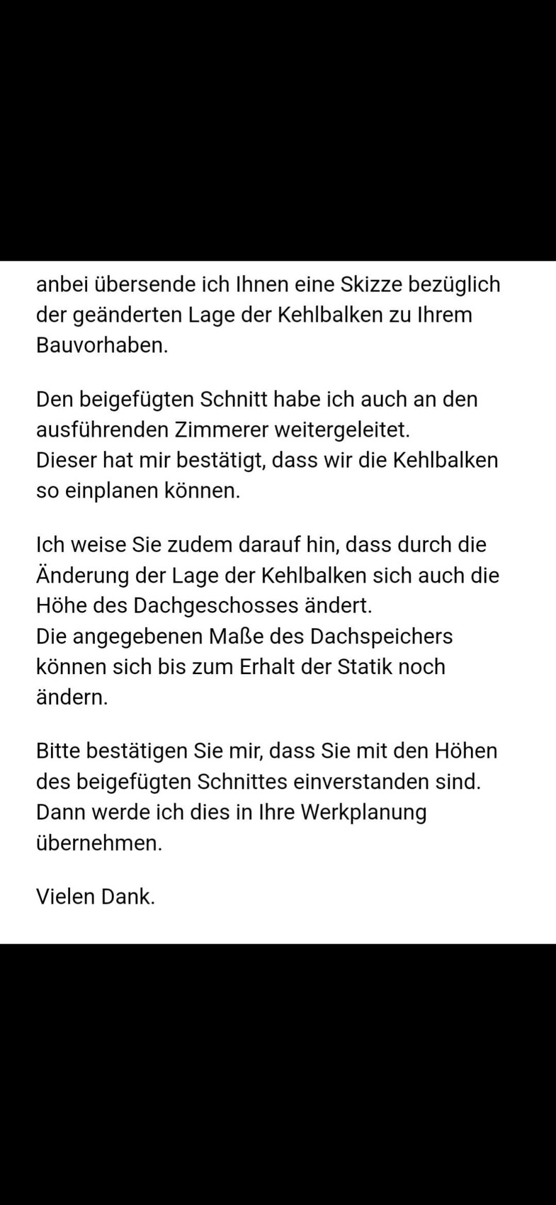

Well, the height in the attic used to be 63cm (25 inches) in the middle, now it’s 83cm (33 inches)...  <br />
  <br />
I will send you the matching email as well. To be honest, I can hardly compare them because each time there are new elements drawn in or measurements are taken differently... I don’t understand the height—what are the ceiling heights in the attic now and what were they before?  <br />
  <br />
[ATTACH type="full" alt="Page with notes on change of collar beam positions and building instructions.

Unfortunately, the number on the new drawing is not legible... but it cannot be higher than on the old drawing. You only need to compare the dimension chains on the left.
