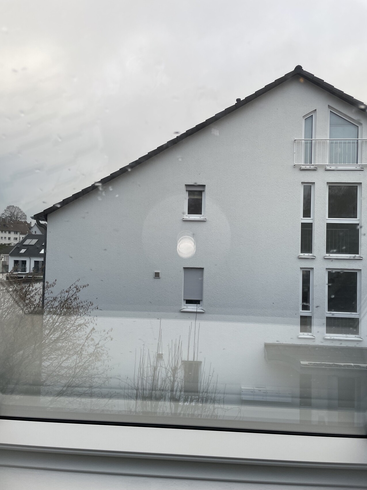

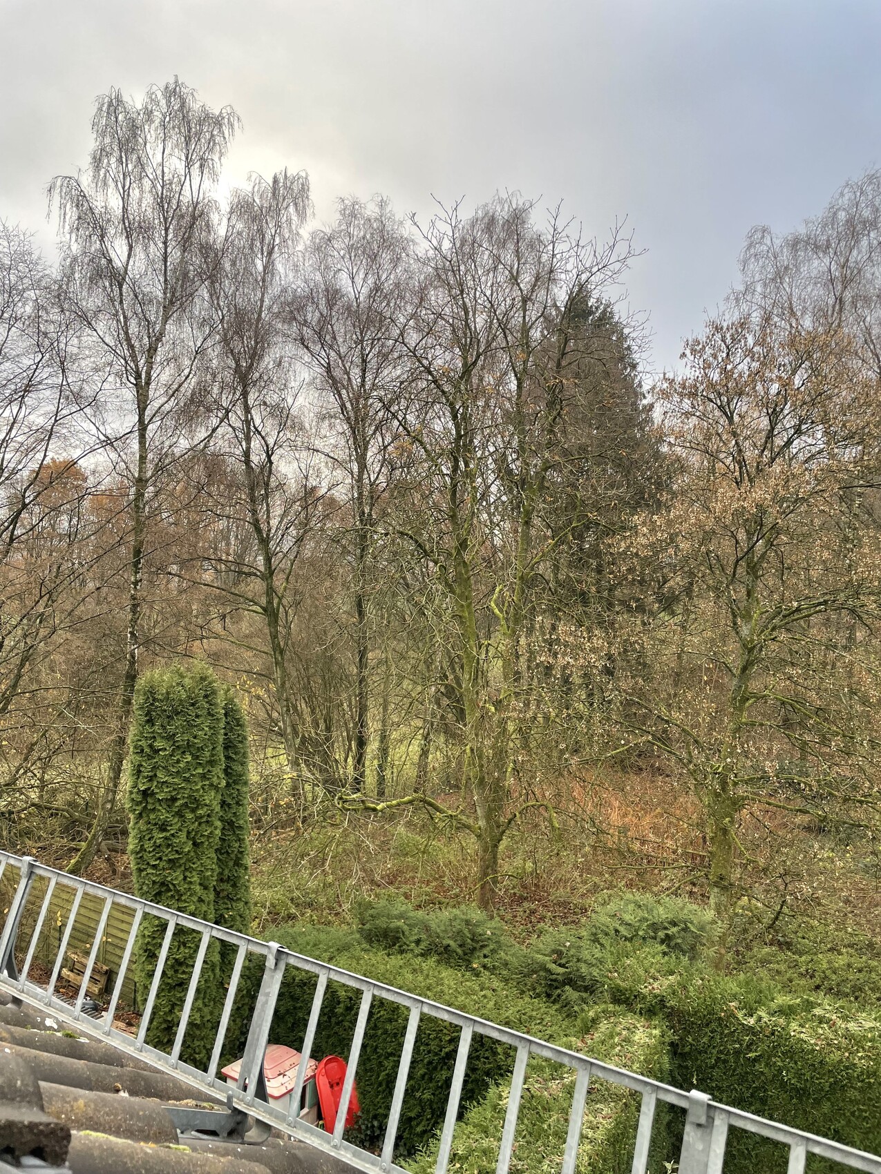

No idea how he came to that conclusion. It's not exactly north/south. I’d say about a 10-degree deviation.
There are trees on the south side. On the north side, there’s a house that’s slightly taller than mine.
It’s just not a detached property in an open field. So, not ideal.
