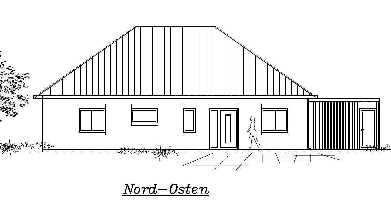

for our bungalow, we have partially planned three windows measuring 138.5cm by 126cm (55 inches by 50 inches) in height, and one window 138.5cm by 76cm (55 inches by 30 inches) in height. Given this width, would it make sense to use double casement windows? Do such windows even exist?
Since we have not planned for a mechanical ventilation system, we will be ventilating frequently. With ventilation, relatively wide single casement windows will open fully into the room, which I find disruptive. Over time, this could also cause sagging due to the weight and long lever action. Additionally, if there is a flower vase or other items on the windowsill, they must be completely cleared away when ventilating. With double casement windows, on the other hand, you can simply slide one side open to the side.
Thanks for your advice

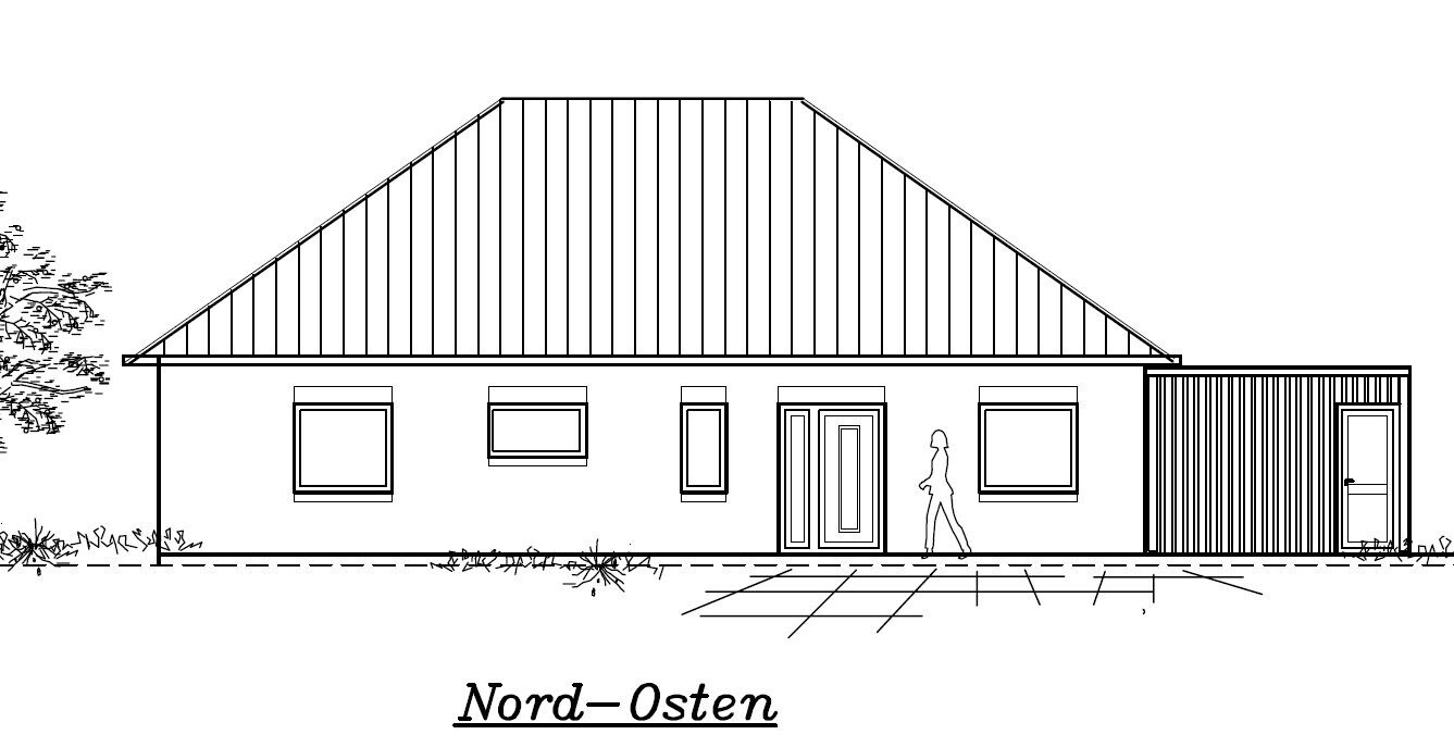

Counterproposal: for the rooms labeled "Child 2" and "Office," use a fixed section below, up to the bathroom window’s sill height, and then keep it single casement throughout. This way, the facade looks less mixed than if double casement windows were used, and potted plants can simply stay in place when ventilating.

01. is the current condition

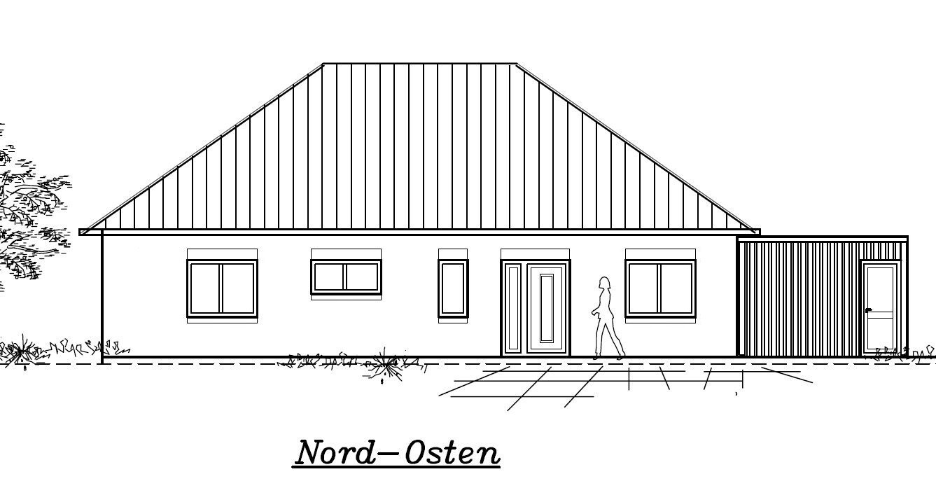

02. 138.5 cm (55 inches) - double casement
03. 138.5 cm (55 inches) - horizontally divided (@11ant version)

Considering only the glass area, 138.5 cm (55 inches) wide and divided is worse than the 126 cm (50 inches) single sash, so I find the 138.5 cm (55 inches) double casement rather pointless.
What do you think?
hemali200319 Apr 2018 14:22I would stick with option 01. I think such small divided windows look kind of silly. They don’t really offer any benefits—in your case, they even reduce the glass area.
I would only consider double casement windows starting from a total width of 180cm (70 inches) or for doors.
03 was just a note from me regarding the window sill clearance. My favorite would be 01, but I would align the toilet window to the same sill height as the bathroom window. No worries, you wouldn’t be sitting there in the dark anyway. But it does tidy up the facade.
