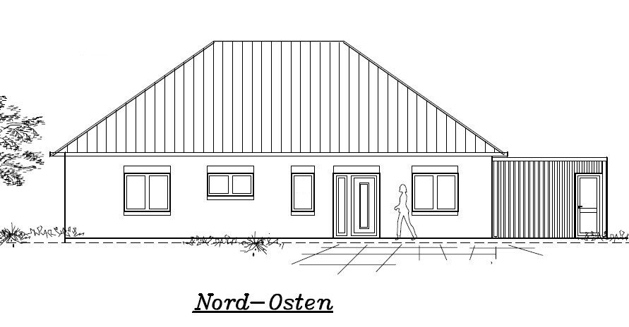

for our bungalow, we have partially planned three windows measuring 138.5cm by 126cm (55 inches by 50 inches) in height, and one window 138.5cm by 76cm (55 inches by 30 inches) in height. Given this width, would it make sense to use double casement windows? Do such windows even exist?
Since we have not planned for a mechanical ventilation system, we will be ventilating frequently. With ventilation, relatively wide single casement windows will open fully into the room, which I find disruptive. Over time, this could also cause sagging due to the weight and long lever action. Additionally, if there is a flower vase or other items on the windowsill, they must be completely cleared away when ventilating. With double casement windows, on the other hand, you can simply slide one side open to the side.

Curly schrieb:
I wouldn’t make the window (guest bathroom) next to the front door so small and square but rather align it with the sill height of the other large windows. After all, a window should also serve the purpose of letting in enough light. Our guest bathroom window measures 1m x 1.38m (3 ft 3 in x 4 ft 6 in) and it lets in plenty of light.
Sabine I don’t think that’s a bad idea either,
I will choose one of the last two views and sleep on it overnight.
Many thanks to everyone
Reza
Curly schrieb:
This way the elongated window stands out better. You mean the bathroom window that is then more nicely framed by its neighboring windows? - yes, you could look at it that way. In any case, I would say: put a stamp on the latest version. That one fits.
andreashm23 Apr 2018 11:05I would probably choose large, undivided windows unless subdivision is absolutely necessary due to their size (this often applies to floor-to-ceiling windows leading to a terrace, which can be designed as double casement or similar).
