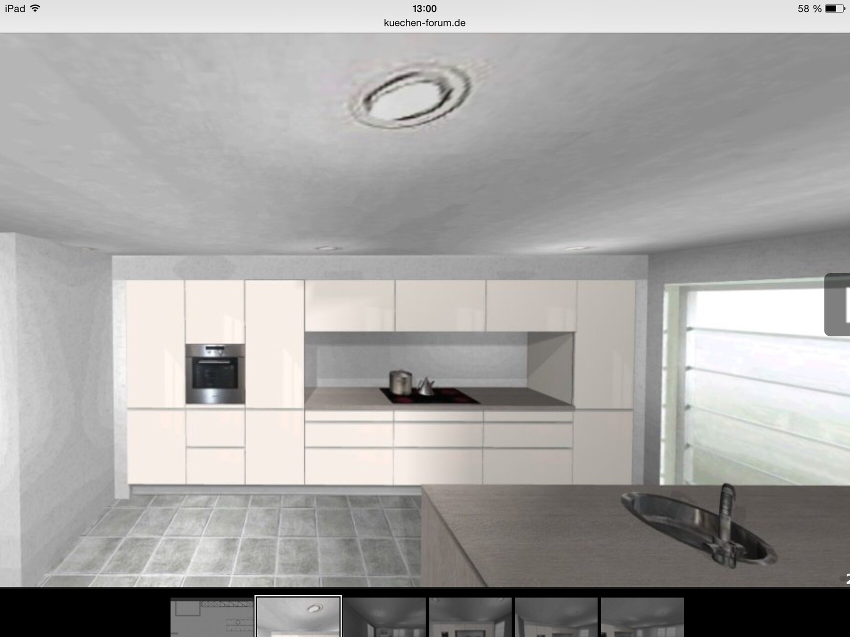

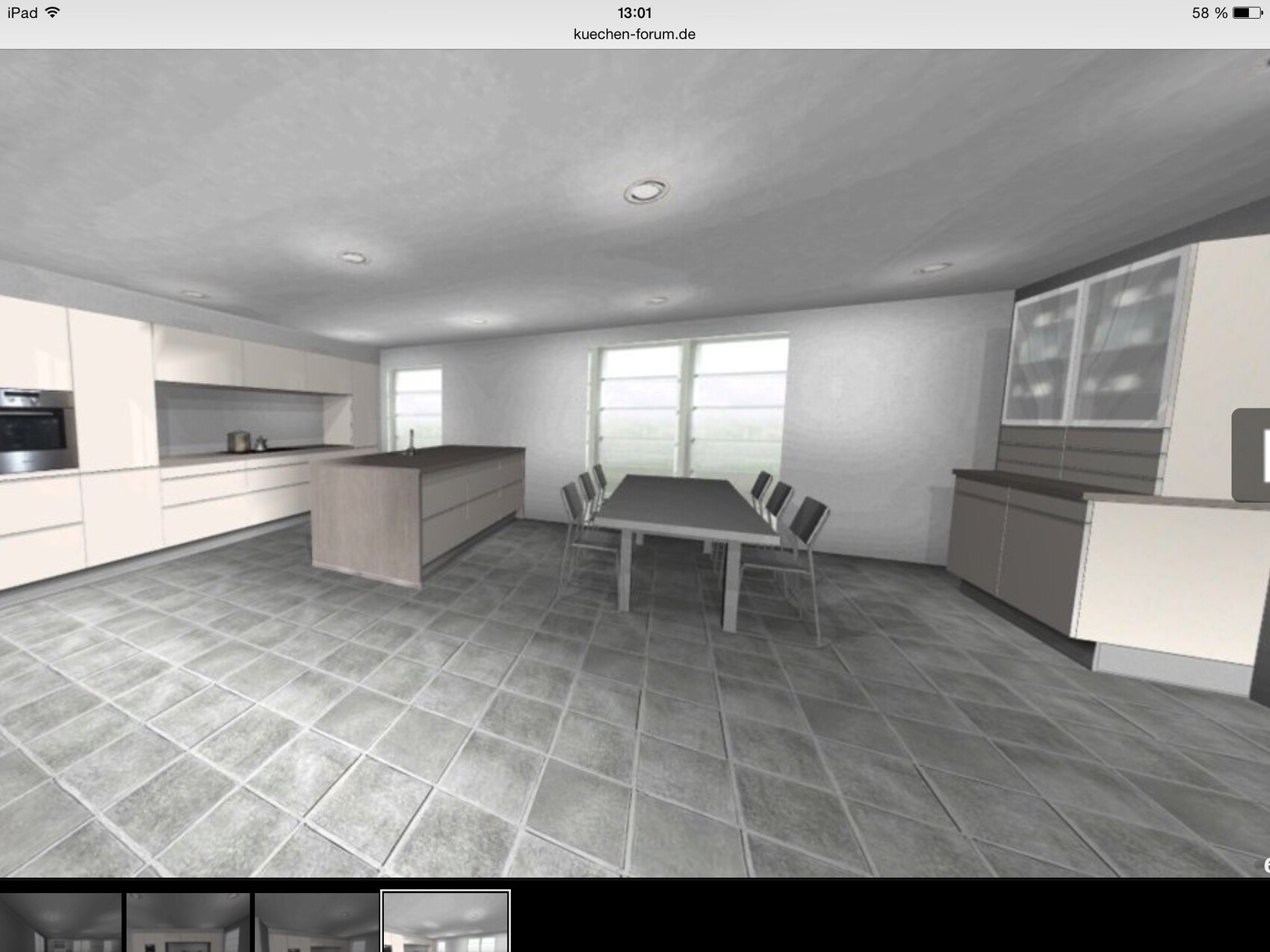

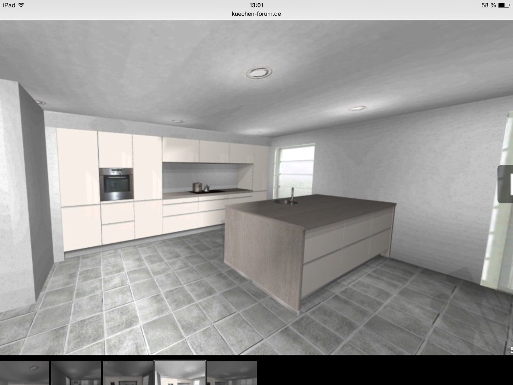

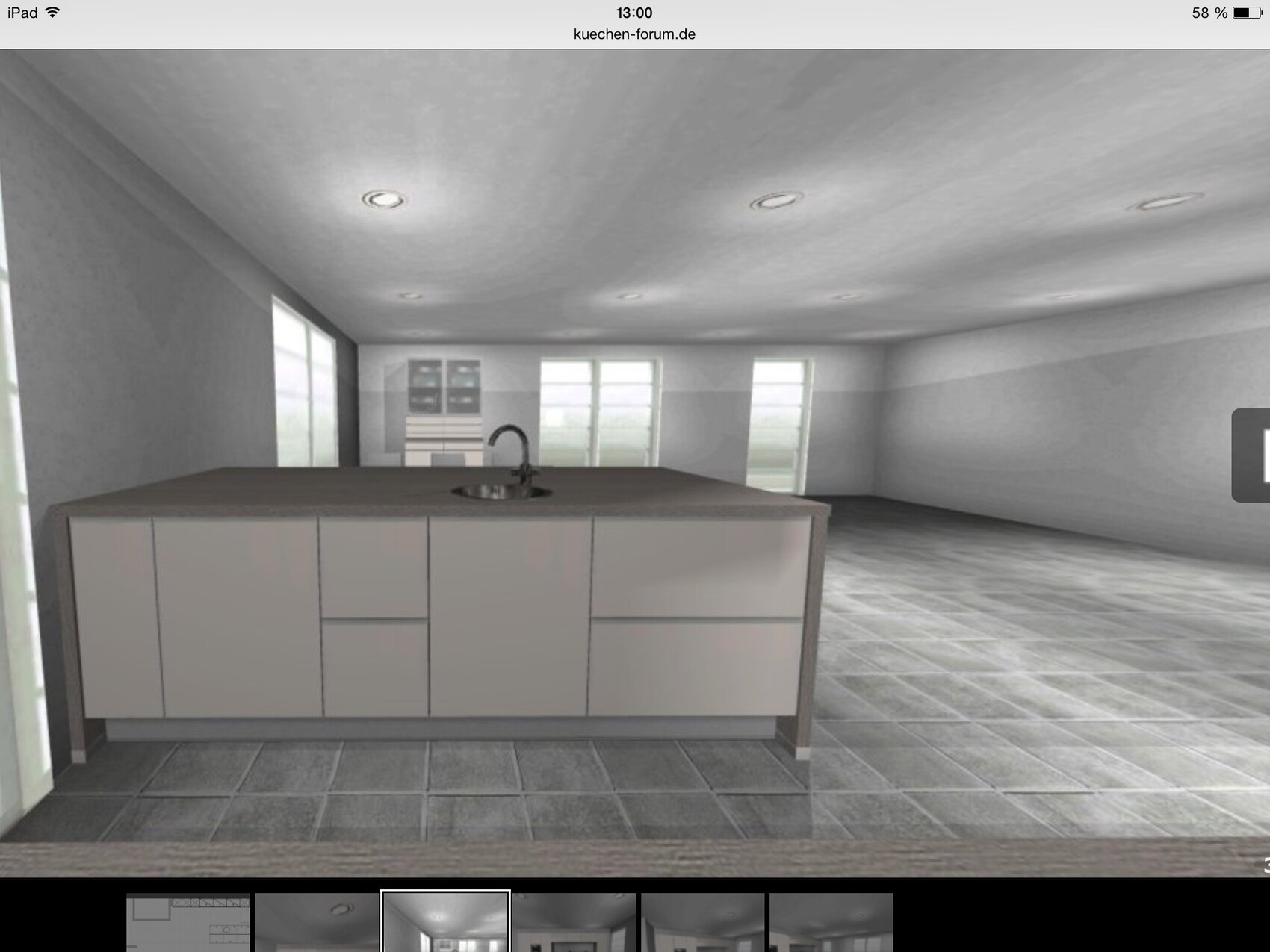

The kitchen design is mostly complete and is currently being developed and costed by our kitchen specialist. Since he has his own carpentry workshop, he is also designing something for the wardrobe, making sliding doors for the dressing corridor, and will create some features for the bathroom as well…

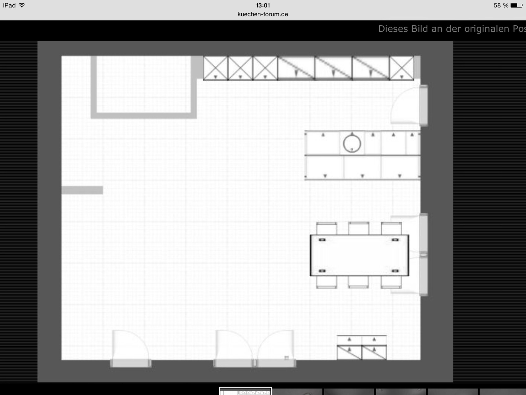

Now, I will share the floor plan, perspectives, and a few images of the kitchen, which is also incorrectly marked on the floor plan.

Kitchen: I would swap the sink with the stove because there is usually a lot of dishes that get left there and not washed immediately. This would always look a bit untidy. Also, I miss a surface area for the kettle, coffee machine or espresso machine, hand cream and stuff, drink bottles. The area where the stove is now would be needed on either side for these items, which would be too noticeable, unhidden, and then offer too little workspace.
In your floor plan, you don’t have as deep a wall (from the pantry) as shown in the kitchen layout.
