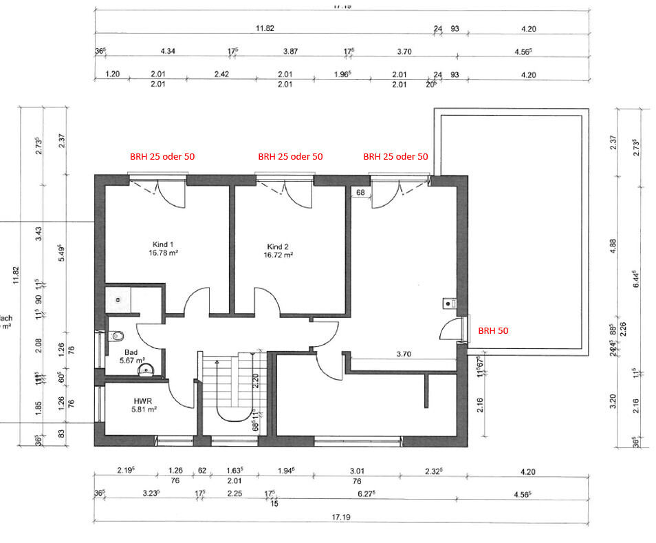

- This concerns a total of 4 windows (2 windows in children’s rooms) and 2 windows in the bedroom.
- One bedroom window (facing an extension) cannot be lowered to 25cm sill height and must remain at 50cm sill height (due to the roof parapet).

Floor plan:
Floor plan of a house: two children’s rooms, bathroom, utility room, stairs, hallway, and right extension/terrace area.

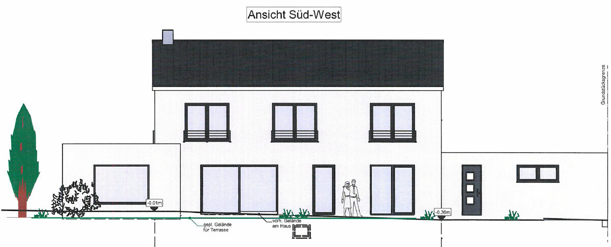

View sill height 25
View of southwest façade of a two-story house with terrace and large windows.

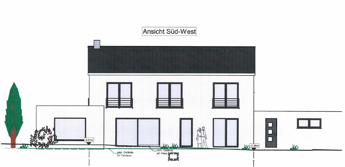

View sill height 50
Southwest view: modern house with dark roof, large windows, extension on the left, terrace.

Thank you very much for the pictures and additional opinions. A fully floor-to-ceiling window would also be our first choice, but unfortunately, this is not possible due to structural reasons. At the moment, we are leaning slightly towards “as low as possible,” meaning a parapet height of 25cm (10 inches) in the shell construction, about 10cm (4 inches) above the finished floor level.
