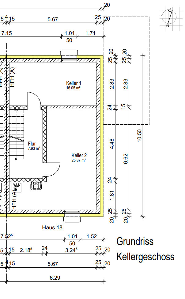

Basement floor plan of a house with two cellar rooms, corridor and stairs

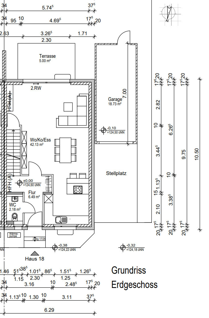

Ground floor plan with terrace, garage, living room, kitchen and hallway

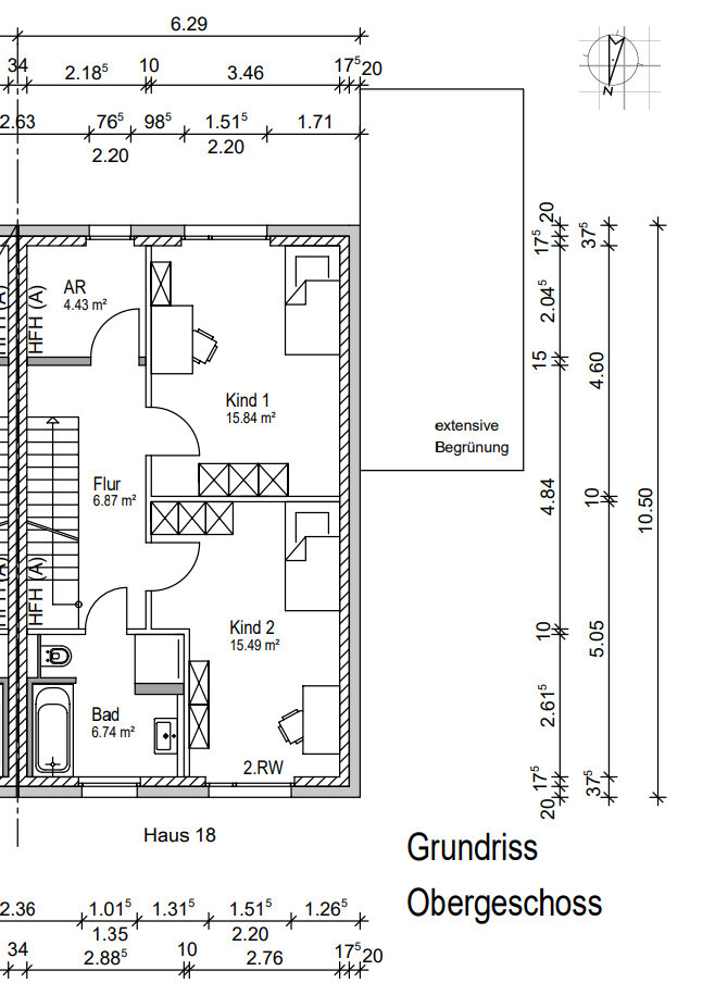

Upper floor plan showing hallway, bathroom and two children’s bedrooms

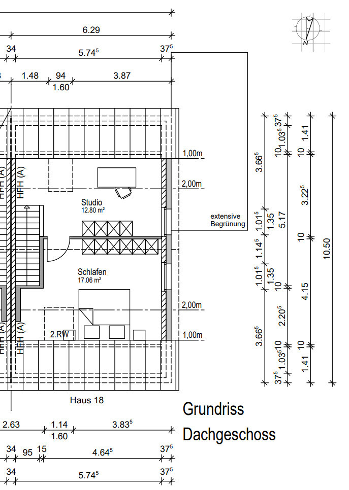

Attic floor plan with studio and bedroom, architect’s plan

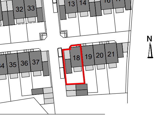

Site plan of a residential block; red frame marks the plot next to numbers 18–21.
Surroundings: To the south are garages for neighboring terrace houses, then a turning area (end of the cul-de-sac), followed by some individual trees and other detached houses. To the east is our block. Then a few small trees and a railway line (several meters lower). To the west, on our property, there is a city-required hornbeam hedge. We will try to negotiate a passage to the street (for bikes and so on). Since the second escape route on the ground floor is via the terrace, I see some chances, but city officials aren’t always easy.

- Ground floor: (main pain point) Entrance is relatively narrow with little cloakroom space. The peninsula kitchen feels too small to work well (and probably requires an expensive extractor in the peninsula). The distance from the sofa to the TV is huge. The basement access is in the living room. We’ll probably manage some kind of furnishing on the ground floor, but right now it doesn’t exactly feel “yes, this is perfect.”
- Upper floor: We’ve debated whether to enlarge the 4 m² (43 sq ft) closet slightly to potentially use it later as an overflow office, but actually we find it as planned not bad at all (and initially more practical).
- Attic: The “landing” could be another possible office space if children come; we considered whether to separate it right away with a wall and door or leave it as shown.

How do we best arrange the ground floor? Should we still make some changes here?
Ideas for potential changes to the ground floor

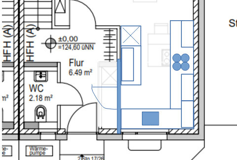

Maybe reduce the kitchen size and straighten the hallway wall? (We’ve discussed this idea in the kitchen forum but haven’t talked to the planner yet.) The scale is off here (I think my cabinets are too large). The rough structural width in the kitchen at the narrowest point is 248 cm (98 inches), so roughly 240 cm (94 inches) minus about 130 cm (51 inches) for both kitchen sides would leave 110 cm (43 inches) aisle width. Also, the window would be moved to the corner. In return, there would be more cloakroom space in the hallway. Bad idea? Opinions?

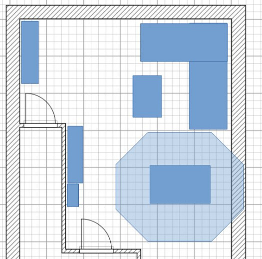

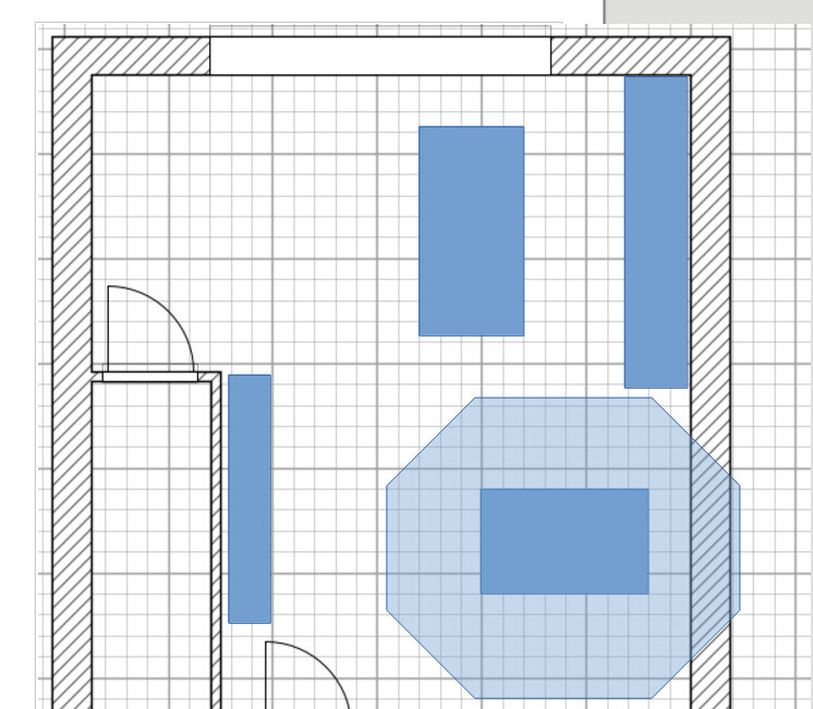

Another question is a bit… can we reduce the distance between sofa and TV? I’ve just sketched in our current furniture; it would look roughly like this (sofa 275 x 220 cm (108 x 87 inches)).
Floor plan of a room with blue furniture: L-shaped sofa on the right, table in the center, octagonal rug.
Ideas so far include putting a shelf behind the sofa (but that blocks the terrace door more). Any other ideas?

Something like this?
Floor plan of an interior space with furniture, doors, and entrance area

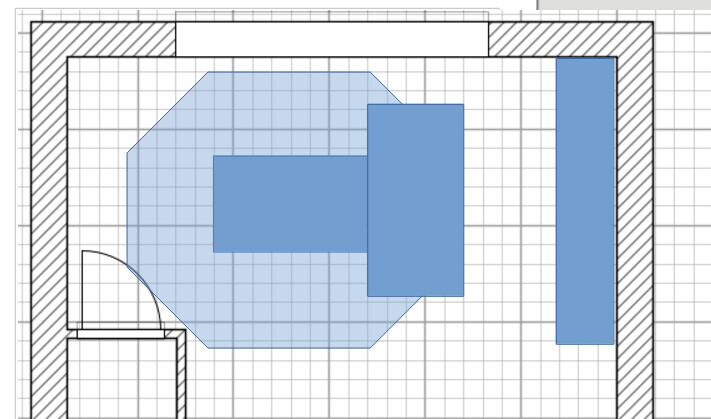

Or the table more towards the top? (the drawn table is 100 x 160 cm (40 x 63 inches), it might already be tight up there)
oh, like this?
2D floor plan of an interior space with walls, door, and furniture
or like this?
Floor plan of a room: large light blue octagonal table surface, more blue rectangles.
Or extend the kitchen further into the central area?
Our current sofa actually wouldn’t fit in the standard orientation at the bottom of the plan, in the niche. It would fit, but you’d basically have to step over the chaise to get into the living area (oops). We’ve already agreed that the sofa might be a bit too bulky anyway :/

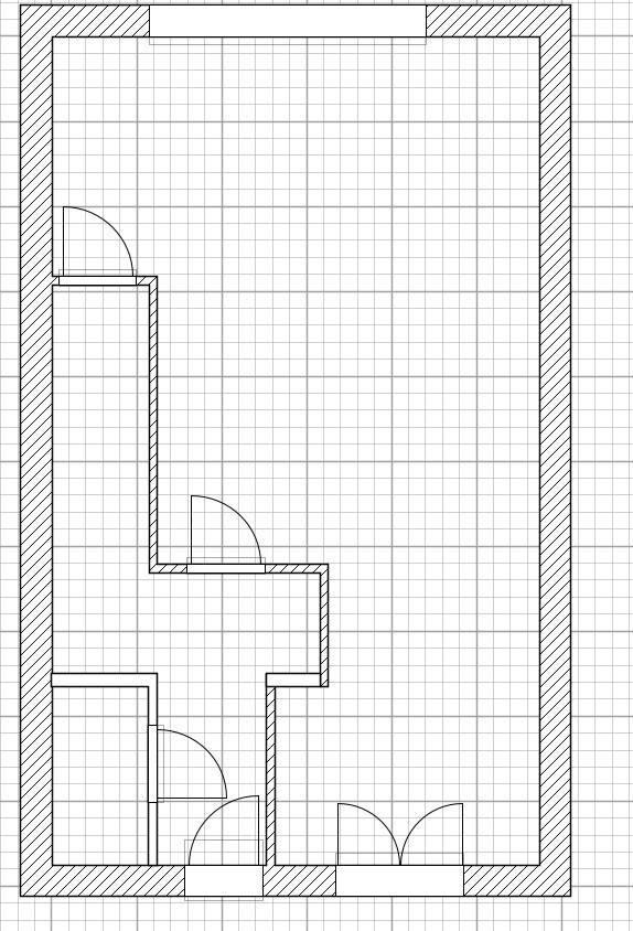

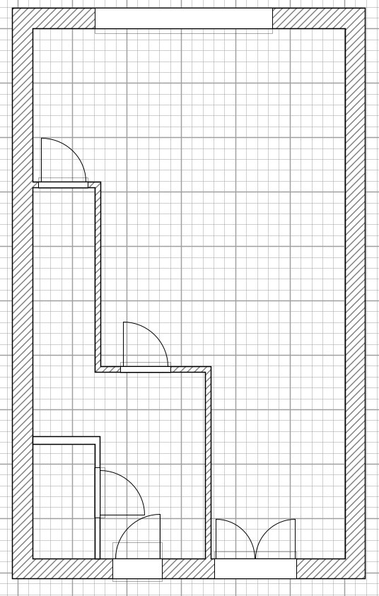

In case someone wants to doodle on it, I tried to redraw the floor plan (any transfer errors are my fault):
The kitchen windows at the bottom of the plan are actually asymmetrical, but the program couldn’t show that (or I wasn’t able to use it properly). The left side of the plan is smaller (I don’t know the exact ratio).
One small square here is 20 cm (8 inches), the thick lines indicate 1 meter (3 ft 3 in).
Rectangular floor plan of a building with interior walls and door openings.
or with a shifted wall:
Floor plan of a building complex with several rooms, doors, and shaded exterior border.

11ant26 Apr 2023 01:23
mayglow schrieb:
Perhaps reduce the size of the kitchen and straighten the wall in the hallway?
I consider the wall section between the coat closet and the tall cabinet non-negotiable...
I would omit the partition wall between the bathtub and the toilet.
... and this one as well.
What I would try to change, though, is to add an extra window on the west side. We had that in the row house as well, although facing north, but it made a big difference compared to the middle units.
mayglow schrieb:
Would you position a window fairly close to the garage to improve lighting in the “middle section,” or rather in the (currently) kitchen area?
I would place it (floor-to-ceiling) “below the gap between the gable windows.”
