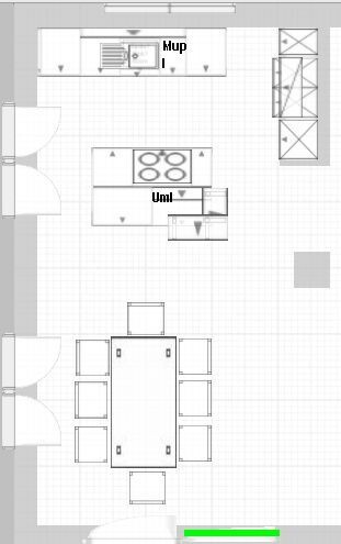

I would quickly need your assessment on whether the price is reasonable.
The kitchen, including stove, microwave, oven, dishwasher, and sink, is supposed to cost €11,850.
What is not included are the refrigerator, backsplash, and faucet.
Lowest online prices for the appliances compared to the kitchen studio:
- Stove €1,800. Studio price €2,050 including installation = okay
- Dishwasher €560. Studio price €565 including installation = okay
- Oven + microwave €1,120. Studio price €1,200 including installation
- Sink studio price estimated €500-600, since it is a ceramic sink
Total cost for appliances = €4,320-4,420 without refrigerator, backsplash, and faucet.
So my problem is not the electrical appliances.
Therefore, the pure kitchen furniture is supposed to cost about €7,600.
- Brand: Bauformat
- High-gloss lacquered fronts
- Worktop laminate with thick edging
- The island is 2.50 m x 1 m (8.2 ft x 3.3 ft)
- The kitchen run is 3.20 m (10.5 ft)
- High cabinet 1 m x 46 cm (3.3 ft x 18 in)
Attached are the pictures. Are the €7,600 for the kitchen furniture justified?

A quick note for Zaba12:
  • Extend the wall by the stairs by about 10 cm (4 inches) to allow the possibility of boxing in tall cabinets
  • Tall cabinet wall made from 40 cm (16 inches) wide units with internal pull-outs for pantry items, etc.
  • French door fridge
  • 60 cm (24 inches) tall cabinet for the oven, allowing enough elbow room
Sink run in extra depth consisting of:
  • 60 cm (24 inches) base cabinet with 1-2-3 drawer configuration (almost like an 80 cm (32 inches) base cabinet)
  • 60 cm (24 inches) dishwasher
  • 60 cm (24 inches) sink cabinet with bins for recyclable waste, paper, and a shelf for typical kitchen cleaning supplies
  • 40 cm (16 inches) base cabinet with waste sorting system for organic and residual waste, located directly under the countertop
  • 60 cm (24 inches) base cabinet with 1-2-3 drawer setup (again, nearly like an 80 cm (32 inches) base cabinet)
Cook island from kitchen side:
  • 30 cm (12 inches) base cabinet with internal pull-out, especially for spices, etc.
  • 90 cm (36 inches) cabinet for cooktop - configured as 2-2-2 drawers
  • 60 cm (24 inches) pull-out base cabinet with 1-1-2-2 drawer layout
Cook island from the back side:
  • 90 cm (36 inches) cabinet with drawers, reduced depth by 20 cm (8 inches) to make room behind for the recirculation unit, etc.
I would only install the breakfast bar diagonally, if at all, as a casual standing counter.
Because if you also add a 2 x 1 m (6.5 x 3.3 feet) large dining table with ample seating to the room, it becomes clear that the sliding door should be placed where I marked it in green, as that will be the more direct and straight walking path from the kitchen. Also, because of the fireplace, the table will likely be positioned as shown so that it is not too close to the heat source.
Floor plan showing kitchen with island and dining table in open dining and living area
On the wall section transitioning to the living area, I could imagine a nice glass display cabinet for non-daily-use glasses.
To the left of the kitchen window (what is the height of the window sill, by the way???) a wall cabinet could also be added if absolutely necessary. But definitely make sure it offers easily reachable space for the coffee machine or coffee maker.
Top-down view: modern kitchen with island, stove, sink, and dining table with chairs.
Kitchen with white base cabinets, dark countertop, sink, window and refrigerator on the right.
Modern kitchen with island, white cabinets, dark countertop; oven, dining table behind.
Modern kitchen: sink on the left, cooktop on the right, island, window front, fridge and oven.
Open modern kitchen and dining area with wooden table and kitchen island.

For Zaba12 quickly:
  • Extend the wall to the staircase by about 10cm (4 inches) to allow for enclosing tall cabinets
  • Tall cabinet wall with 40cm (16 inches) units with pull-out shelves for pantry items, etc.
  • French door refrigerator
  • 60cm (24 inches) tall cabinet for oven... providing elbow room
Sink run in extended depth including:
  • 60cm (24 inches) base cabinet with 1-2-3 drawer configuration (almost like an 80cm (31 inch) base cabinet)
  • 60cm (24 inches) dishwasher
  • 60cm (24 inches) sink cabinet with bins for recyclable waste, paper, and a shelf for typical kitchen cleaning products
  • 40cm (16 inches) base cabinet with waste separation system for organic and residual waste right under the countertop
Cooking island from kitchen side:
  • 30cm (12 inches) cabinet with pull-out, especially for spices, etc.
  • 90cm (36 inches) cabinet for cooktop - 2-2-2 drawer layout
  • 60cm (24 inches) pull-out base cabinet with 1-1-2-2 drawer layout
Cooking island from the back side:
  • 90cm (36 inches) cabinet with drawers, shortened by 20cm (8 inches) in depth to allow space behind for recirculation unit etc.
I would only install a breakfast bar on the corner, if at all, as a standing bar.
Because if you also add a 2 x 1 meter (6.5 x 3.3 feet) dining table with generous seating to the room, it becomes clear that the sliding door section should be placed where I marked it in green since this offers a more direct and straight walking path from the kitchen. Also, due to the fireplace, the table will usually be positioned as I placed it here so that you’re not too close to the heat.
On the wall section transitioning to the living area, I could imagine a nice glass cabinet for everyday-use glassware.
Left of the kitchen window (what is the sill height there, by the way???) you could also add a wall cabinet if absolutely necessary. But definitely a well-accessible spot for the coffee machine/automatic coffee maker there.
I think your design is brilliant!

I want to respond at least to acknowledge the personal effort you put into this and to thank you for the alternative ideas.
I am 100% on board with your last paragraph. That has always been the plan, and it will not be changed.
Perhaps our fondness for counters is influenced by family experience. My parents have an L-shaped kitchen with a long counter on the opposite wall. On both sides there are two stools. Whenever my wife and I visit with the kids, after a while everyone ends up sitting or standing at the counter. Coffee is enjoyed, conversation flows. The kids both want to be at the counter. In the evenings, food preparation happens there (which is not possible for my wife with an island in our current kitchen). When there is enough room, dinner is eaten at the counter -- of course not with six people. When the kids are asleep, my wife and I stand at the counter in the evening with a glass of wine, whisky, or something similar. It might be that it feels cozy because two people can sit facing each other. That’s not possible with an island.
You are all right, the island loses its advantage for dual-sided working. That is definitely a strong disadvantage if many hands want to help. My wife imagines all the children (8 and 6.5 years old at move-in) sitting at the counter watching.
If number three is on the way soon, standing or sitting at the counter might be over anyway.
We will definitely discuss the drawer layout. I explained the 1-1-2-2 configuration to my wife. She seems open to it.
The space under the sink is not suitable for placing the trash bins since we have a boiling water tap. The trash bin is currently planned to be to the left of the stove in the 3-drawer cabinet.
Regarding storage planning: Currently, we have a 40 cm (16 inches) pot cabinet that is too small, with a 40 cm (16 inches) wall cabinet above it holding bowls and miscellaneous items. Then comes the oven, stove, and range hood. Next to that is a 40 cm (16 inches) cabinet with drawers in a 1-2-2 layout for cutlery, spices, and bowls. That is definitely too small. Above it is a 40 cm (16 inches) wall cabinet used only for plates, which is sufficient just for the kitchen – there is another cabinet for plates in the living room. Then comes a corner where the Thermomix is placed. Next to the corner are the dishwasher and sink (both 60 cm (24 inches)), with trash bins underneath. Above is a 100 cm (39 inches) wall cabinet for glasses and cups. Next to that is a 20–30 cm (8–12 inches) pull-out cabinet for cereal, Nutella, etc. Next to that is the 60 cm (24 inches) combined fridge and freezer. On another wall there is a 150 cm (59 inches) sideboard at countertop height with 2 cabinets and 4 drawers, holding the coffee machine, toaster, and bread box. The sideboard is about two-thirds full of Tupperware. The drawers hold cleaning cloths, rags, and miscellaneous items. The rest is stored in three wooden shelves in the 3 square meter (32 square feet) pantry.
I should add that we really dislike eating at the living room dining table. All meals are taken in the kitchen at a 70x120 cm (28x47 inches) table. The living room table is used only when there are many guests.
What will definitely not happen is changing the layout by extending the staircase wall. I will not block a clear view into the room with a corner wall.
Maybe it would make sense to use the unused stair wall space but without extending or building a wall. I am considering that. If so, only an L-shaped layout with an island would work, but then the island would have to be smaller.
As mentioned before, the consultant will probably have to give up on the symmetrical drawer layout.
Snowy36
23 Sep 2018 11:41
Honestly, I would really like a corner like that because I would feel more sheltered in the kitchen behind it... But that’s a matter of taste!
What’s more important is that you set up your kitchen the way you want it, making sure the ergonomics work. With the side-by-side refrigerator as originally planned, the ergonomics are not ideal. If you want a counter, then go for it.
Müllerin
23 Sep 2018 11:43
You can always remove a counter later if you no longer need it... (there’s surely a solution for the holes...)
