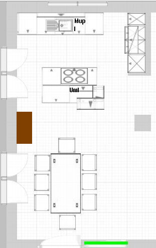

Therefore, the pure kitchen furniture is supposed to cost about €7,600.
- Brand: Bauformat
- High-gloss lacquered fronts
- Worktop laminate with thick edging
- The island is 2.50 m x 1 m (8.2 ft x 3.3 ft)
- The kitchen run is 3.20 m (10.5 ft)
- High cabinet 1 m x 46 cm (3.3 ft x 18 in)
Attached are the pictures. Are the €7,600 for the kitchen furniture justified?

it is not shown that way, at least I interpret the indicated arrows on the lift-and-slide door as marking the opening part of the lift-and-slide door, which makes sense for the living room area but not for the dining area. It was always planned the way you mean. The window manufacturer knows this and will be reminded of it again during the measurements.
chand198623 Sep 2018 12:46I would even expand on the idea of considering workflows: Where do you do something because it makes sense, and where do you do it because there’s no better option? Workflows can actually improve in a new room compared to before—not just more storage space while everything else stays the same.
In terms of functionality, there is a huge gap—figuratively speaking—between the KFB design and the one from kbt09. You should look at it carefully and really let it sink in.
You don’t have to take any action, but now you have an excellent alternative in mind.
MUPEL is still being discussed. My wife is right-handed. On which side next to the stove should it be divided into 2 x 40cm (16 inches)? And in which of the 40cm (16 inches) units should the trash bin go—on the outside or inside? Of course, then a set of three drawers above.
Just something to consider further… one of the reasons why we always design the kitchen together with adjoining rooms here in the house-building forum.
The tall cabinets from the kitchen designer’s plan would roughly be where I placed the brown box now:
I think you should let that sink in for now.
By the way, a base cabinet with a waste system, sink, and dishwasher isn’t so much about being right- or left-handed, but more about practical workflow. And you get used to it very quickly.

For me, preparation means the most efficient layout is fridge - sink - waste bin and counter space, followed by the cooktop Let’s assume the kitchen will stay roughly the same, and we can only reasonably adjust the module sizes for waste bins, pots, plates, glasses, drawers, etc.
