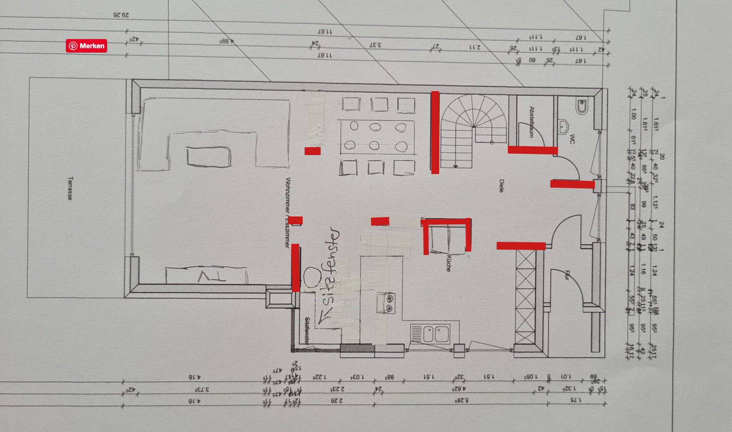

We have chosen a Next125 kitchen in lava black velvet matte with a ceramic countertop. Since we still have 1-2 months for the final configuration, we would like to get some feedback on optimization and pricing. Attached you will find the layout and the visualizations.
Thank you in advance for your help.

Myrna_Loy3 Aug 2021 16:13Steffi33 schrieb:
Oh... I don’t think so. If you look at this diagram, the refrigerator is neatly placed in a suitable niche. The wall continues behind it, so it looks enclosed. It’s not standing alone in the room.
Then take a look at the floor plan with the entrance situation. It’s really not a clear layout – it ruins the whole beautiful living area with the great bay window.Hmm... I don't find the layout very successful either. It looks a bit makeshift to me. I’m not sure how many changes are still possible, but I would try to move towards a two-row layout.
One row along the bottom wall up to the seating window, and a large row or island block extending from where the side-by-side refrigerator is planned towards the left side of the plan. The length should be roughly aligned with the drawn dining table.
The question is what can be done about all the small wall segments and what is structurally feasible. If necessary, you could work with support beams or columns, which can also be left visible...
… first of all: the kitchen is divided into two sections as planned. You constantly have to go to the upper cabinets when you need something at eye level. That means taking 6-7 steps every time to get supplies or a bowl. Dishes, a glass… the tall cabinets do not offer any kind of temporary surface. Taking the chicken out of the oven briefly and setting down the baking tray isn’t possible anywhere. And so on.
Where is the coffee machine supposed to be placed and so forth? There is simply not enough counter space available!
It’s a renovation... but replacing a few wall panels with supports doesn’t necessarily solve the problem. I understand the desire to open up the kitchen, but forcing it won’t help.
Just as a suggestion: we had to keep a wall panel that basically supports the entire ground floor ceiling. Putting the refrigerator against it would have looked quite awkward, so we decided to build a peninsula there, starting with a half-height cabinet that includes the dishwasher. Maybe something like this could be an idea for you as well, if that wall panel is going to remain in place.
