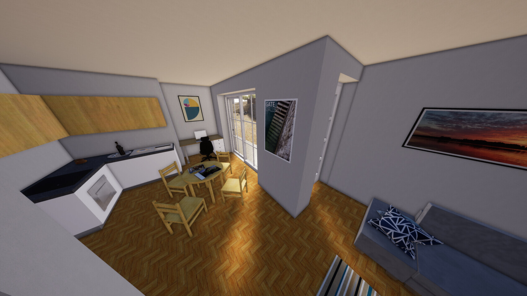

How does light get into the small apartment?
Light comes through a lift-and-slide door measuring 2.5 x 2.4 m (8.2 x 7.9 ft) and a balcony door. Of course, it could be more, but the lot is as it is. Building higher is not possible because it would not be allowed by the building permit / planning permission. Would it fit better if the bed and kitchen were swapped?

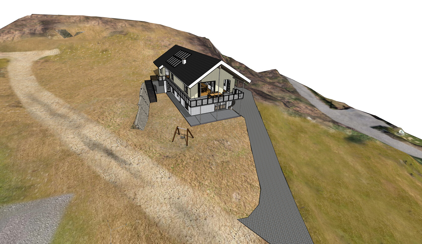

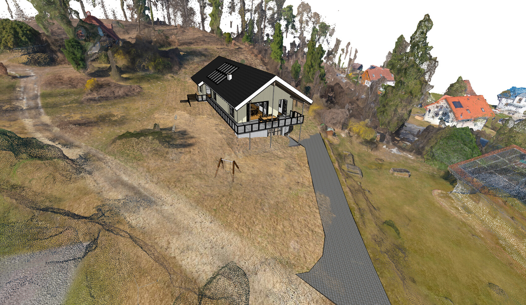

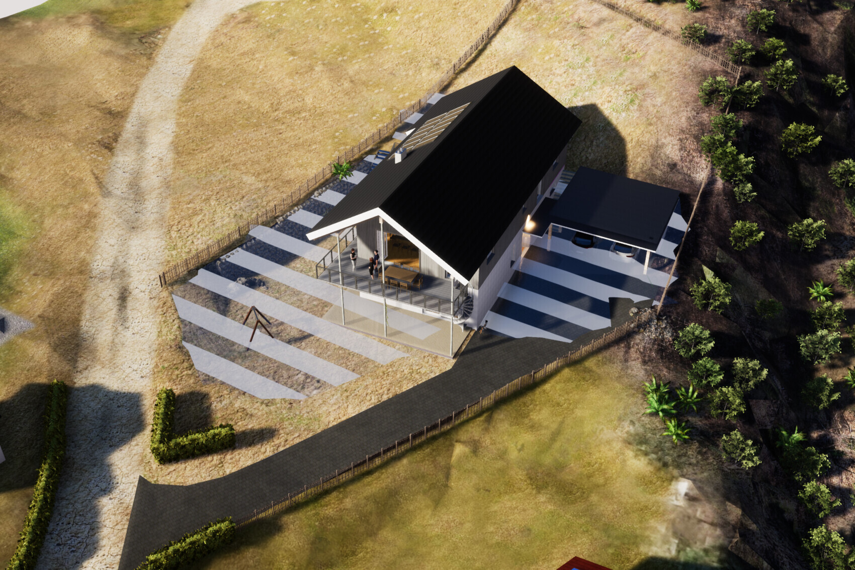

haydee schrieb:
Somehow the slope height doesn’t match the first house. Why is the new floor plan so low?
That’s right. The house is located further west and rotated. So it is deeper into the slope. In earlier designs, the embankment to the northern neighbor was excavated. That’s why the basement was partially exposed. The house stood further forward (east). Currently, there is no change to the neighbor’s terrain, but there is a stone retaining wall in the south.
Once WITH and once WITHOUT terrain point cloud.
3D model of a house on stilts with wooden terrace in hilly landscape, walkway to the house
Modern hillside house with terrace, railing, long driveway and playground equipment in front.
Here is the original terrain in white.
Modern single-family house on a slope with large terrace, carport with two cars and garden surroundings.
haydee schrieb:
Small apartment will be a dark hole.
It’s probably not for those who love sunlight. However, the legal requirements are comfortably met.

hausbau2021 schrieb:
Unfortunately, I can only offer you Google Earth. View towards the northeast. In the opposite direction, there is a slope and forest.
[ATTACH alt="5_googleearth.png"]43544[/ATTACH]
That's correct. The house is located further west and rotated, so it is deeper into the slope. In the previous designs, the embankment towards the northern neighbor was cut back, so the basement was partly exposed. The house was positioned further forward (east). Currently, there are no changes in the terrain on the neighbor’s property, but there is stone walling to the south.
One image WITH and one WITHOUT terrain point cloud.
[ATTACH alt="5_1gelaende.png"]43545[/ATTACH][ATTACH alt="5_2gelaende.png"]43546[/ATTACH]
[ATTACH alt="5_3gelaende.png"]43547[/ATTACH]
It’s probably not ideal for sun lovers. However, the legal requirements are easily met.
Looks pretty cool ... Upper Bavaria?
haydee
1 Mar 2020 20:14
It's probably not suitable for those who want a lot of sun. However, the legal requirements are easily met.
I find it too dark. If the windows were evenly distributed, it might be better. You have an area that always needs light.
What are you planning to do with the basement?
