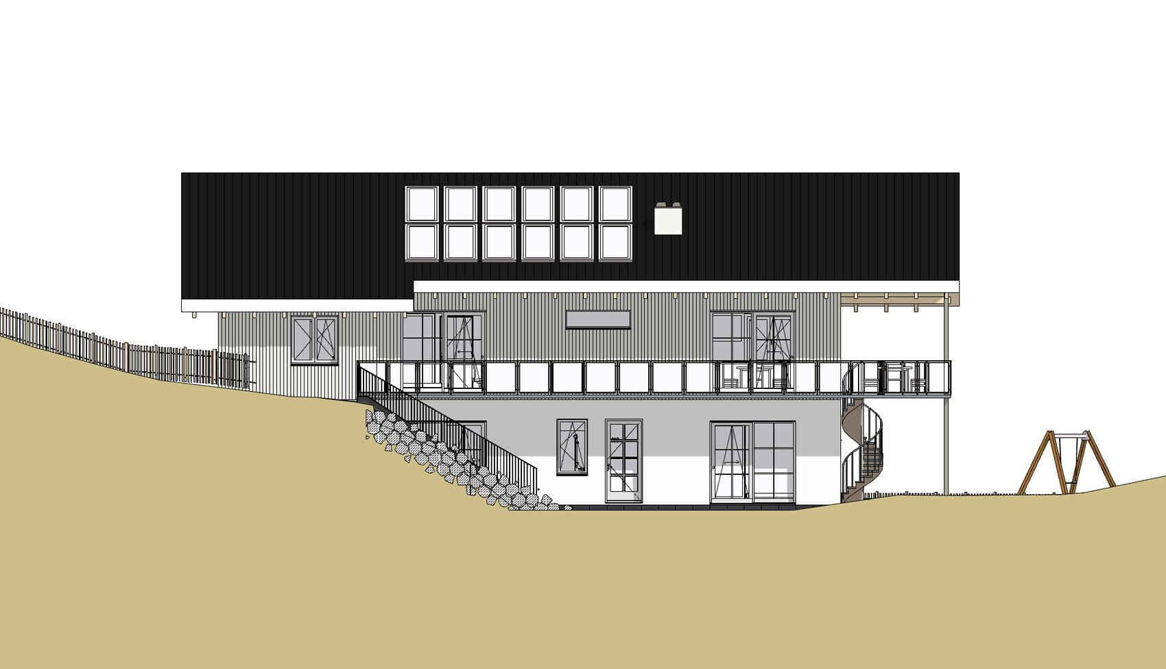

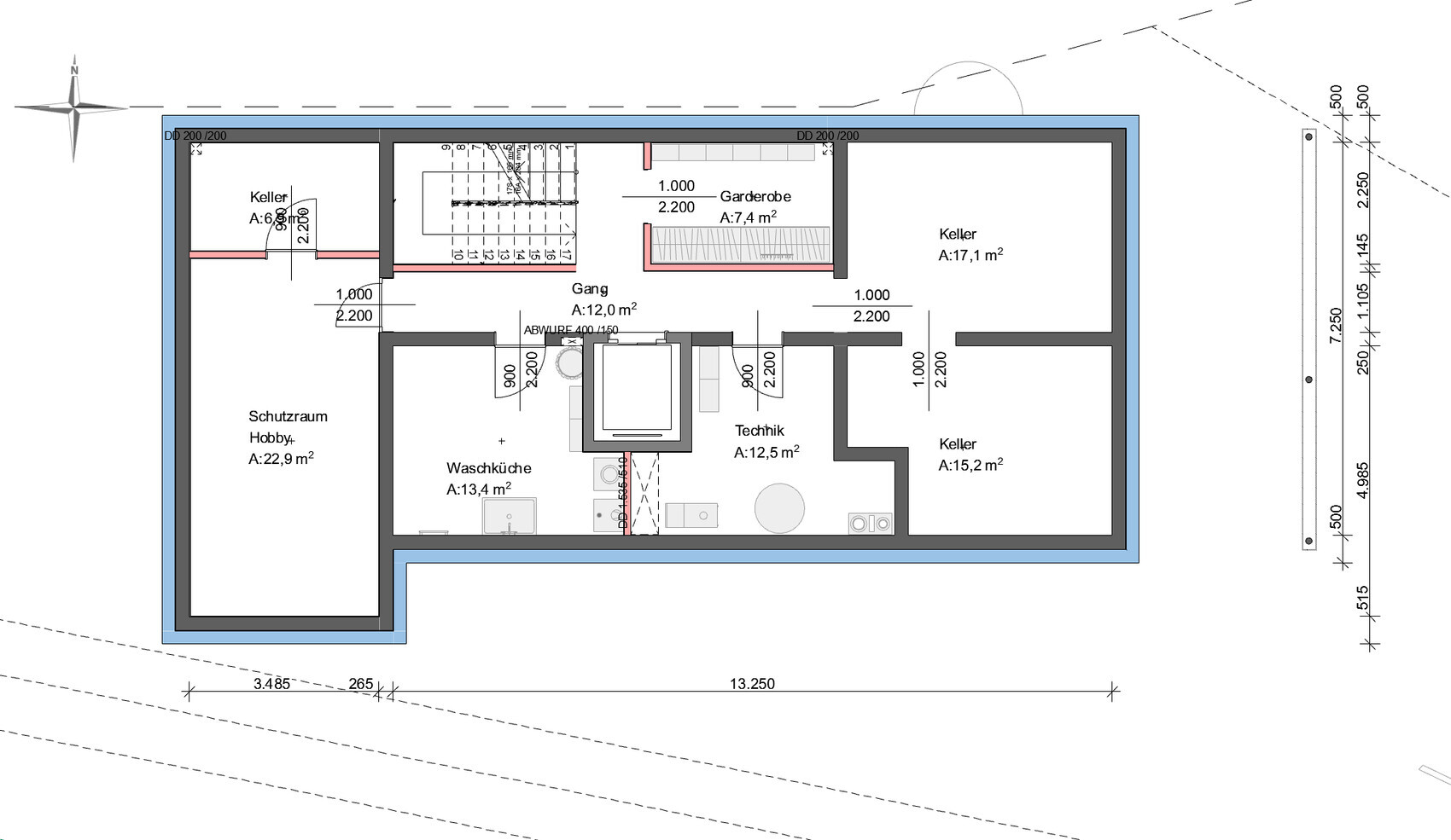

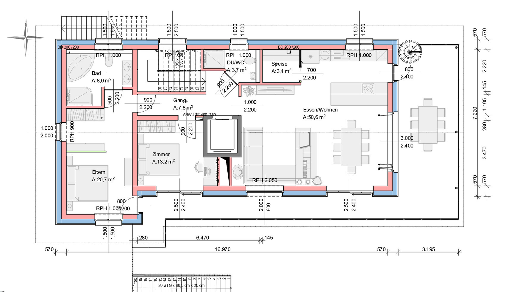

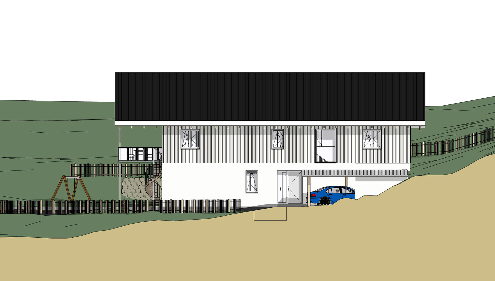

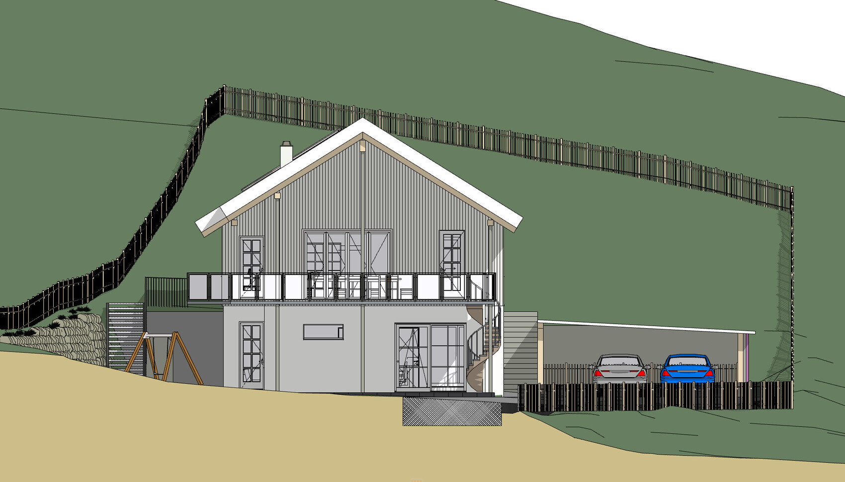

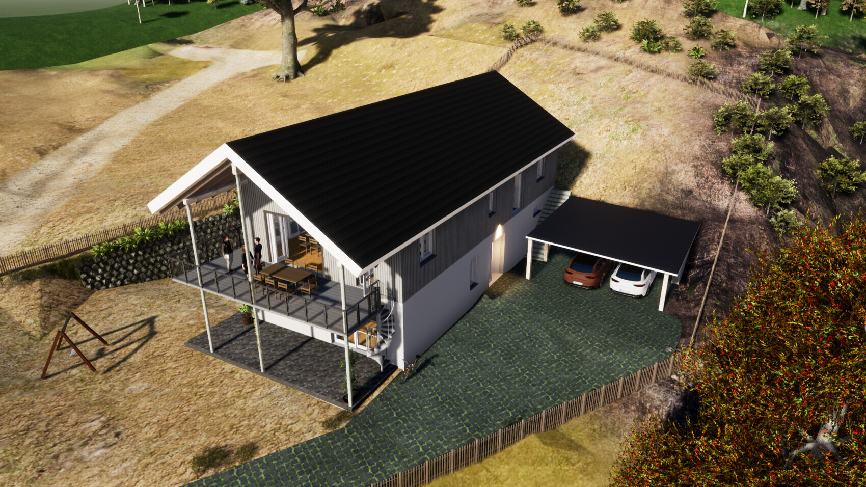

hausbau20211 Mar 2020 12:19I am the original poster of this thread (the original account no longer works and cannot be reset).
We have now worked through a new idea/preliminary draft from the planner. The area is 219 sqm (2,358 sq ft). The basic requirements remain the same as in the initial post. The living area has been moved upstairs. The children’s rooms are downstairs. The basement is fully underground.
I would appreciate your opinions, suggestions, and criticism!

I’m interested in the planner’s idea of placing the living areas upstairs. Do you like that better?
Are the bricks pink and the ETICS blue?
Yep.
Maybe you could provide us with more guidance: I now "see" three guest rooms on the ground floor (two sharing a bathroom and one as a suite/apartment), but no separation of the family apartment on the upper floor from the common staircase, and I’m left standing rooted to the spot, puzzled in the entrance hall.
Overall, you have rearranged a lot without explaining it.
