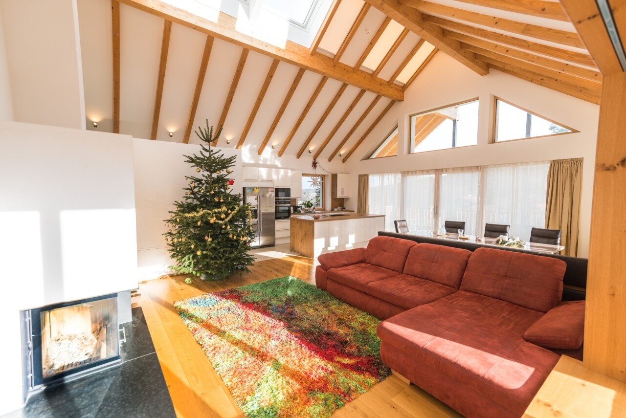

hausbau202123 Dec 2023 13:55haydee schrieb:
Could you please upload pictures of the living area with the huge window?The room divider is still missing at the moment.
