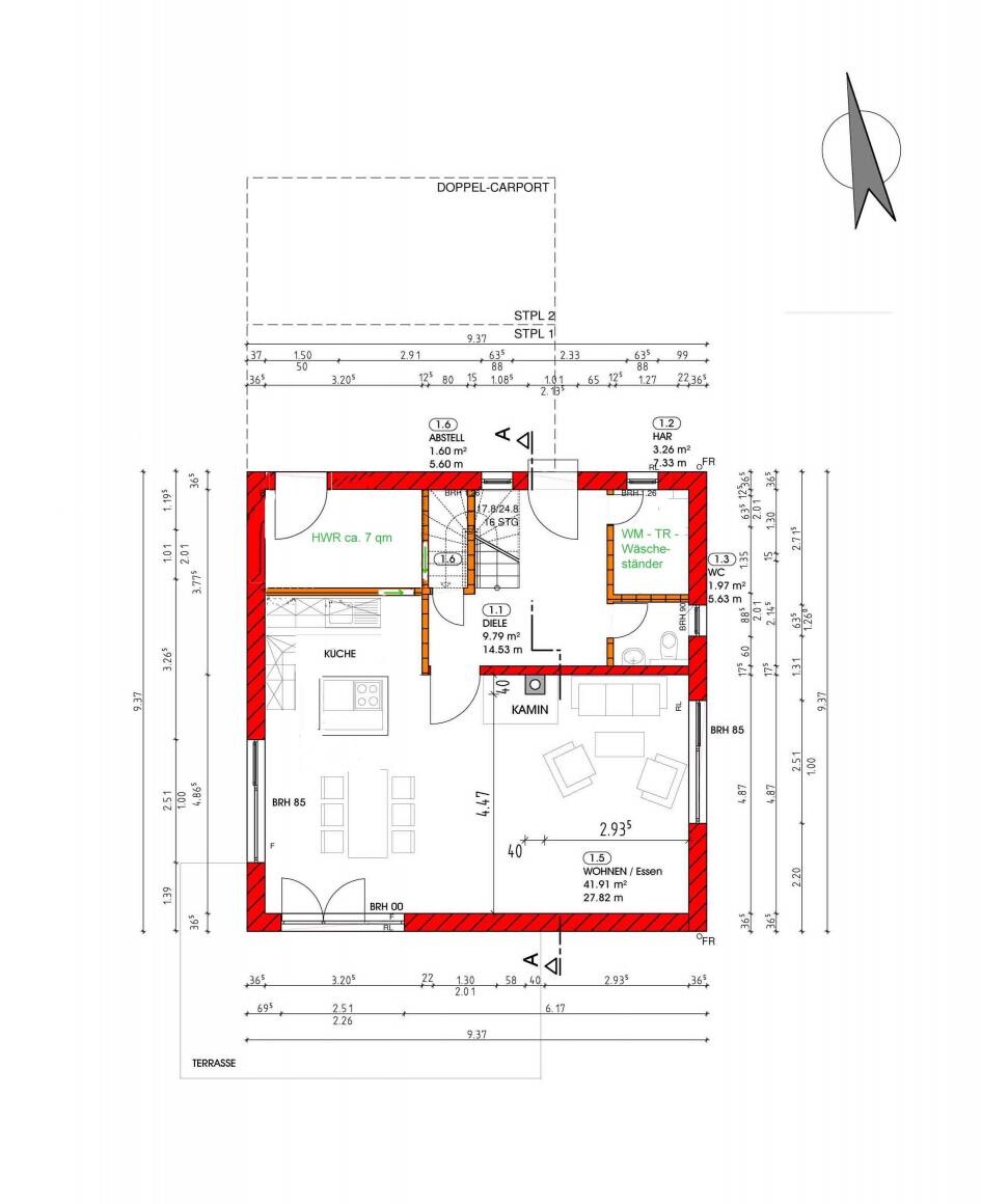

There is a storage room available!!!The storage room under the stairs? OK, can you imagine it in 3D? The room is as wide as the door (90 cm (35 inches)). Stand in a door frame to get an idea of how wide that is. Where exactly do you want to put a shelf? Store beverage crates? And still be able to enter the space?
Apart from the fact that it’s only sufficiently tall at the front, the stairs actually run into the back part.
E
erfurter11028714 Nov 2013 12:57Everyone calm now?
We posted this here to get some feedback from others on certain points. No problem at all. We listen to everything. We don’t want to attack anyone. But we just don’t like it when measurements are not read correctly. When we have to explain everything over and over even though it’s clearly shown in the floor plan. As you can see, we have already taken some things into account, adjusted from the beginning and done things differently. We also asked five times if the plan was okay, both with the architect and our real estate agent. The laundry issue is the least important thing for us, just as an example.
Currently, we live in a 75m² (807 sq ft) apartment with a 4m² (43 sq ft) cellar where our car tires, two bikes, and a few boxes are stored. Of course, a house means even more storage space. That’s why we plan to build a shed above the area behind the carport. For now, we store drinks in our 3.80m (12.5 ft) kitchen countertop. As you can see, the kitchen is now larger and was planned yesterday. All other tools are currently stored in our hallway furniture, which will later be moved to the storage room inside the house. A stroller also fits under the rest of the stairs.

Bauexperte14 Nov 2013 12:58Hello,
this kind of bickering is honestly starting to get on my nerves more and more...
You asked questions about your floor plan and received reasonable answers. You don’t have to like them, but that doesn’t mean this forum is a wish fulfillment service!
By the way, what does he say about the window areas in the attic?
Since you wrote at one point that “more house is not possible” (which is not a flaw at all; for every builder, their investment represents a significant commitment – regardless of the actual final figure), you should be grateful that basically strangers are pointing out weaknesses in your planning; they don’t get paid for this but happily share their experience with you. Your reaction comes across as emotionally driven.
Your ground floor layout can be easily modified; I’ve attached my idea for you. You have the option to access the utility room either through an interior sliding door via the kitchen or through the storage room under the stairs; the headroom should be sufficient. By positioning the utility room this way, you also create a direct connection from the vehicle to the utility room without having to go around a corner first. The previous utility room can then be converted into a laundry/drying room.
Regarding drying laundry in the living room: aside from my personal lack of desire to keep a drying rack in the living area indefinitely, you bring additional moisture into the house on top of the 8 liters (2 gallons) per day of humidity that are typically generated by a normal household. This moisture is not removed by heating alone or only with high energy use. It then condenses at the coldest spots, usually the window. Do you really want to live in constant haze?
As you rightly mentioned, the ground floor space is tight – again, not a bad thing. BUT where do you want to live with children’s toys, your own stuff, and a drying rack?
Addendum:
I forgot to mention this in my previous reply. If you find this version worth considering, the bathroom on the attic floor should be swapped with the children’s room on the opposite side.
Regards, Bauexperte

erfurter110287 schrieb:There will still be a continuous 1 cm (0.4 inch) plaster layer applied all around. For such a small “room,” every centimeter counts; however, I also don’t understand the architect here. In my opinion, they should know better how much space the gas condensing boiler, buffer tank, electrical/water connections, and necessary piping will take up. I already feel sorry for the technician who will need to service or replace parts later on.
As we were told, the plaster will only be applied on the outside of the wall and a thin layer on the inside because it’s supposed to be a breathable masonry.
