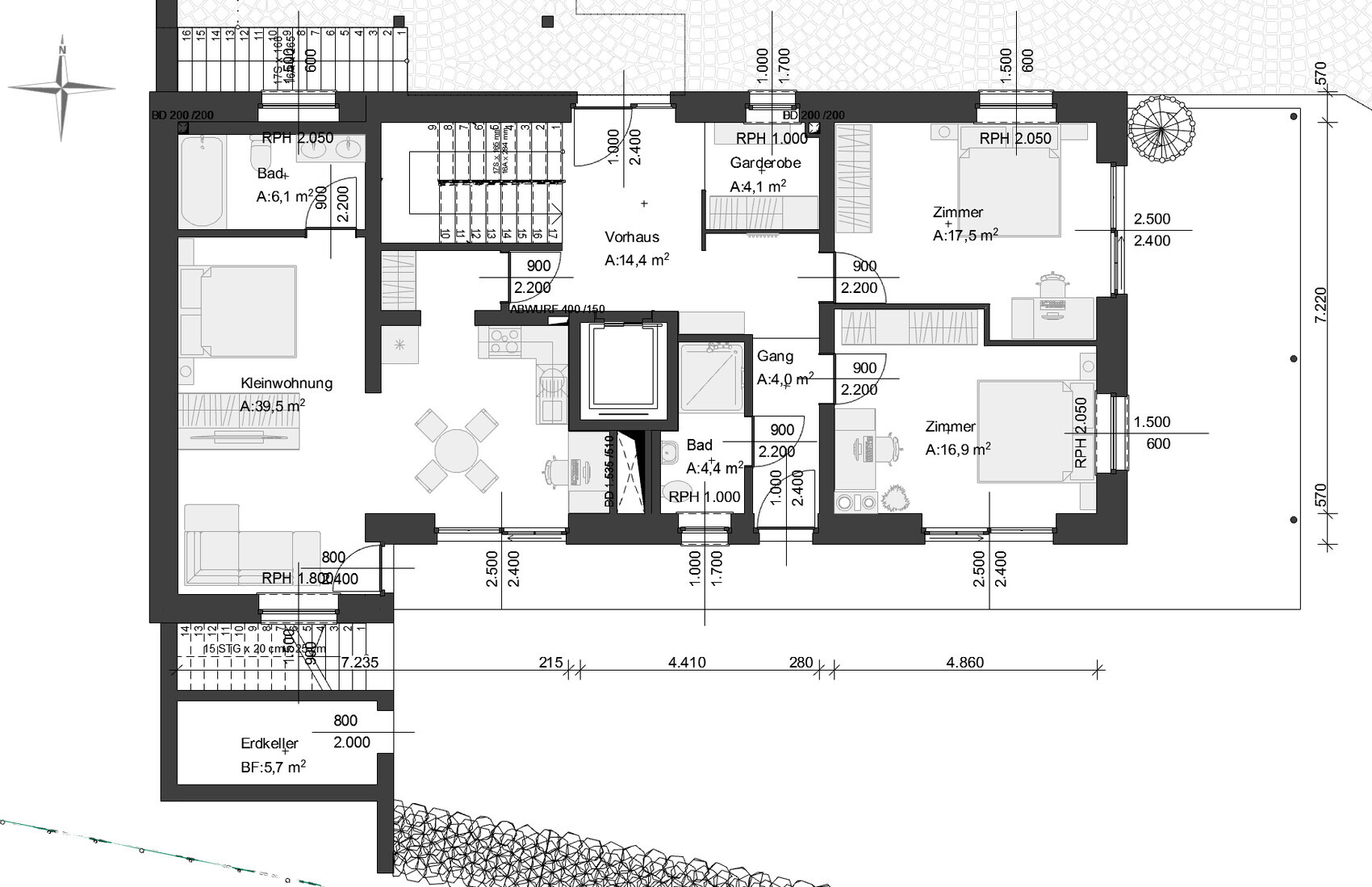

hausbau2021
3 Mar 2020 21:50
Thanks to everyone involved for the input!
I don’t want to shelve the design right away. At least not yet.
So I tried to address the main criticism (too little light in the small apartment) somewhat. By relocating the staircase, an additional window facing south is now possible. A light well on the west side is also conceivable, but I haven’t included it in the drawings yet.
After reviewing everything again, I would prefer to place the living areas including access to the plot on the south/west side.
I’m aware that a south-west orientation would generally be advantageous. However, most neighboring houses deviate from this and are primarily oriented to the north or northeast. I believe there’s a good reason for that.
The reality – and I’m not referring to the Austrian word for property here – is the decisive factor that you can cheat in a 3D program but not with sunlight.
The current renderings are without any trickery.
Between Berlin and Potsdam, a Transrapid is not worth it.
That comparison flatters my elevator shaft. Though it would probably have a brighter future than the Transrapid.
